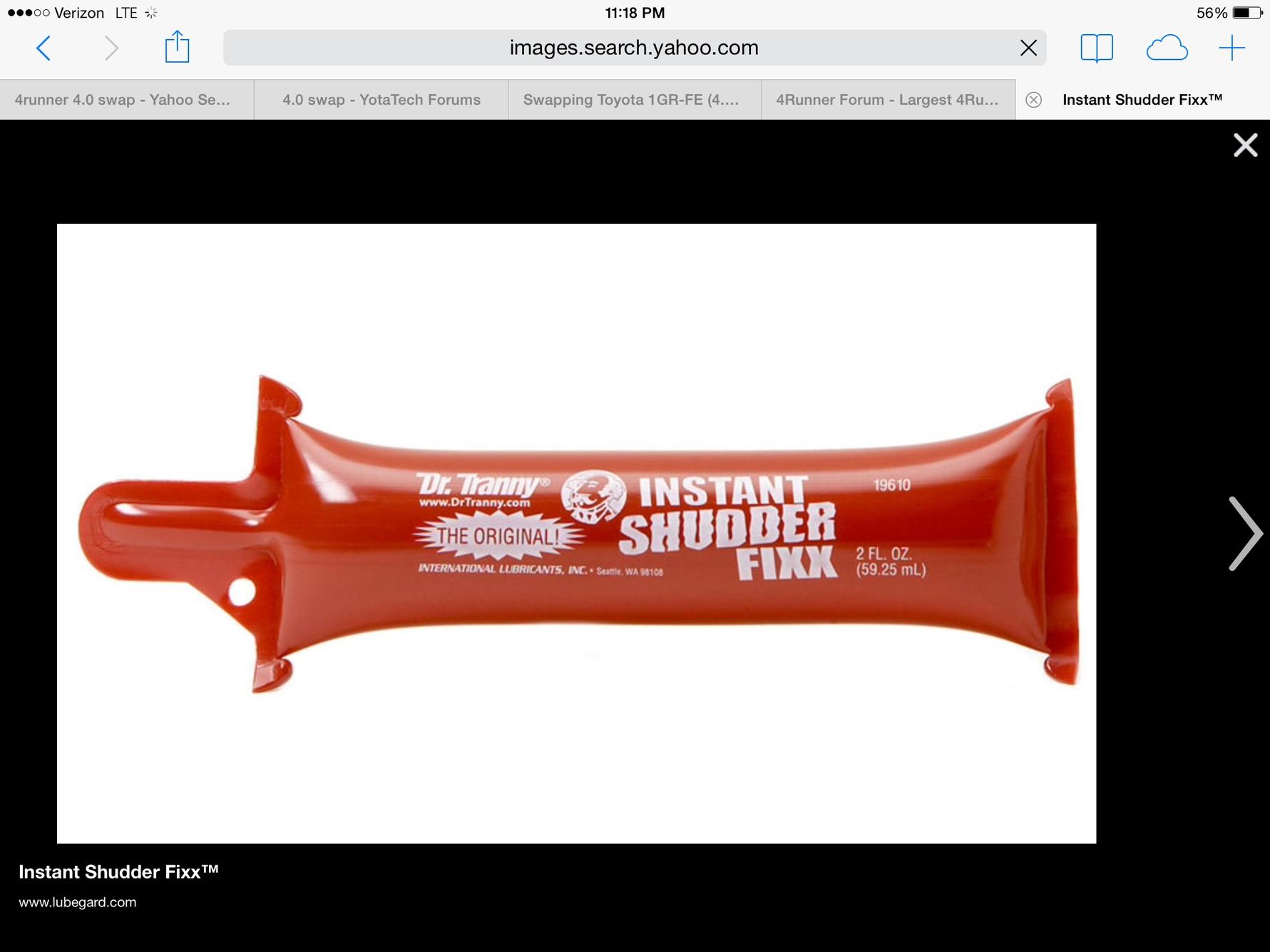

Try this stuff. Less that $20. At o'reillys. Mine took 2 tubes. No more rumble strip and I didn't do a flush..
Type IV & WS ATF are not compatible. Toyota specifically mentions to technicians that any sign of contamination (they say even a few capfuls is too much) should be met with a complete fluid flush to make sure only the proper fluid is in the vehicle.
Try a good solid flush (drain and fill 3-4 times with about 12qts or more of fresh fluid) with what ATF Toyota specifies for your vehicle (Dipstick transmissions take Type IV, Sealed Units are WS ATF.)
You could also try that additive that was mentioned, but I would just do the flush for now and see where that takes you.
