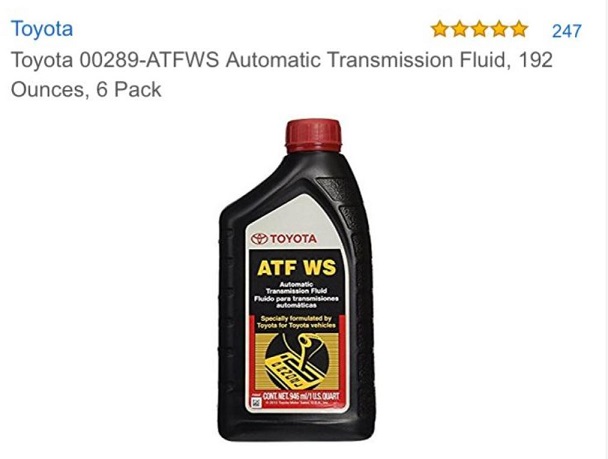

Btw I am pretty sure the fluid in that Amazon link (pictured below) is NOT the correct Toyota ATF for 3rd gen 4runner. That is for newer Toyota transmissions. The plastic bottles look different and it should be a different part number.
Not Correct:

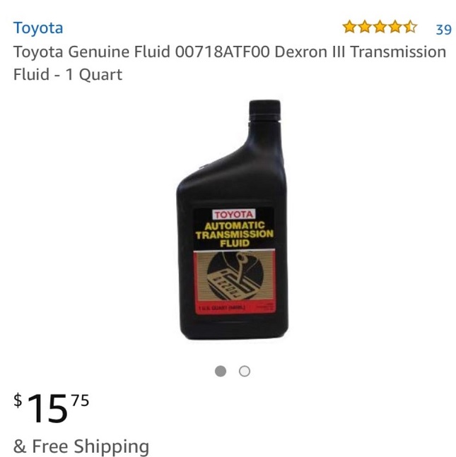

This is the correct Toyota OEM ATF for our years.
The price is high. I would buy it from Camelback instead. Use the 3% discount code and enjoy the tax free purchase. Combine with some other parts to get high enough for free shipping.
https://www.amazon.com/Toyota-Genuine-00718ATF00-Dexron-Transmission/dp/B004SL5FM0/
Even at $11 a quart(am I right?), that's still very pricey. At that point you are pushing into Redline D4 and Amsoil territory. And frankly I think that all of the major lubricant companies are capable of producing a Dexron 3 ATF. It's such a basic and universal spec for damn near every 90's vehicle in some way.

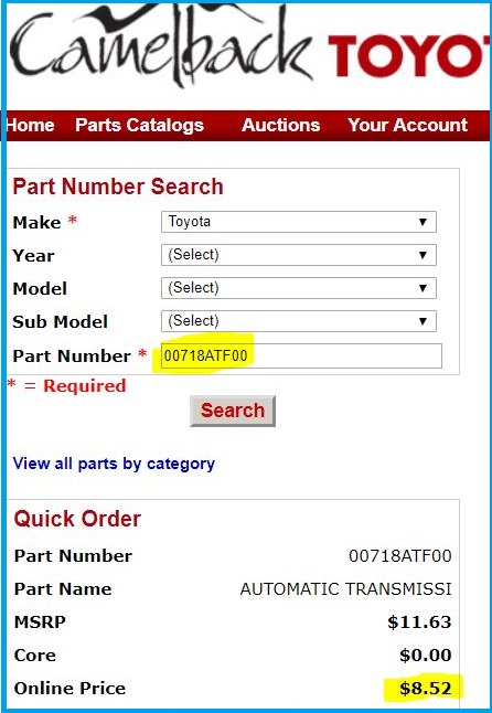

BTW, Camelback has it at < $9 / bottle and no tax. Shipping FedEx ground only $10 to California, free if you spend more on Camelback's site.

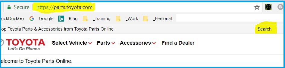

Also, this site is pretty awesome. Parts.Toyota.com simply click the search icon and paste in an OEM part number. Enter your zip code and look at competitive Toyota parts prices from local dealers. These are the dealers that want to play ball. It seems to work pretty well, at least for ATF.
--> https://parts.toyota.com/p/AUTOMATIC-TRANSMISSI/69278804/00718ATF00.html

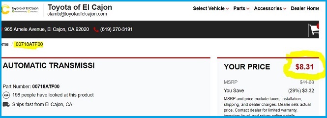

MSRP: $11.63, lists 3 local dealers based on zip and the cheapest is El Cajon for $8.31 local pickup. Not bad!
