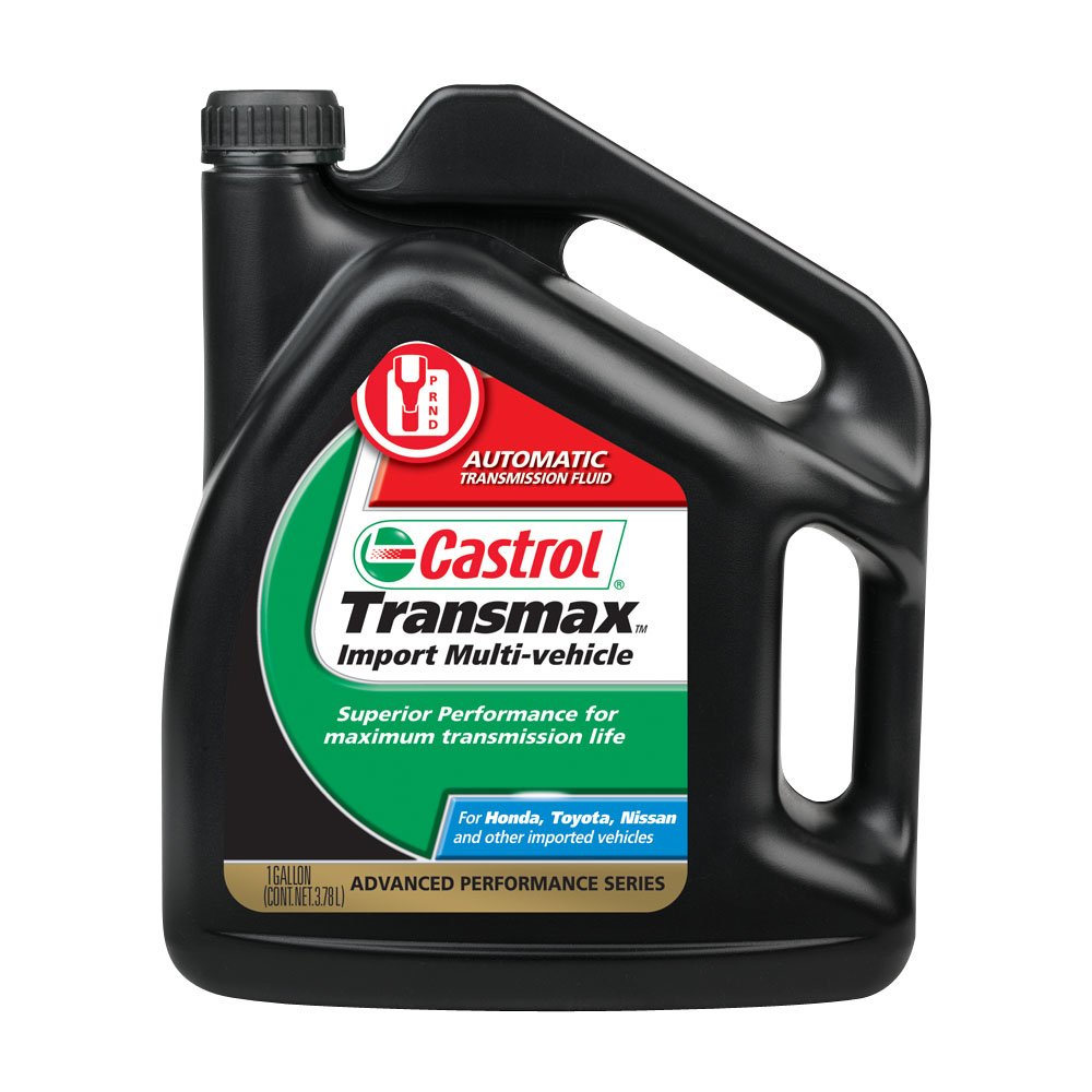

The fluid he used was a Castrol Transmax Dexron III type that Advance sold us. I've attached a photo of the type just for reference.
