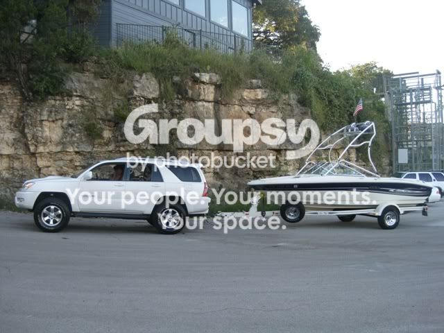

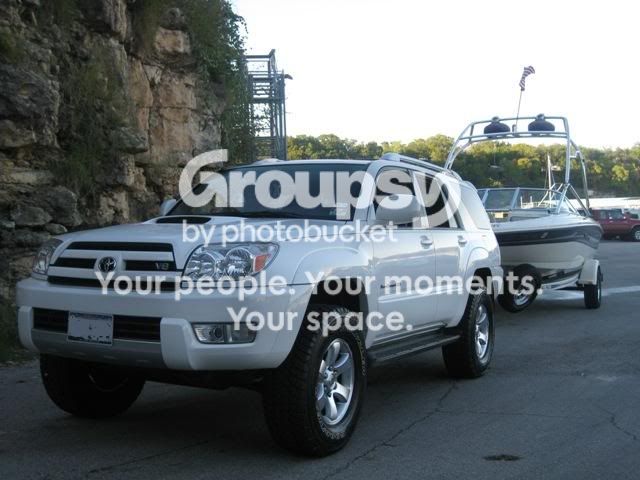

Just for grins, here is the load that I will be towing most of the time. Been towing it since the 4Runner was new. Does a great job!!

Already have Timbrens. The truck is leaning just a bit because it's pointing up hill. It's hard to tell in the pick, but it sits perfectly level on level ground. I've been thinking of adding the air springs anyway, but I've got a truck when I need to haul heavier loads, so they would really just be for fun (like everything else I've added to the 4Runner).
I really like them. They've been on for about 4 years now. They let the back drop about 3/4 inch before they contact and they handle the weight really well. The truck rides level no matter how many people or how much weight is in the back.
I also really like that you don't have to adjust them for the unloaded ride to stay stock. I'd definitely put them on again, especially on an SUV that doesn't usually carry a ton of cargo, or a wide variation of weight (the boat and some gear is usually about as heavy as it gets).
