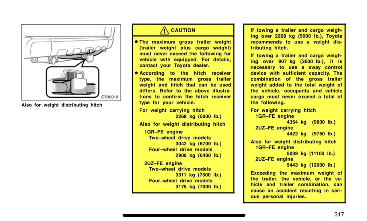

Your towing capacity is 7300 pounds on the 2WD.
I tow a 4200 pound travel trailer around 5 times a year with my 4WD V6 4Runner. I use a weight distribution hitch from Equalizer, I think it's the 6000 pound model.
If I'm lucky I might get 10 mpg on flat ground, I average about 8 mpg normally since I like to keep it at 100 kph or ~60 mph.
Keep your tires inflated and all of the fluids topped up, you should be fine. Make sure your auto transmission fluid has been changed (not flushed). The V8 should have an ATF cooler on it from the factory. I had to buy an aftermarket one from Uhaul.
I'm still on stock XREAS suspension, at some point once it's unusable I'll upgrade to the Eibach lift kit. I'd personally wouldn't tow anything more than 5000 lbs with stock suspension, you need stiffer springs or airbags. I bought some Airlift airbags at the beginning of the year and one of them got a hole in them. I'd recommend the Firestore bags to keep the sag to a minimum while towing.
