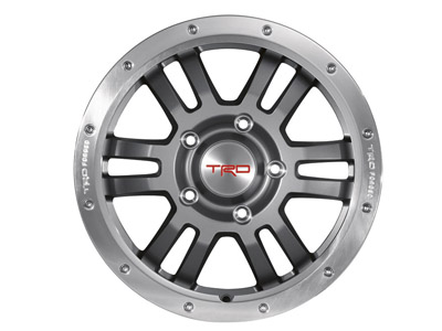

L LCKYLUCIANO New member Dec 29, 2010 #1 Hi to all! I have a question for you guys, do the TRD 17" forged off road wheel will fit the 2006 4x4 sport 4runner? Attachments TRD_ForgedOffRoadWheel_v2_OCr1.jpg 45.5 KB · Views: 6,769
rook New member Dec 30, 2010 #2 That is a 5-lug wheel for Tundra/Sequoias. It will not work on 6-lug 120 platform trucks.
downpour11 New member Dec 31, 2010 #4 these should work though..... ToyotaPartsPeople.com - Genuine Toyota Parts and Toyota Accessories
SCRunner12 New member Dec 31, 2010 #5 You can buy 6 to 5 lug adapters that will allow these to work. It will get pretty expensive if you go this route. They would look sick though.
jlmilligan Member Jan 2, 2011 #6 The new Tacoma TRD off road special edition has similar rims that would work. Or you can get some from the 2010 FJC trail teams edition.
