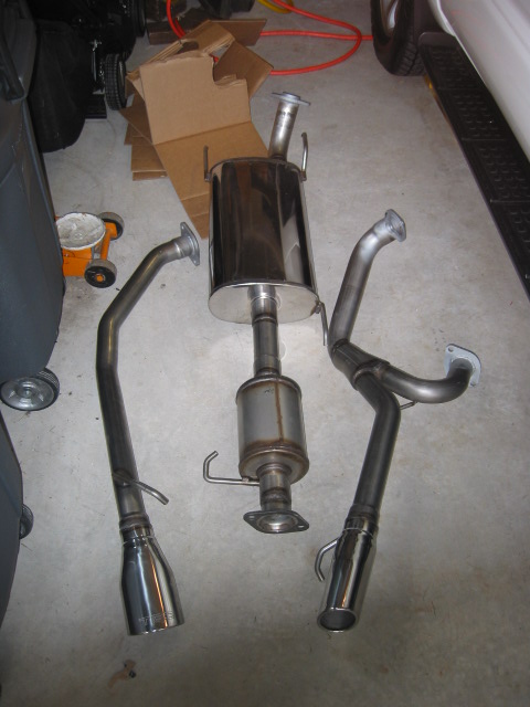

Here's the exhaust out of the box...

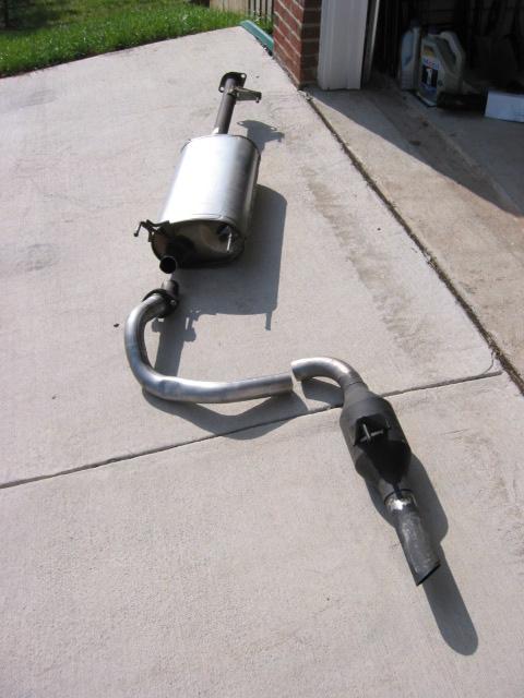

The old system...
Sawzalls work best for those stubborn bolts in the back...;):

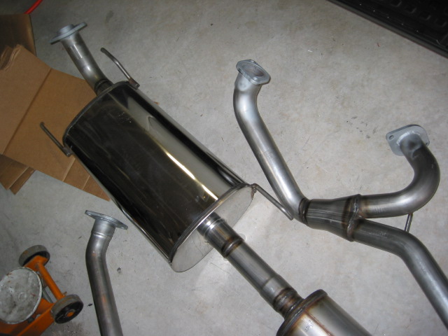

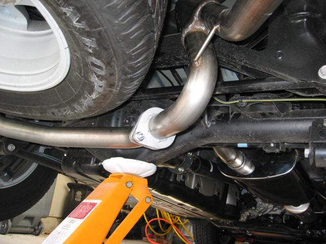

This shows the Y-pipe over the back axle, splitting to the driver's side exhaust...

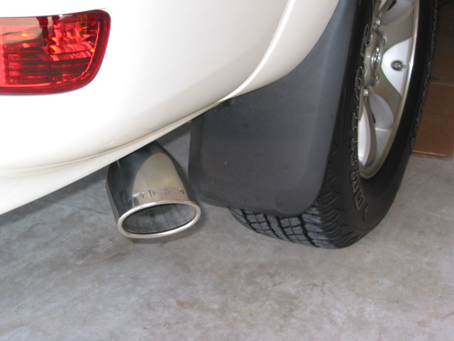

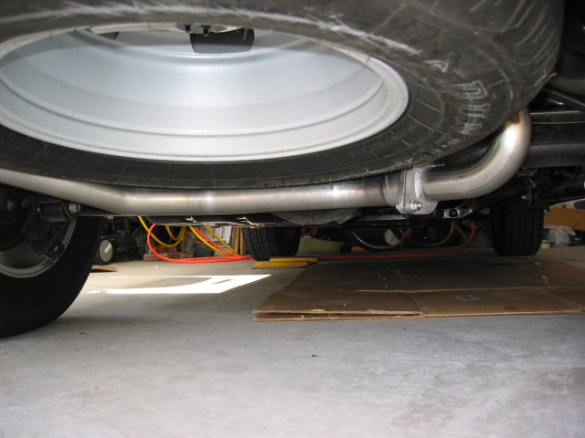

And with the driver's side exhaust attached, a view of the clearance after the install... It doesn't look like any clearance has been lost...
So it looks like the TRD exhaust is NOT the exact same system as the Borla. On my Borla system, there are 2 pipes coming out of the muffler whereas on the TRD the pipes split into 2 after the muffler. I actually removed my Borla system a month ago because I was tired of the 2k drone. It sounds like the TRD might be better in that area. Thanks for the pics!

It reuses the spring bolts from the cat flange, uses 4 new bolt/locking nuts for the Y-pipe, and 1 more bolt got the drivers side hanger attached... That bolt goes into the frame, into an existing welded bolt inside the frame... Just like they planned it... :D
