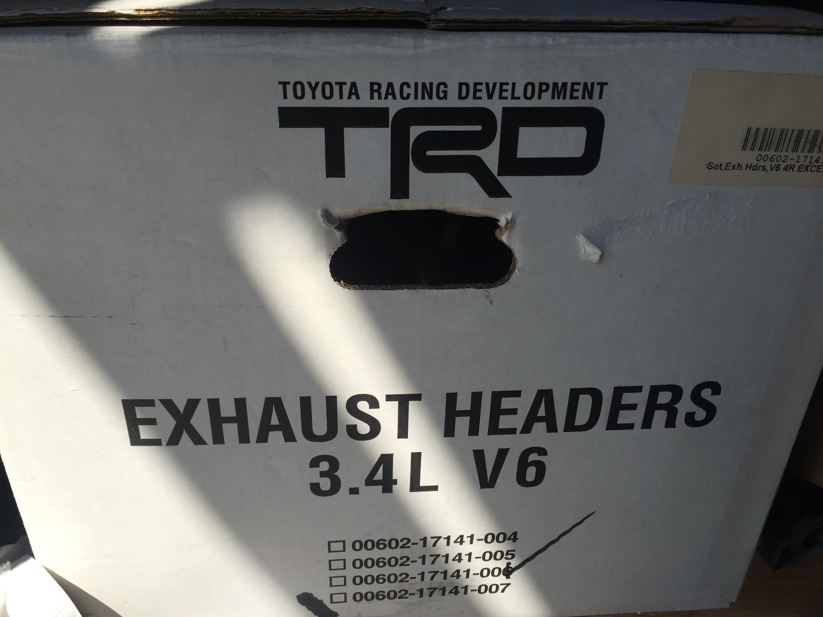

Do you recall what the part number for your headers is?..
Is it any on this box and does your truck have 2 cats?...
