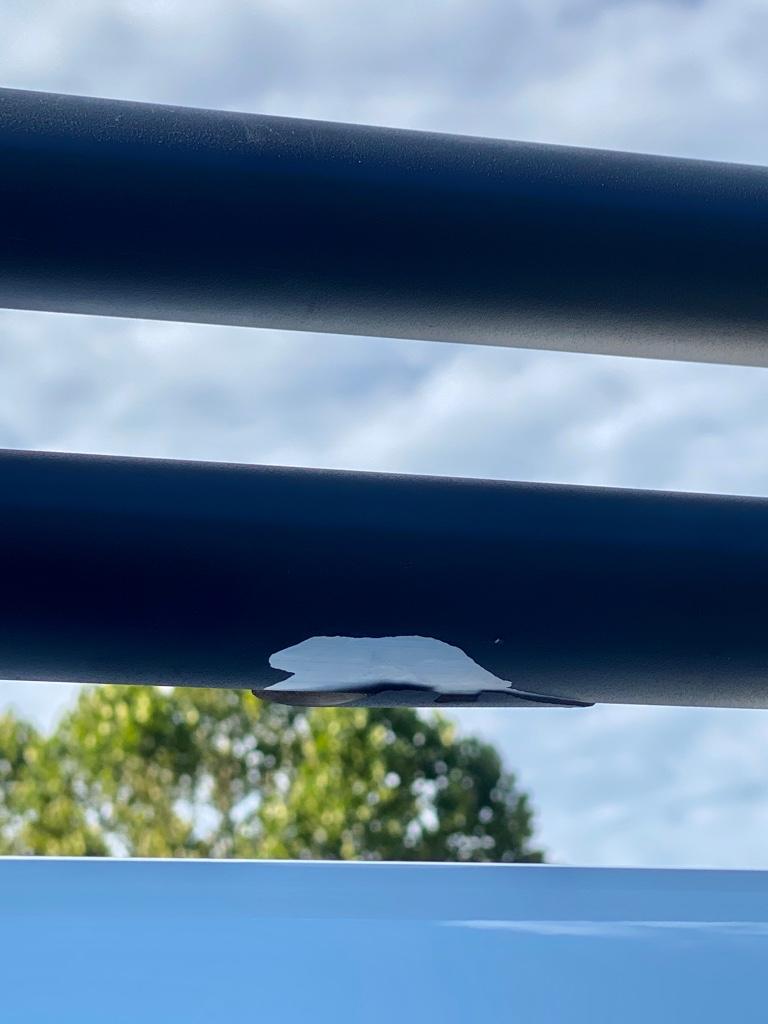

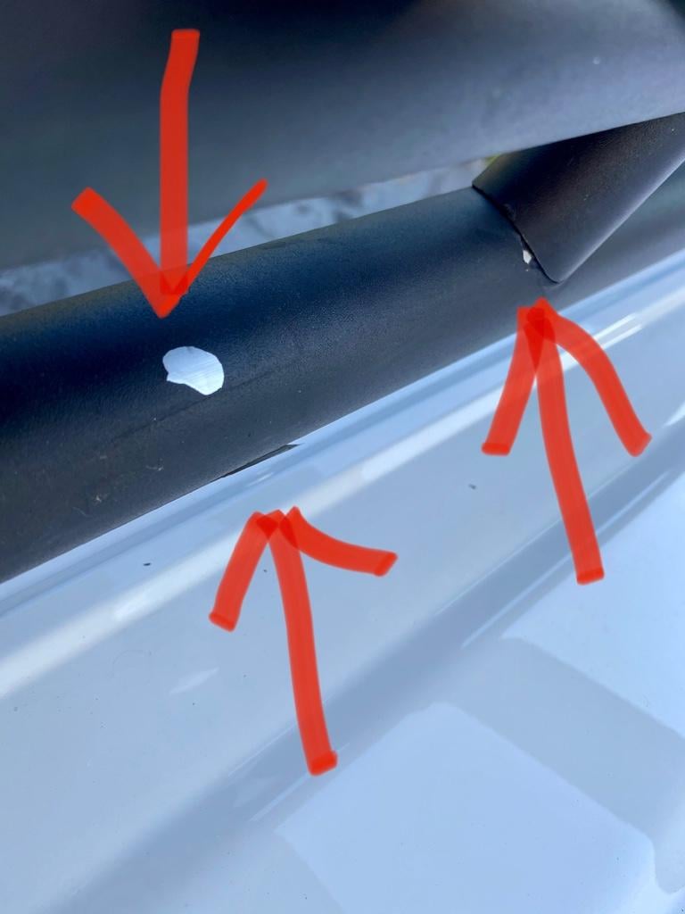

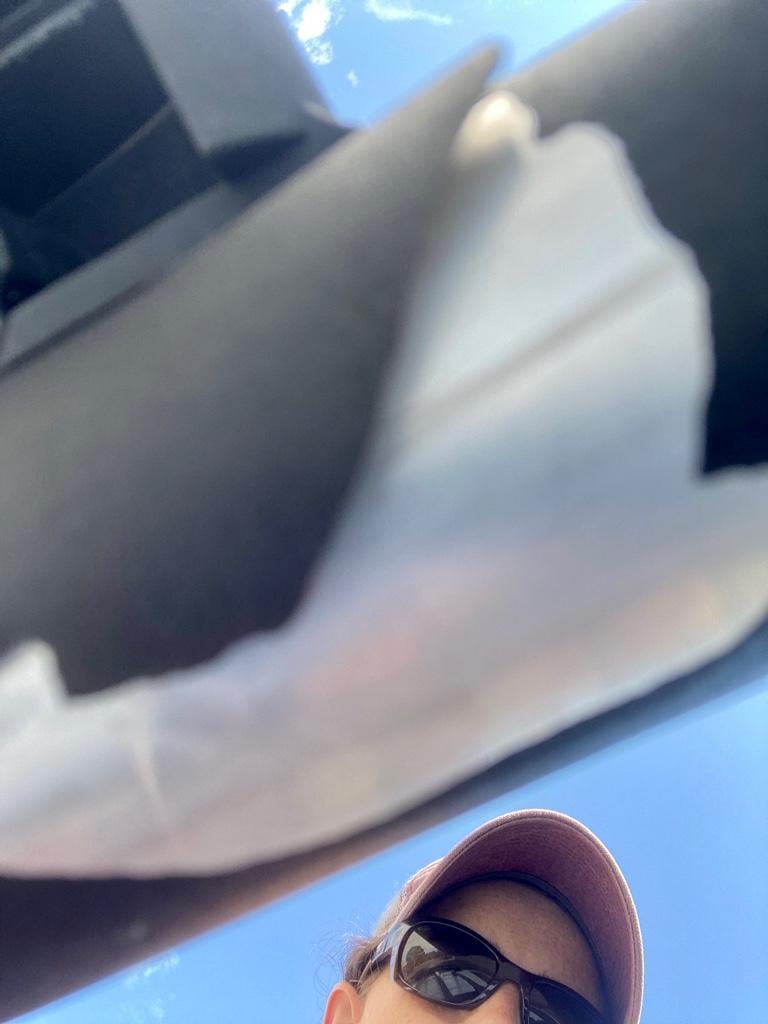

So I went to take my crossbars off of my 2019 TRD Pro today so I could give it a full detail and the coating came off of the rack when I unscrewed the clamp, and then I started looking around and it’s coming off in another place too.
Anyone else’s Pro rack doing this?
Pics below.
I will take it in on Monday because I didn’t want to stop my detailing job for this dumb warranty claim and keep the thread updated.
Honestly, it doesn’t really surprise me that they aren’t actually powder coated. It looks to be aluminum under. I’m not mad about this because I know I will get another rack through warranty, just annoyed.
Also, not that it really matters, but in case you are wondering, my car is garage kept other than when I’m at work.
Well, who else is checking their racks now!?! Haha
