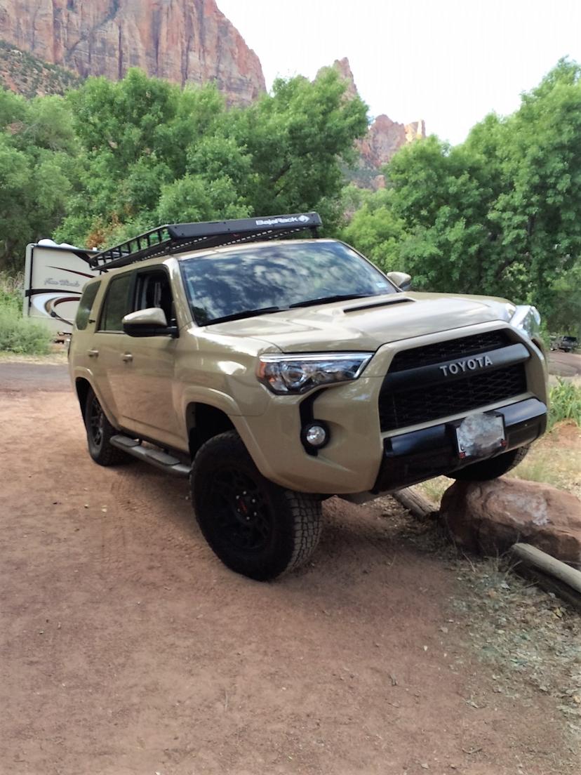

TRD Pro
Gobi rack finished
Waiting on the Spec Ops - Bug out LED Light bar.
a>~original
Playing around with some lights o the side of the vehicle.
Found these mounts on Amazon. click here
a>~original
here they are installed
a>~original
Here I added a small LED light I grabbed from Amazon - looking for something very low profile and narrow. Click here
a>~original
Added some film below the wind reflector on the gobi rack since I read here it was a good idea.
I also added some behind the ladder in case your feet hit the tail gate using the ladder.
This is before i stuck it -its clear...
a>~original

Mounted My Hi-Lift on my Rack
I used 2 brackets that I found on Amazon. I used the same to mount a few side lights.
a>~original
https://www.amazon.com/gp/product/B01FETT3FO/ref=oh_aui_detailpage_o01_s00?ie=UTF8&psc=1
They are aluminum so it was easy to drill out the holes to 7/16 for the bolts.
I stopped and left about 1/16 of the smaller hole. This allowed me to Thread the 7/16 bolt into the bracket to hold it in place.
a>~original
I used a rubber washer below and a flat washer on top of the jack. There is some flex if you grab it but it will not go anywhere.
<a href="http://s1053.photobucket.com/user/markscelza/media/high%20lift%202_zpsf0bapz40.jpg.html" target="_blank"><img src="http://i1053.photobucket.com/albums/s475/markscelza/high%20lift%202_zpsf0bapz40.jpg" border="0" alt=" photo high lift 2_zpsf0bapz40.jpg"/></a>
For now I have if locked with a black gun lock ( i have a box of these). I will fabricate a way to use one of the locks that "learns" my ignition key so I don't have to carry extra keys.
