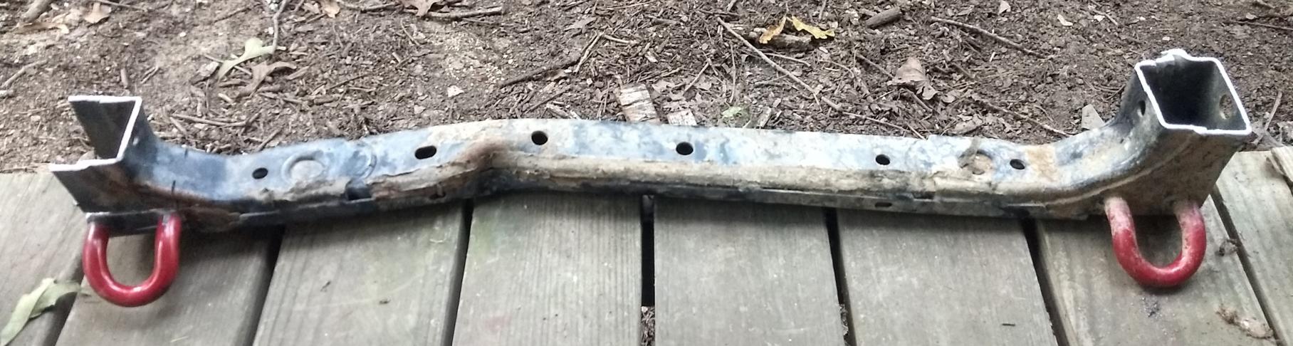

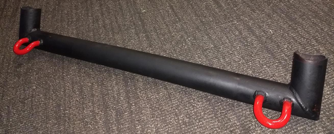

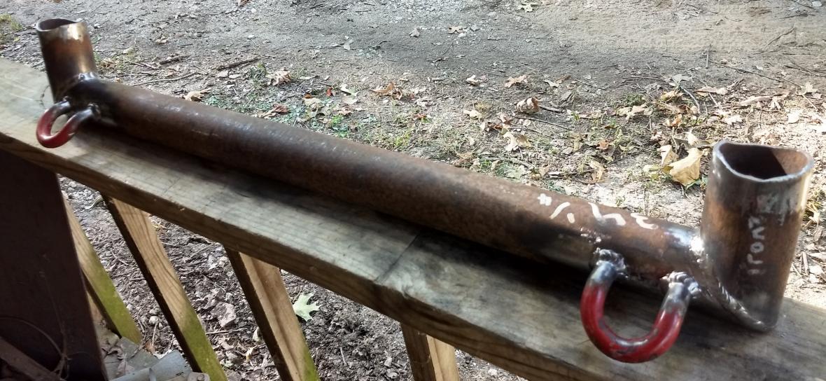

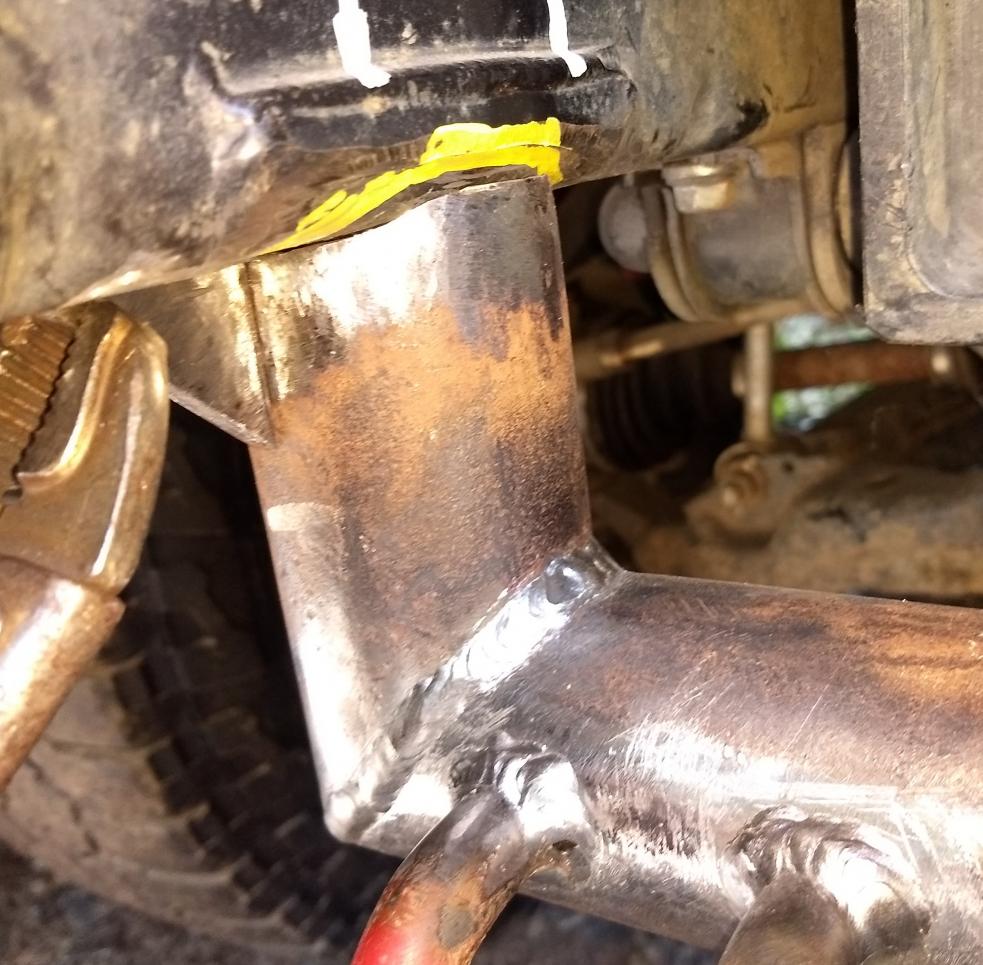

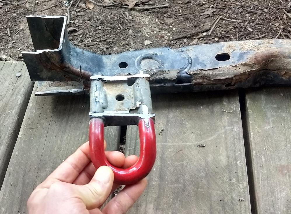

Yeah let's see a picture.. I ripped all that plastic trash out after building my own bumper. I have complete protection from underneath with the OEM SR5 skid.
I know the piece you mean, but the limited has a plastic section that bolts from the metal rad bar to the front plastic spoiler rear. The front section is plastic to plastic. Its only the rear connection that is plastic to metal. I have the plastic sandwhich piece that fits in there sitting in my garage. Now theres a gap as it doesnt fit right with the RCI skid plate. There is no metal under the the front of the limited plastic bumper at the bottom. The metal begins after the gap which is about 6 inches or so. Ill get you a pic if you want to see it.
I also rammed the sh1t out of a stump which destroyed that front cross member we're talking about. So I'm pretty familiar with that area after fabricating and welding in a new cross member at OEM spec dimensions and clearances.
