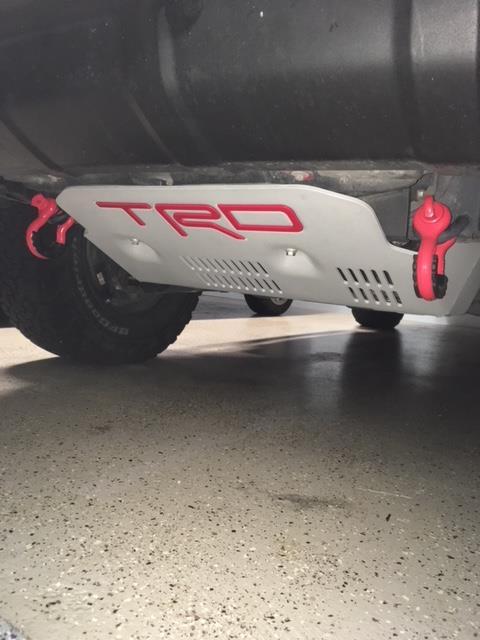

I ordered a PTR60-89190 on ebay and this is how it looks. It came with the red lettering all ready on it. $298.99 shipped.

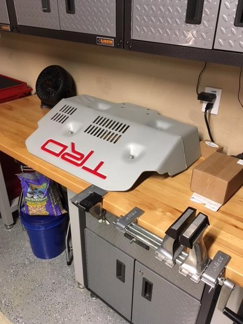

I just installed this and in the included instructions it says not to take off the radiator support arms, just take out the front 4 bolts, leaving the rear 2 bolts. I was skeptical but tried it anyway and it fit like a charm. No issues. I read that the arms had to come off from others, oh well I'm happy.

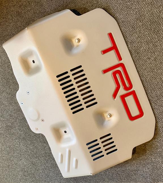

Some info on the 2019 version. Just got one.
1. The TRD logo is smaller. I ordered a Tufskinz insert and is is way to large. Didn’t want the red.
2. The red TRD logo uses snap posts and holes to mount, not tape. So if you think you can just peel it off and it will look like last years, it won’t lots of holes.

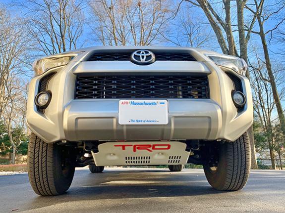

After wanting the stamped TRD skid all summer, wasn't sure about the new Red TRD (plastic insert) but it grew on me fast.
2019 Version from local dealer today, looked up the part number on Toyota Parts Center Online, there is a new number. Stock Code PTR6089190 parts.toyota.com
Simple install, (I ditched the stock plastic cover as per instructions)
Also as Texas_Ranger mentioned and per instructions you leave the support arms on, removing the 4 forward bolts (leaving the 2 at the very back of arms). Fit like a glove.
I used the 4 new supplied bolts (2 are inserted already in front area of skid with spacers) (the back 2 supplied are longer) and did not have to tap those holes out. Parts guy said 14+ you shouldn't have to. (another thread I was reading some said they had to)
The stock bolts that these longer ones replaced were shorter and thinner on the ends but the new ones went in fine with normal wrenching (nothing forced).

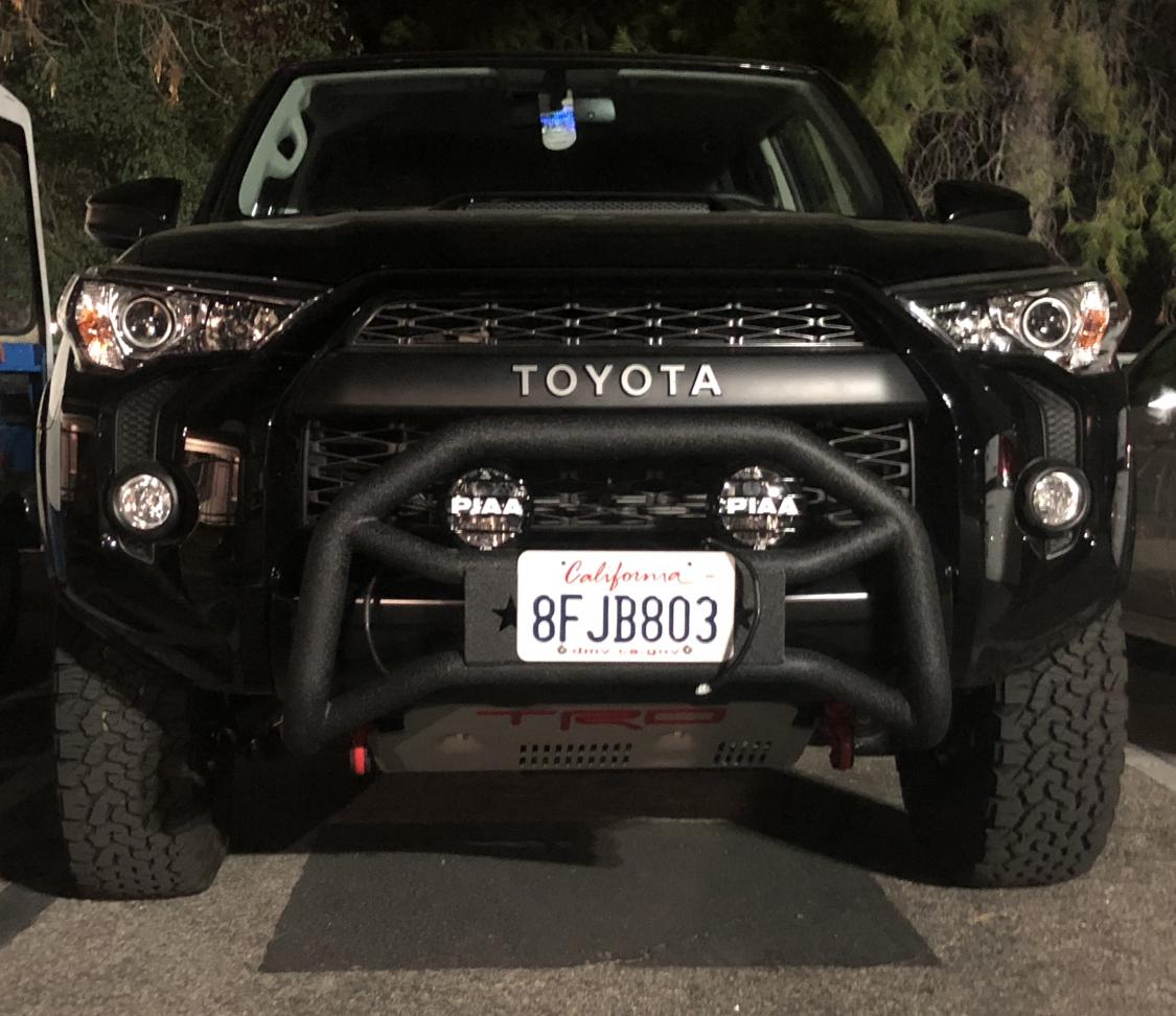

I purchased my 2018 Pro in early September this year and it came with the red inserts. There were no dealer add ons and I don’t think the dealership did it. Maybe the late build 2018’s received the new skid? Anyone else have a 2018 Pro that came with the red inserts?
