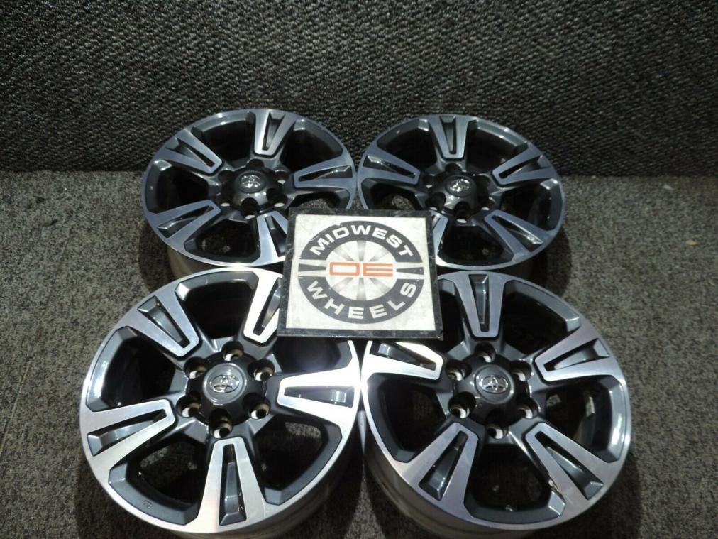

All, I am a complete newb when it comes to alternate wheels, offsets, etc.. and looking for help to be sure I make the correct decision.
I reviewed many pages of the wheels thread(s) and searched google, and still not sure if these wheels will fit my 2008 4Runner SR5. I currently have the OEM 16" six spoke wheels and just added the Daystar 1" front level kit.
I like these Tacoma 17" TRD Sport Wheels which have the same offset, lug pattern as my 16" wheels and would appreciate confirmation that these will fit my SR5.
2018 Toyota Tacoma TRD Sport 17" Factory Aluminum Wheels (fits all 6 Lug Tacoma) Wheel Size: 17X7.5 / Bolt Pattern: 6X139.7mm
Thanks in Advance!

I have these on my 2008 sport. They require 1" wheel spacers to clear my upgraded calipers.
Now, since you have a SR5 you might be able to get away with not needing the spacers.
If you do go with spacers you find out your oem wheel studs are not long enough for the wheel spacers. I had to install Toyota Matrix AWD rear wheel studs.
So will they fit? Yes.
Longer front wheel studs needed in order to run wheel spacers
2003-2006 matrix or pontiac vibe, 55mm long.
AWD matrix 90942-02078
Dorman 610463 from a 2004 Matrix $1.42 each
$34 shipped (qty 20) from Rockauto or $39 amazon
Thanks Randy.
I checked my calipers and it's stamped with 13WG- 12.6"/319mm rotor diameter. If I understand this information, I have the small caliper setup and can fit these wheels with no issue and no spacers needed??

I’ve never personally used spacers but I thought spacers bolted to the stock studs, then had studs of their own that the wheel bolts to?
Thanks Randy.
Yes they will fit without spacers.
