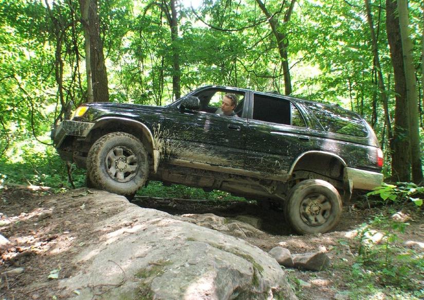

Maybe we could get some front articulation pics to compare.
IMG_3385-Copy.jpg~original
~~~ Via "Ric" With the ToyTecs...
Mine does nothing anywhere close to this.

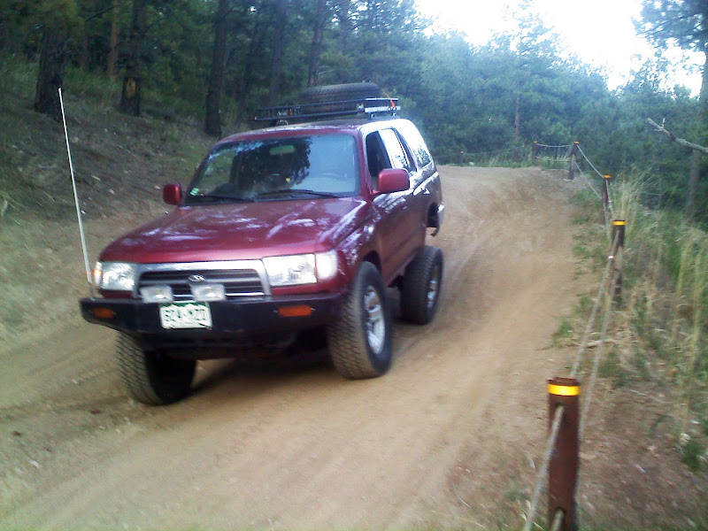

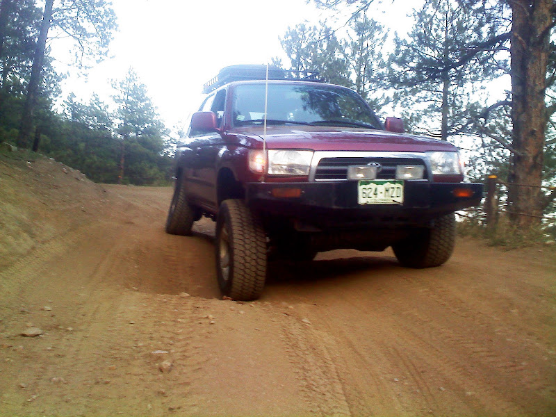

I cant comment on any other lift other than the Toyteclifts coil-over, had them on my 99 and absolutely LOVED them, loved the ride on and off road, flexed great, as you see, Kregg posted a pic I did not have the sway connect.
I loved the ride, the quaility, the flex so much, when I got the 04, within a week, I had the ultimate kit on it, lol
as far as the flex on the 04:
DSC_0021.JPG~original
and yes, the front swaybar is removed, the rear swaybar is still attached.
DSC_0014.jpg~original
This kit works AWSOME for what type of wheeling I do, more rock crawling, daily driving, I dont do high speed stuff.
