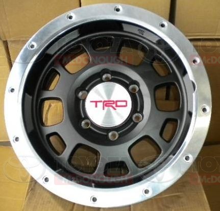

Wheels: FJ Cruiser TRD Bead Lock Wheel - PTR18-35090
(16 x 7.5, 10mm offset with the 6 x 139.7mm lug pattern, 106mm CB)
Tires: 265/75/16
Questions:
1) These wheels are listed for use with FJ or Tacoma and designed for use with 12mm conical-seat spline-drive lug nuts but there are different kits sold for the FJ and Tacoma and none mentioned for T4R. What do I get ? (I believe lug bolts are the same so why different sizes?)
2) Does the 106mm Center Bore match my T4R hub?
3) I am having some trouble trying to compare the 10mm offset of the TRD's with the stock offset as I can't find a consistent value but I think it is 30mm. As I understand "offset," the new wheels/tires will be 20mm nearer the midline of the vehicle. I don't think that will be a rub issue from what I can see but does anyone know different?
I expect to gain ~ an inch of additional sidewall height with this set-up but still be able to fit the spare in its normal location.
(Future plans include a front bumper and OW 2.5 shocks)
Thanks for any info/help, Jon

Yes, these will fit your truck just fine. Same rims I'm rolling :fro:
edit: you will need new lug nuts tho, the ones from the sR5 don't work with these wheels

in reply to the thread... any chance of these fitting on my 98-T4R?
please and thank you in advanced
Shouldn't be an issue, Toyota hasn't really changed the bolt pattern/hub center in almost 20 years for their 6x5.5 as far as I can tell. The offsets are different accross the years (i.e. older T100's have a diff offset than newer Tacomas, which are little different than the 4Runners which are slightly diff than the 1st gen Tundras and Sequioas, bla bla blah) but they'll fit.
