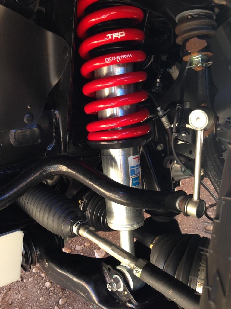

Here's a pic of the TRD front coils. So they are NOT adjustable, right? Think I heard that they are definitely NOT. But just trying to confirm 100%. Seeing that exposed ring is haunting me as if it is.... Hmm.
The guy who works at the FL port (sorry, can't recall his name) said they are definitely not adjustable, but if they come with the springs installed on the shock, then I'm not sure how they can say that with such certainty. I think we will know a lot more when someone is willing to take them apart....or use a spring compressor to try to adjust the bottom perch. If you shine a flashlight inside of the bottom spring area do you see another line above the bottom black perch? If they are adjustable I doubt Toyota would advertise that fact. I'm not saying they are adjustable, but rather I'm not 100% convinced they are not.
Oh Yes....JM4Runner! Not doubting him by ANY means as he's on the front lines BUT... Why would that ring be there? I just wanna know! JM? Any ideas?
That definately looks like a "spring seat position for ride height adjustment" to me on that TRD/bilstein.
Appears they are set to the .85" position.
The exposed one you can see would be the "0" position , if they are like the 5100's in design.
The question is, is there another spring seat position above the current setting?
They may have been made with only 2 possible positions..... Someone is going to have to chime in that can give a definate answer on that one!
Maybe [MENTION=111615]JM4Runner[/MENTION] can let us know how many spring seat positions are on these.
