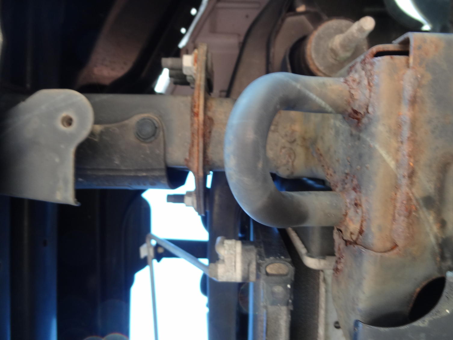

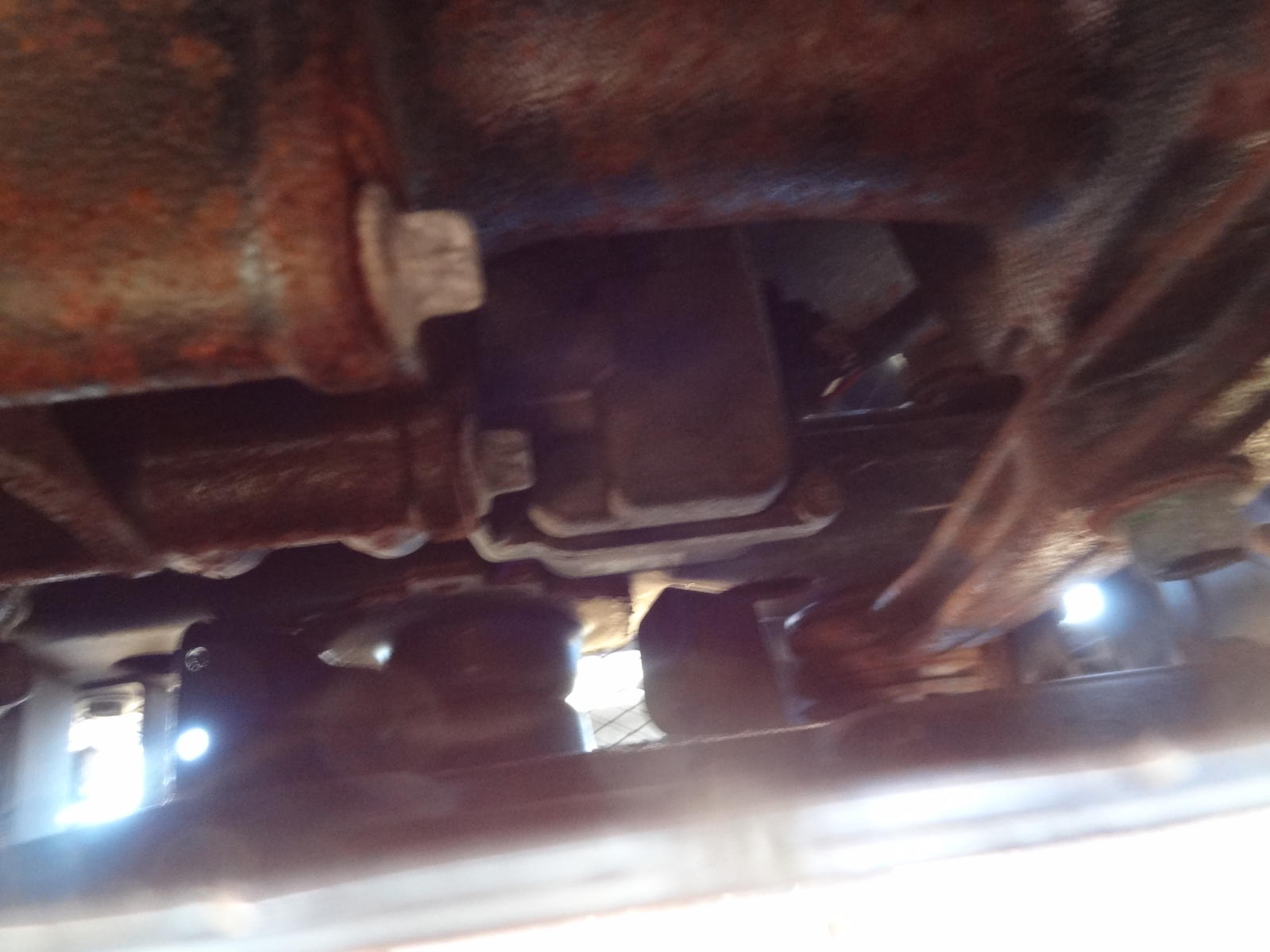

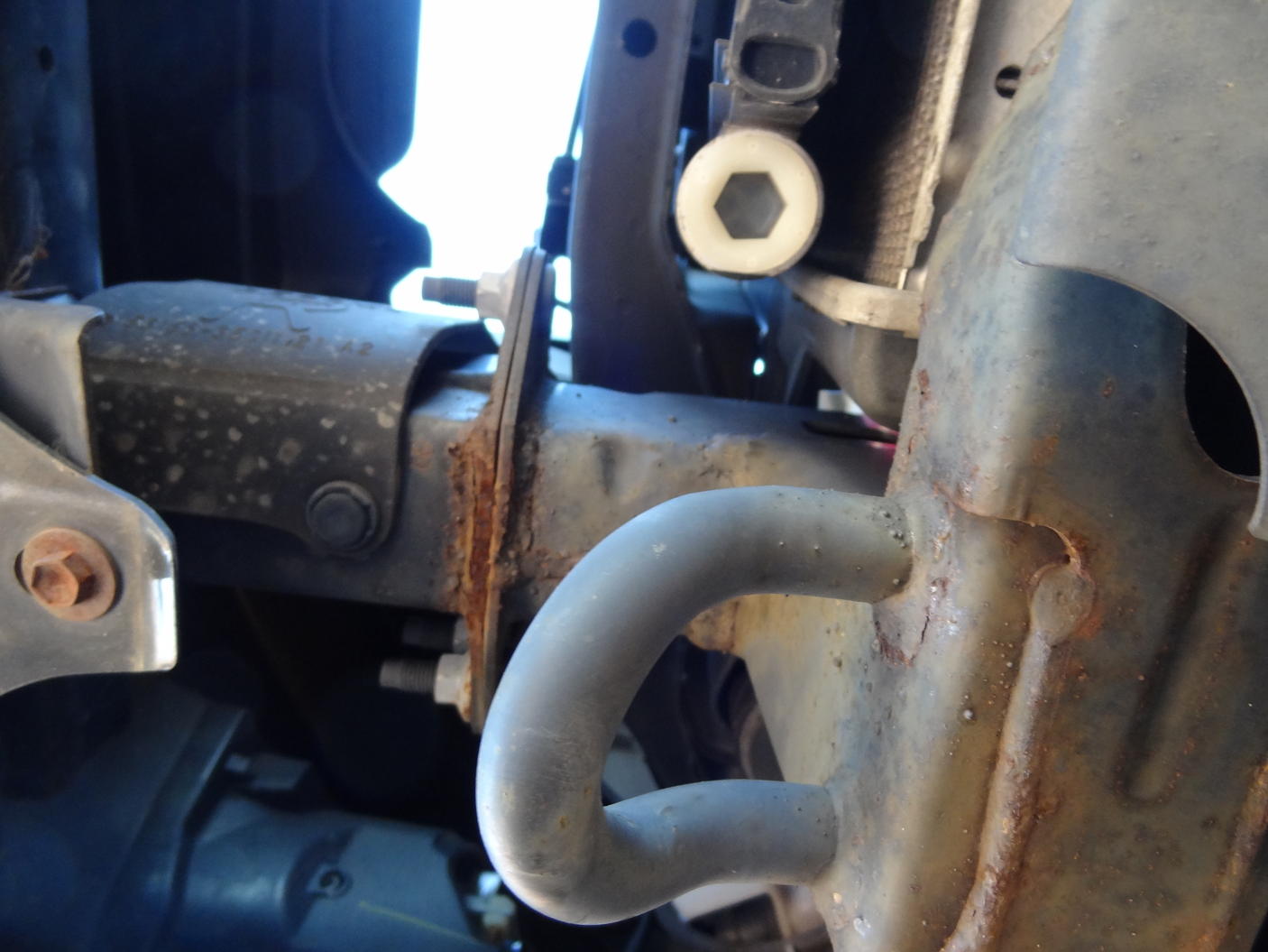

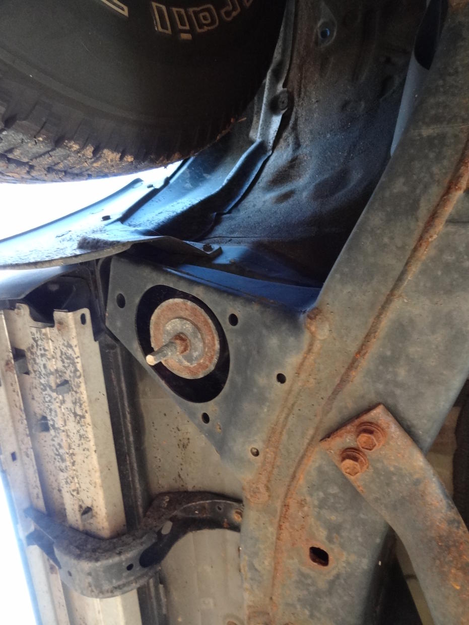

Hello everyone! New user here and 1st post. I'm wondering if anyone has any suggestions on how to handle/treat the rust shown in the photos. These are taken under my 2006 SR5.

Looks pretty minor. Any place that gets snow will cause car underbodys to rust like that.
As mentioned above, a wire brush should knock off most of that rust and a rust preventing primer and enamel will slow/stop the oxidation.
