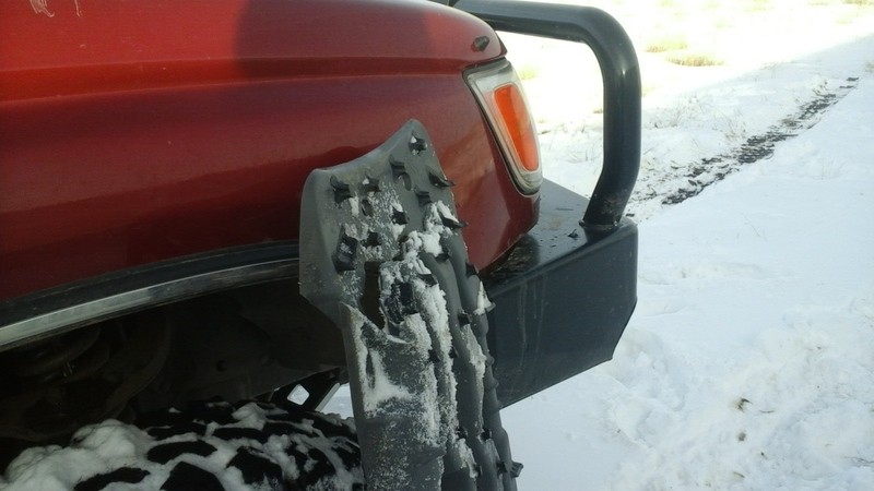

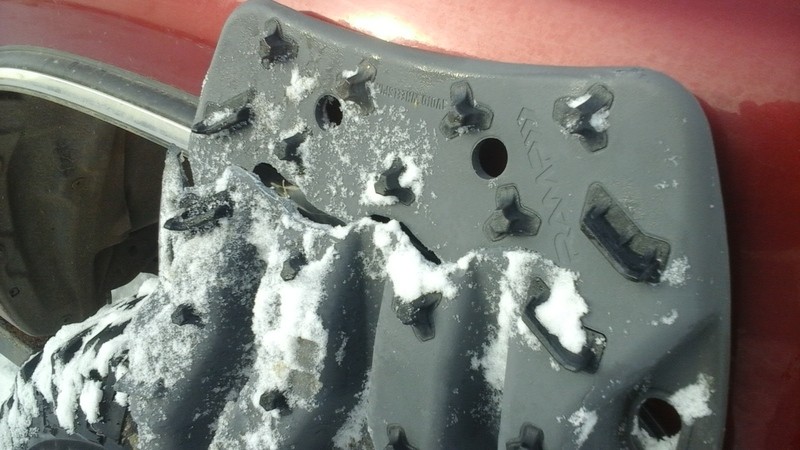

Ok so I tested out the Tred Pros and took a bunch of pictures but I'm having trouble uploading them except the ones I took after . First I found a snow drift about 3 feet deep and drove into it until I got stuck . Throw down the Treds and backed right out . All right ,that was too easy . Found a steep bank probably about 50-60 degrees and 4 foot tall , mix of loose dirt and snow and laid them on it and climbed up with very little spinning . Excellent traction and no damage from the spinning but it was hardly any . I did have the rear locker engaged . Next up was a 16 inch log . I laid one down leaving the middle unsupported and drove on up . I stopped about halfway up to see how much it was flexing and it was a 2-3 inch bow . I laid the 2nd Tred on the other side of the log and went up and over with the front axle of the 4Runner . I drove forward a little and stopped and made sure the rear tire was lined up and drove on up and came crashing down the other side . I got out and looked and sure enough , I broke the end of the 2nd Tred . I'm pretty sure what happened was the 2nd Tred slid forward a little when the front tire went over and it was barely sitting on the log when the rear tire hit it . I should've checked when I lined up the rear but I forgot to . So yes I broke one but I think it was my fault . I've never used the maxtraxs but I would not expect any plastic ramp to support a vehicle with only a couple of inches of bearing . Temperature was high 20's . It might have survived on a warmer day . Now we'll see how TREDs customer service is .

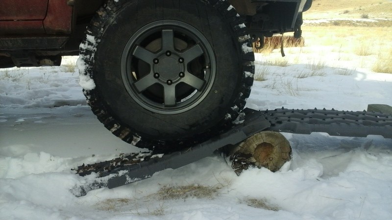

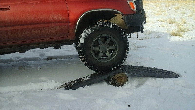

Yeah , sorta . I was just messing around on my property seeing what these treds would do and was thinking this could be a quicker way of crossing a log across the trail , compered to cutting it up or winching it to the side . I've done both in the past . I set up a couple of pictures to show what I did . I'm home ,bored waiting for the weather to get better to go back to work . Using a smaller log than before I set it up the same way . See how the 2nd tred is barely on the log ? I think this is what happened .
Gotcha, glad to see that they hold the weight of the truck like that though. I had wondered if they would hold up to that or just crack in the middle. Sorry I didn't respond sooner, I forgot about this thread and just remembered I posted in here.
