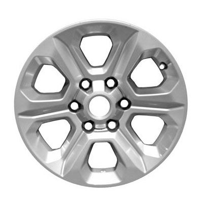

3rd Issue: Wheels to small (need a bit more clearance)
Question: I would like to go a bit bigger 285/70/17 but I'm running the TRD pro rims that are 7" wide, specs say 7.5 is minimum for the 285's. I have loved my Generals and want to go with the x3's but am I really screwed to run smaller tires with that width? or do I have to go even bigger and run 255/80/17's?

3. 285's should be fine on your wheels. It's not ideal - but I would just run them. Alternatively Trail wheels are pretty cheap used and better in a number of ways. Better offset for larger tires and less rubbing. They also have a protected valve stem. Depending on your trails, that can be important. One of the wagons on my Rubicon run ripped a valve stem out - in the water - so I have no idea what caught it. My wheels have big scrapes right across the stem area into the aluminum. (They got chewed up pretty good). The trail wheels are actually pretty close to having rock rings by design. I'd pick up a set if you have room for 2 sets of wheels/tires and keep street tires on the TRD Pro wheels. I have Limited wheels for street driving with 33" tires on them. Also FWIW - I've run P rated 285s and have had one flat in 30k miles including a lot of Moab and the Rubicon. I'm sure there's some trail somewhere that is made of razor sharp shale and P rated tires wouldn't work - but for me they've been pretty darn durable. If you're using them as a daily diver tire too - p rated tires can be a good option to keep weight down. I would NOT buy Toyo AT2s. I have them. They're terrible to balance and make crappy street tires. They make pretty good offroad tires. Obviously if you want MTs then there are pretty much only E rated LTs.
Another size to consider - although it's $$ is 34x10.5x17. That's pretty close to a 255 80 17 - same height at 33.5" and about 1" wider, and probably fits better in some ways than a 285 70 17. I have 275 60 20's as street tires - and they're almost identical to the 34x10.5x17 except only 33.1 vs 33.5 height - same width. They rub slightly on uncut bumper. No rub on the body mount.

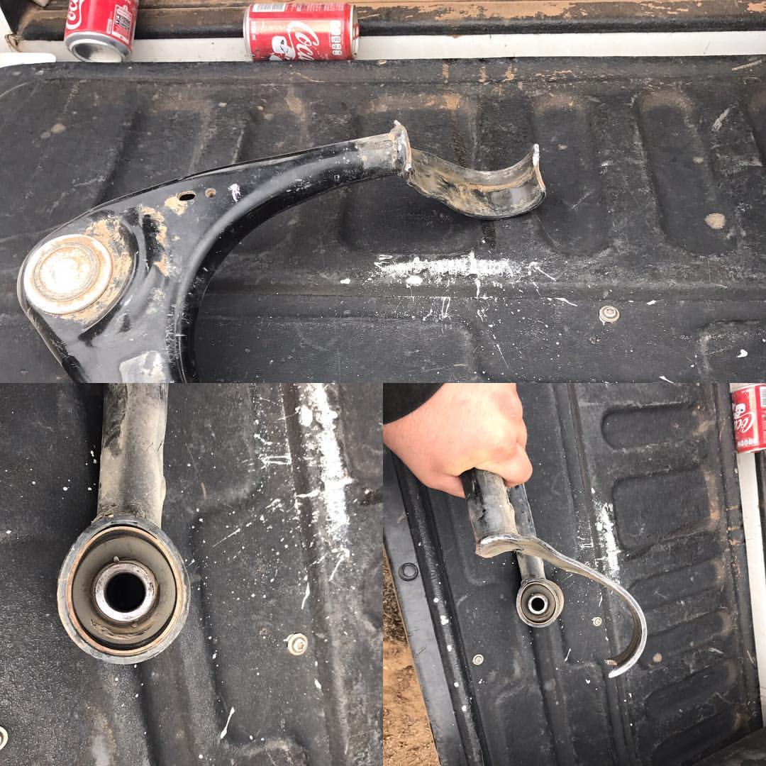

4. I would go with ball joint UCAs. Uniballs may be stronger - but the UCA has minimal loading by design. Even the OEM UCAs will not fail at the ball joint. They will tear the weld out on the bushings before the ball joint fails from an impact. If the ball joint breaks its a result of flexing it outside of its range and the cam motion at the limit prying the ball free of the socket. Aftermarket UCAs with ball joints should solve that problem. For me - I would not use uniball UCAs again. Sealed Ball joints are better for this application IMO. Mostly for maintenance reasons.
- the pic below is from a 200 series that had about 15,000 SCORE series race miles when it broke. In stock full class you have to run OEM control arms. The ball joint isn't the weak link.

I have TRD PRO rims with KO2 in a 285/70 and they recommend no smaller than a 7 wide rim. I have aired down to about 10-12 psi to see if the bead would pop and it didn't although I didn't go super hard.

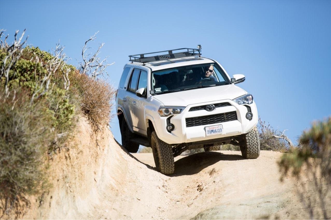

I attached a pic of my 4runner with coilovers and I get plenty of front end clearance. It's a bit high for me but will settle with a front bumper.

I still have my stockers which I actually was planning on running as a trail wheel and those are 7.5 so that will help (I had forgotten that)
