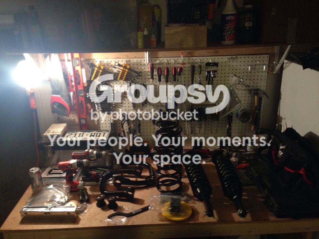

The plan for it is a daily driver with moderate wheeling and expedition adventures here in Colorado. So I purchased icon ext travel coilovers, icon tubular UCA's, superflex medium rear springs, and icon 2.5 remote resi shocks with the cdc adjust. Also toytec ext brake lines and bumpstops as well as a rear 1/4 spacer to fix the drivers side lean.
Parts collected on my bench ready to go in.

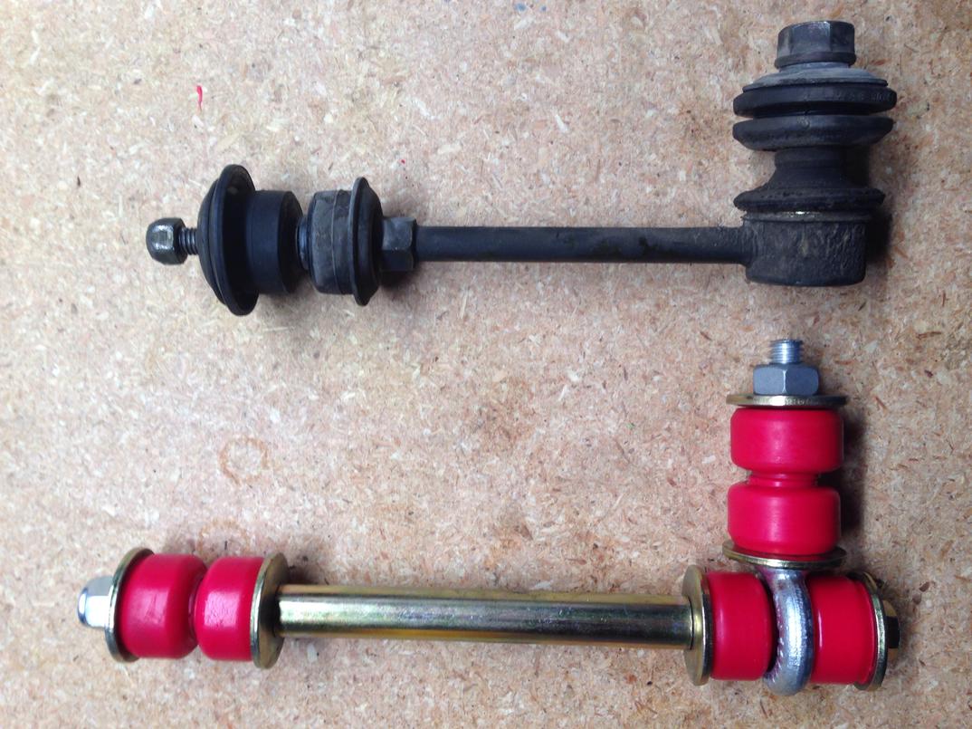

Got all the suspension installed and decided to build some cheap extended rear end links. Soon I'll replace them with a nicer pair of disconnects made by [MENTION=98153]MStudt[/MENTION]

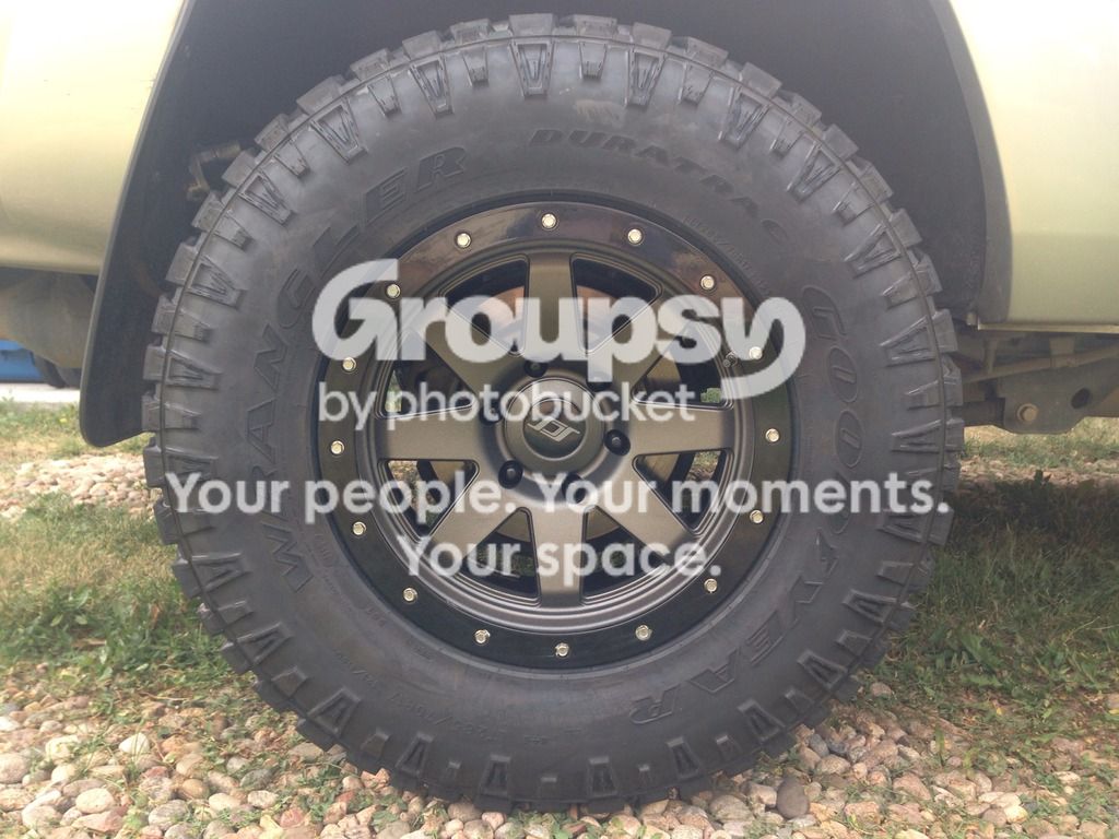

Ordered up some SCS SR8 wheels in gunmetal and 285/70/17 duratracts. Got them installed and they look incredible IMO. Loving the new look of my truck!
Its now slightly higher in the front, making it a little more level with about 1.5" rake in the rear.
I moved the fender liners forward and did some trimming as well as cranked up the coilovers slightly. No rubbing except slightly on the body mount. Although I haven't flexed it out either. I need to play with it and possibly do more with the liners once I get it flexing.
The icon coilovers come pre set at 2.5" lift and I got about 3.25" lift probably due to sagging original suspension. I cranked the coilovers up 1/2" which is 2 full turns on the collar. Question is, anyone with coilovers specifically icons does adjusting them that little affect the ride? It seems a little stiffer and harsher but that could be the new tires not necessarily the small adjustment to the coilovers?

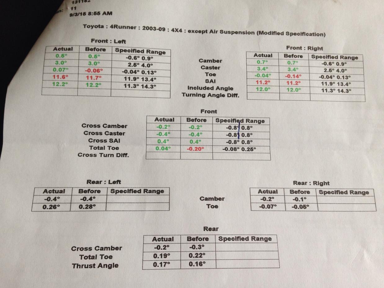

Got it aligned and was surprised/disappointed with how little was done. Everything was in spec except for the toe. So all they touched was the toe even though I asked them to add a little more caster. Max caster is 4* I have 3* driver and 3.4* passenger side. Will getting just slightly closer to 4 make any difference?

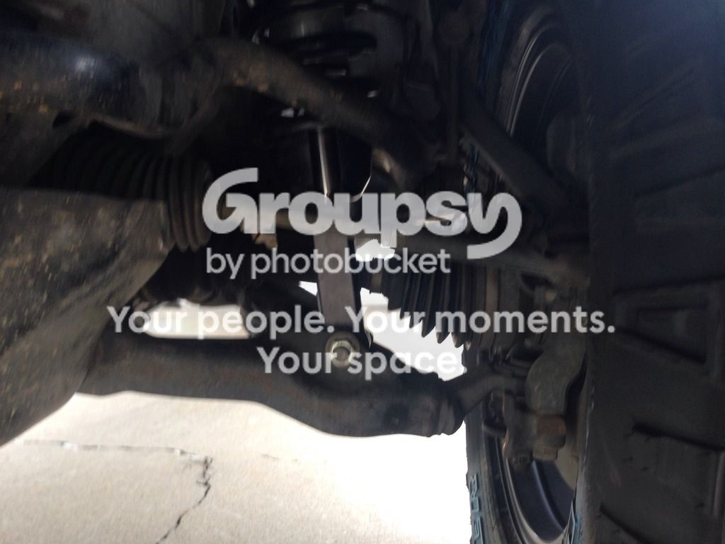

How do my CV joints look?
Ditch the lower bushings on those! It'll do more harm than good the way you currently have it. So many people build them that way, and that's not a good way to build them. I'd either remove the bushings on the lower end of the link, or remove them from the eye-bolt.
Then how would you attach it and have it not moving all around without the bushings? The bushings keep it in place, I can't picture how else to do it?
If you take the bushings off of the eye-bolt it'll mount the exact same way. You'll just need to space it out. Instead of using the bushings as spacers you'll use an extra nut. You're going to get a ton of unwanted/needed movement with those bushings.
I see. I'll fix that.
