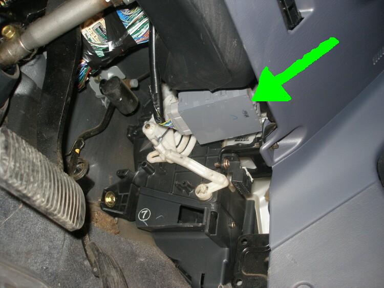

I have disabled the DRL's on my 2000 model and I followed the TSB to do so. Just to confirm about the module under the dash, you say you definitely do not have this little gray box?

I will double check in the morning, but I think I may have that module. I looked once and didn't see it but it was dark. EDIT: I rechecked the sticky on Yotatech for disabling lights, the module they show in the thread doesn't look anything like the module under my dash so that may have threw me, I'll double check tomorrow. Even if that works, that still doesn't account for my headlights not reaching full power when I turn them on. grrr

I have the module (as pictured above) and the relay plug thing near the battery....

Update, problem solved. I located the drl box pictured up above and sure enough, after snipping the black/yellow striped wire, no more drls. Now, why this works on my 1998 T4r I cannot answer. Either way, thank you for your help guys and I can't wait for my next hurdle!
I snipped the black wire w. yellow stripe off the DRL module under the dash of my '00 Ltd. It was on Pin #2. Worked like a charm.
