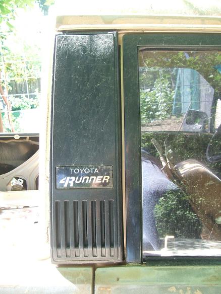

:wtf:.............OK, so I figured the fasteners for this was behind the interior trim...Nope. Anyone out there feel like throwing me a bone, I'd appreciate it.
Well when I bought my 4runner it was missing. One of those emblems on the side.. they have slots on the back of the emblem that little plastic clips slide in on the back side of the eblem that jus snaps into medal holes on the body.. but I don't think the clips r reusable.. so basicly u should be able to snap them off.. and on that note does anyone know where I could purchase those clips on the back of the emblem
The fasteners are one time use, you can get new ones from the dealer.
I've ripped mine off several times wheeling. I just use RTV to attach them.
