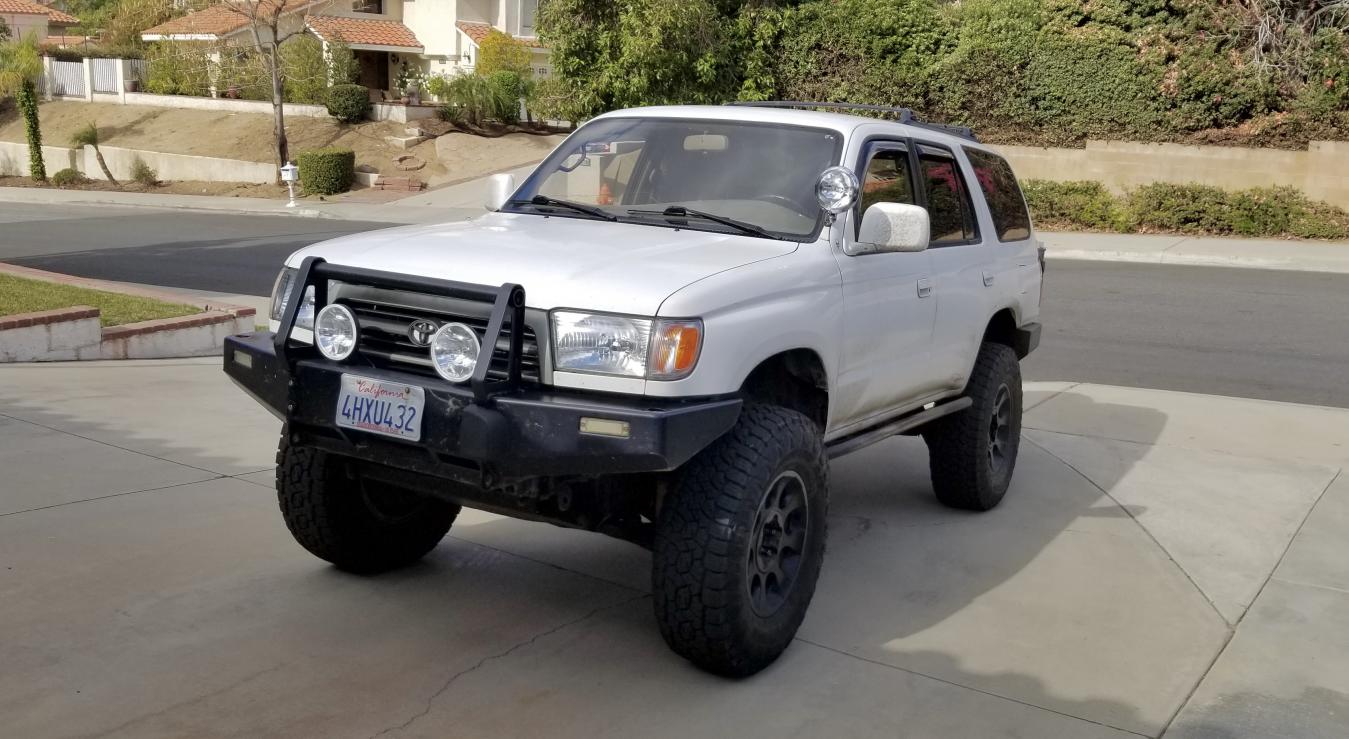

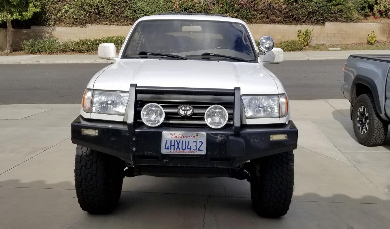

8 or 9 years ago, my buddy Jason and I took an angle grinder and clearanced our ARBs by trimming off much of the plate along the bottom that was getting caught up on rocks. I ended up taking about 3” off the sides, 1” at the outer corners, and almost 2” by the bottom center. We then welded some angle iron along the inside of the bottom edges to reinforce it, and it has held up nicely since.
A couple days ago, I chopped off the hoops around the headlights. I’ve always thought they made my truck look like it’s wearing glasses... as my niece said, “now it got contacts”, lol. I like it way more now. The hoops actually go through the plate, so it left holes there. I thought about welding some plate over them and grinding it flat, but at the end of the day I don’t care, so I just re-painted and called it done. Maybe I’ll use them as fishing pole holders. Anyway, the new and improved ARB...

Probably a combination of excessive spam and the direction the 3rd gen market is going. Nice bumper. I always thought ARB's hoop design was always a little basic. How has all that trimming affected the structure?
Won't really know that one until the bumper meets a large, heavy object! I can't imagine it making it stronger but at least it's a bit more narrow and lighter.
I trimmed the bottom of it off almost a decade ago. It has met plenty of large heavy objects since then and no damage to it. I mentioned that we welded angle iron all along the inside bottom edge to reinforce it. I’ve had the full weight of the front end come down on the bumper several times over the years so it has held up very well.

I wanted to ask since ARB I think put out one of the first 3rd gen offroad bumpers. Do you know how heavy yours was before the mods? Curious how it compares to other offerings these days.
I think mine was about 100 lbs. before my mods. I remember I could lift it on/off myself without really straining, so I can’t imagine it weighed any more than that. It’s probably around 85 lb. now.
