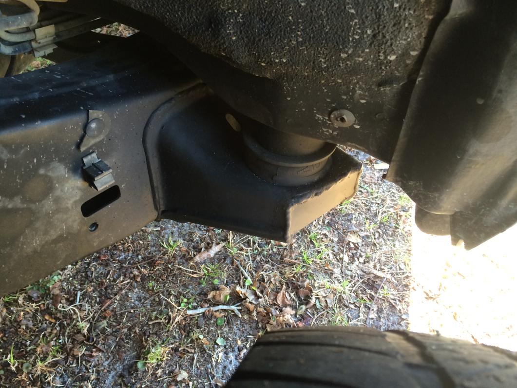

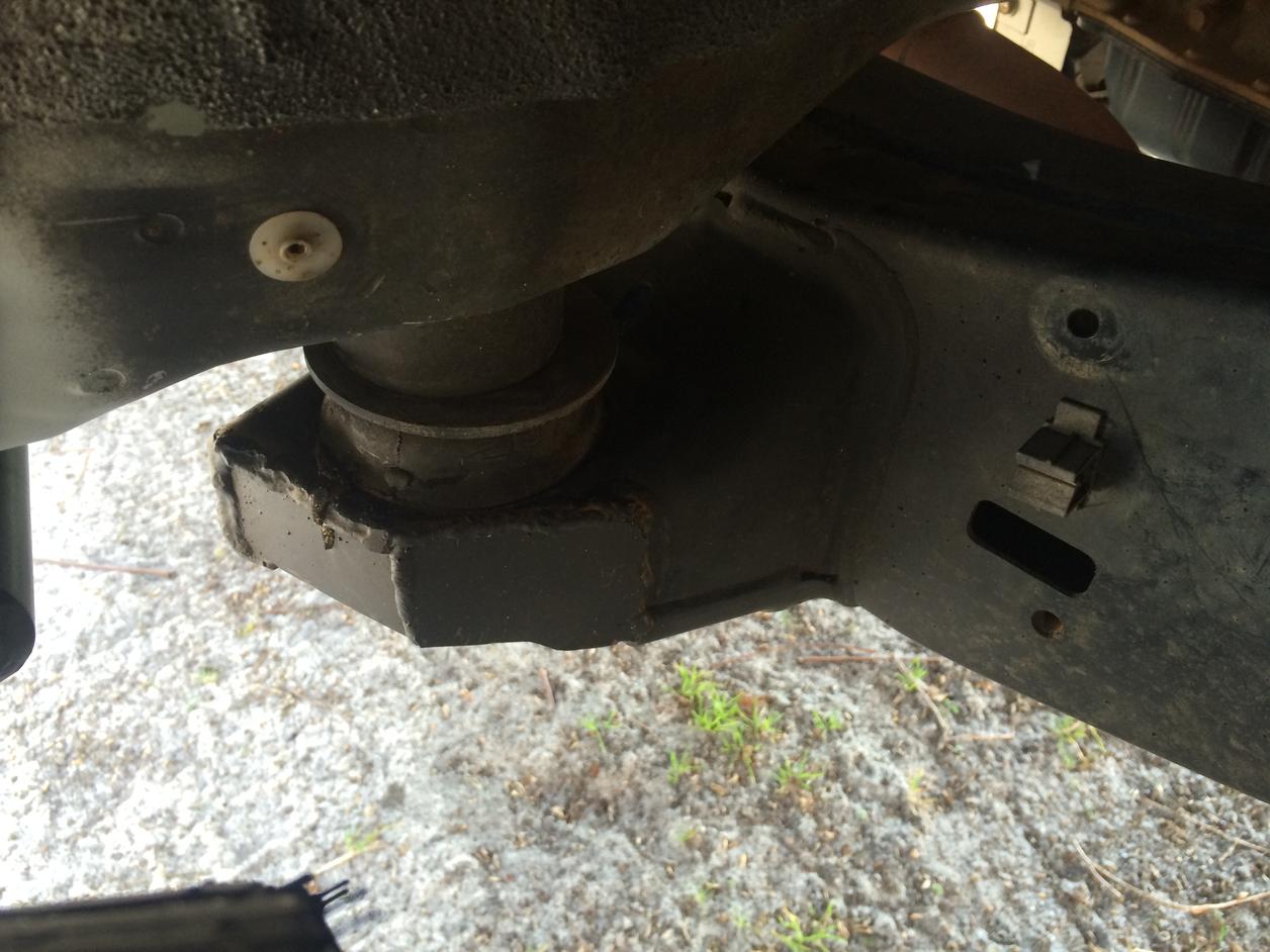

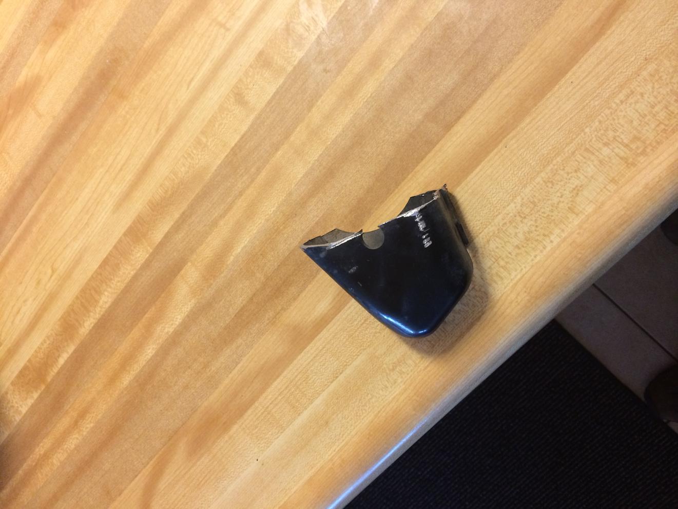

The first Body Mount Chop (done before wheels and tires arrived). Note: this much is just about required to even get the tires on and drive it around...
Amount cut:

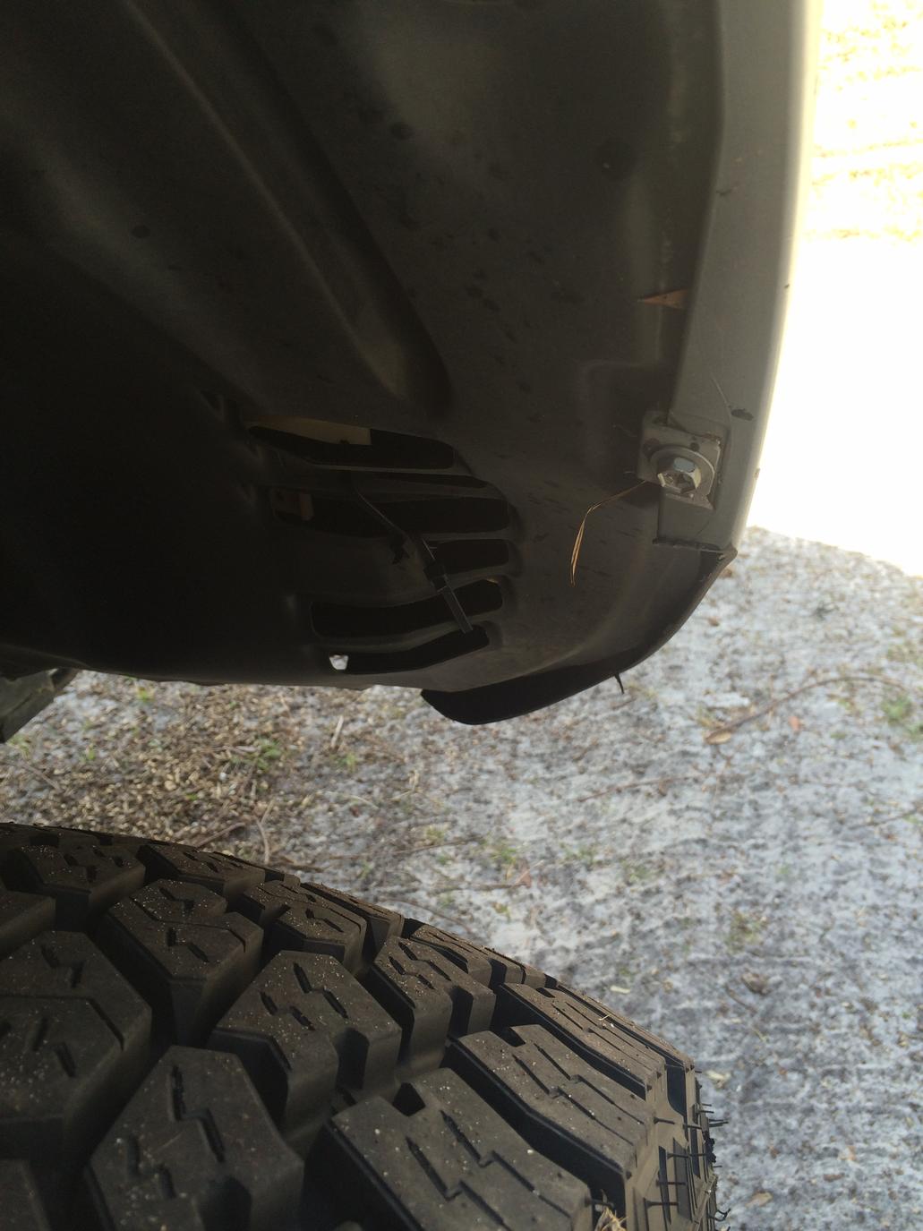

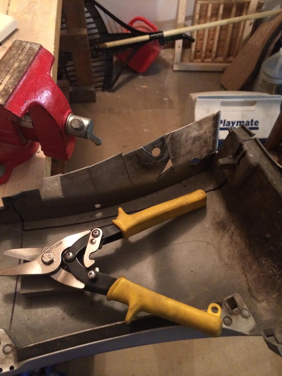

Front bumper and inner liner (done prior to tires as well). Turned out this was plenty.

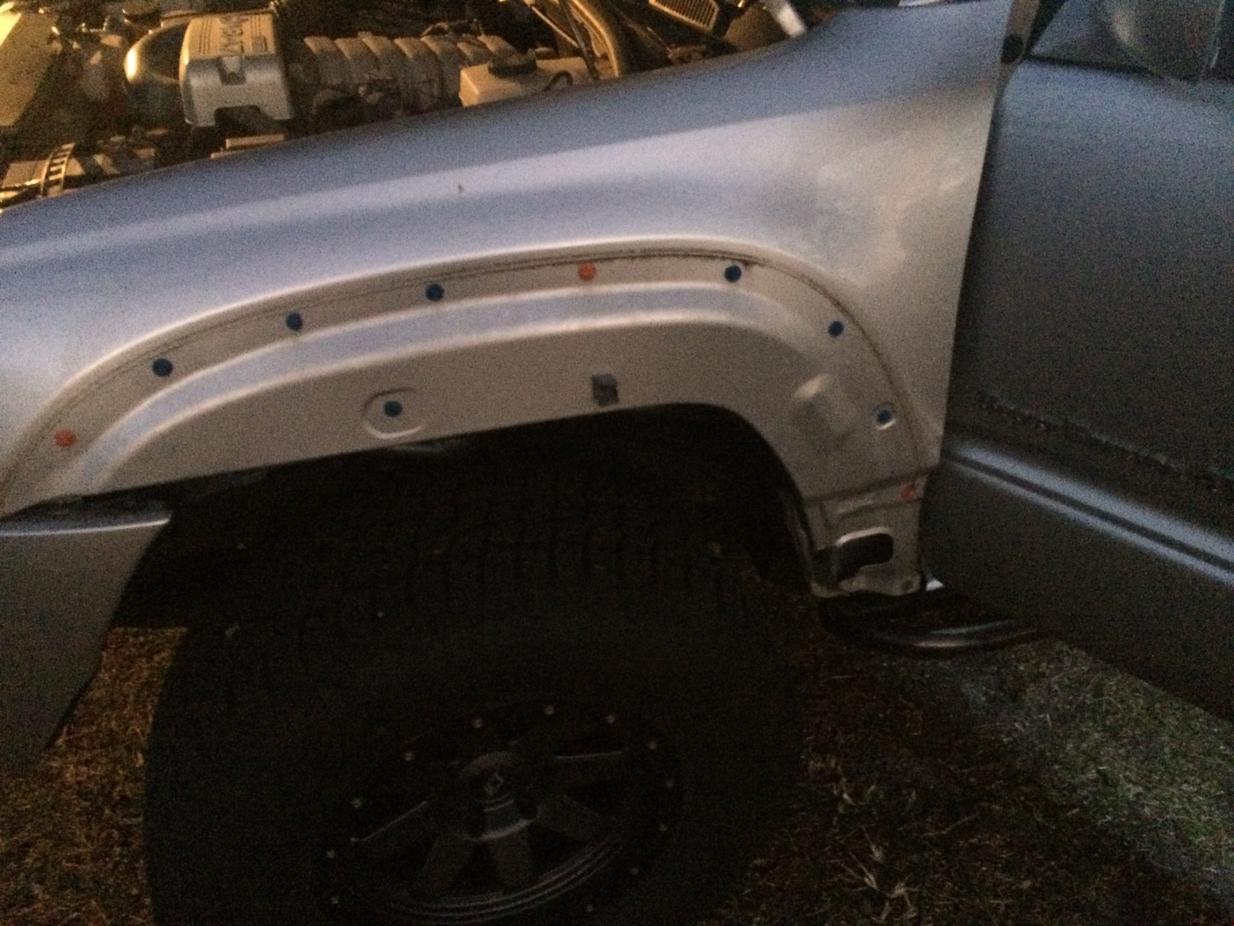

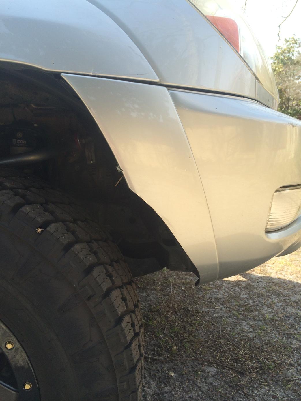

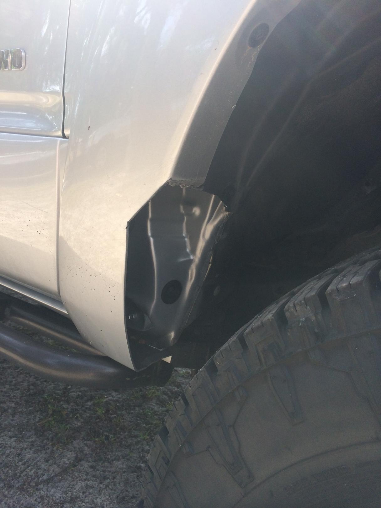

I was still rubbing on the back side of the inner fender and at the pinch weld when playing with it off road... so:
And, I still had a little rub on the body mount, so it got cut a bit more up front:
And that, ladies and gentlemen, is what needed to be trimmed.

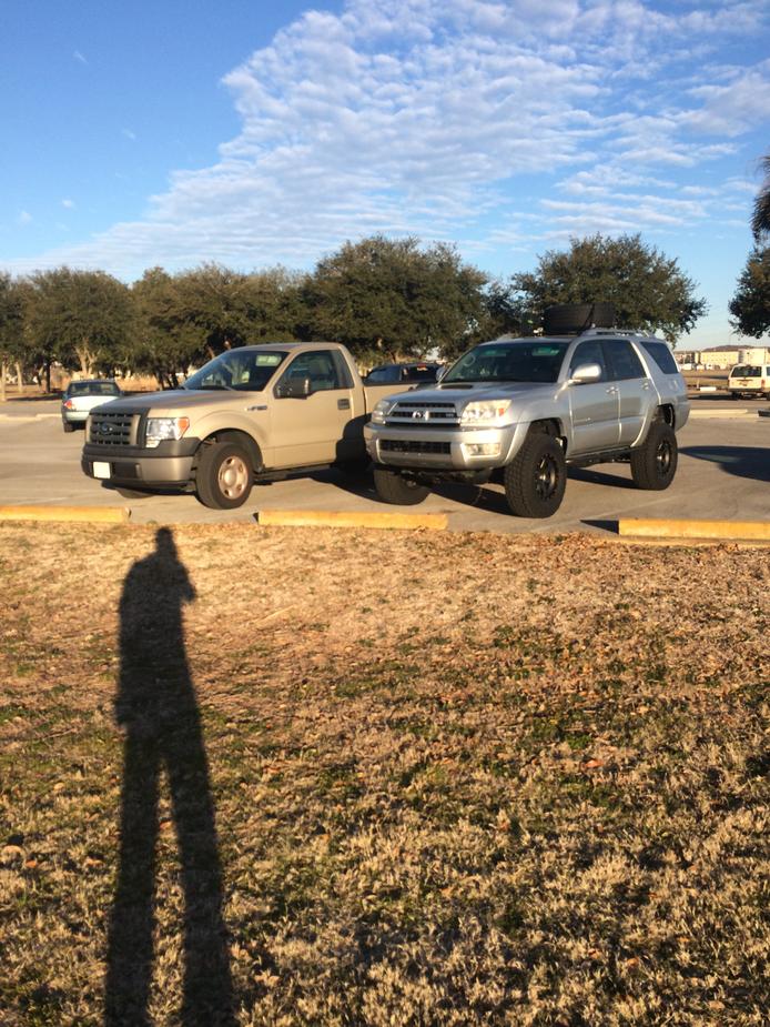

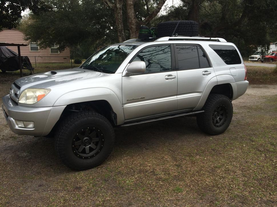

A reminder of why we do the things we do to our 4Runners:
How she sits:
And compared to Air Force (read: "definitely stock") F-150:
