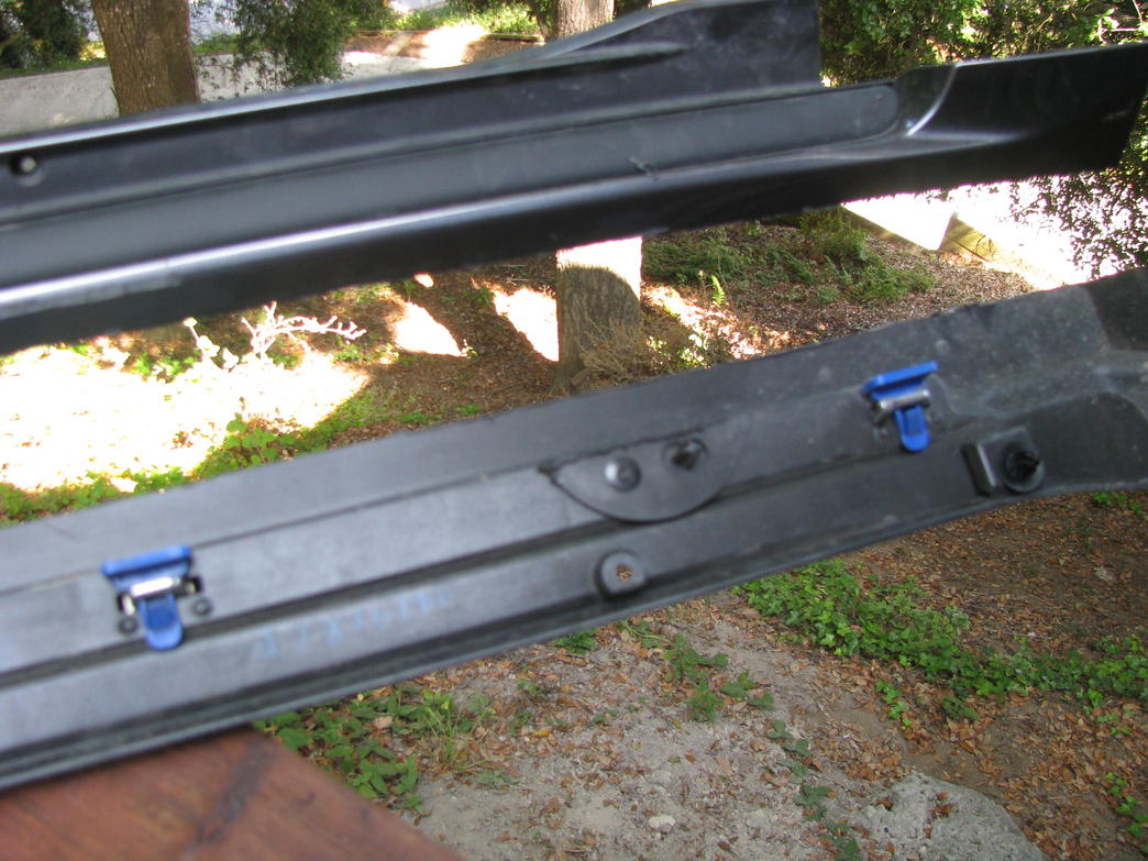

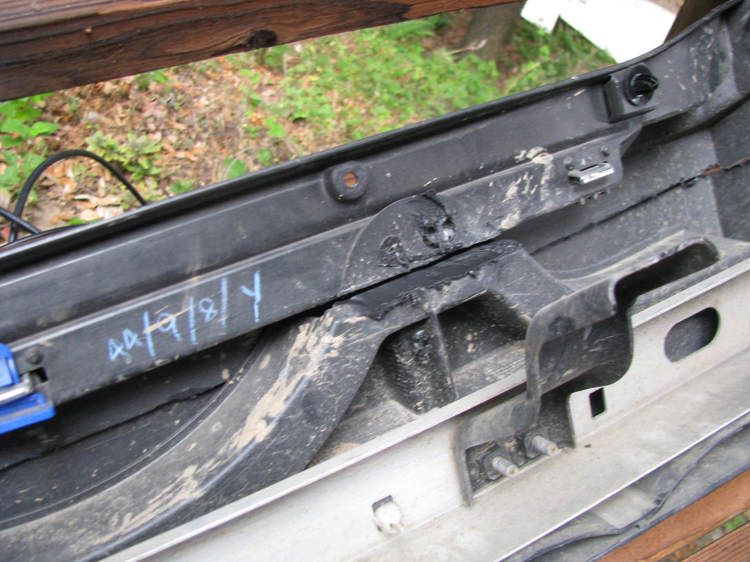

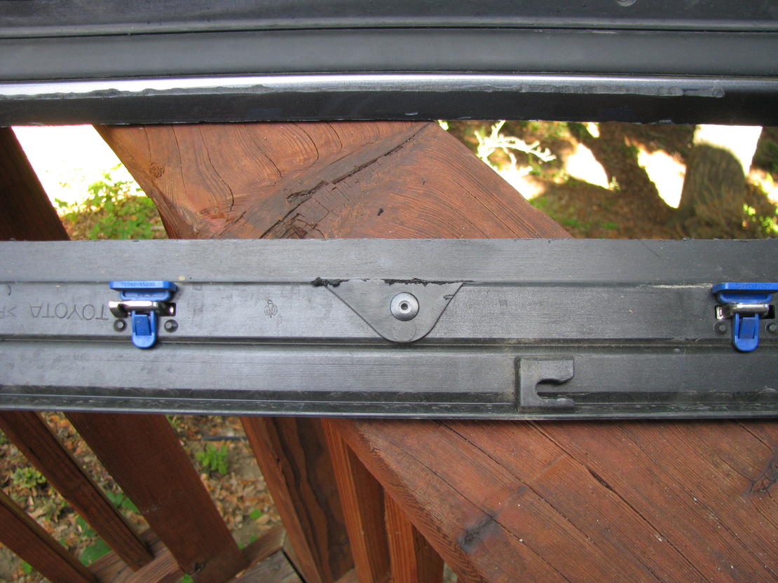

Jay, Sorry it took a few days to get these up. Cutting the front/outside is pretty straight forward, just tape off at desired amount you want to keep and start cutting. On the backside there are 4 plastic bracket things that need to be cut off. They are located in between the blue clips that hold the chrome strip on. Its pretty easy to figure out what needs to be done once you get the rockers off. Hope this helps.
