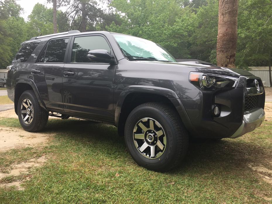

Here's a pic of the day I took it home. It actually came with side steps, I just didn't care for them and removed them they day it came home. I purchased this TRD Off Road on April 29th.

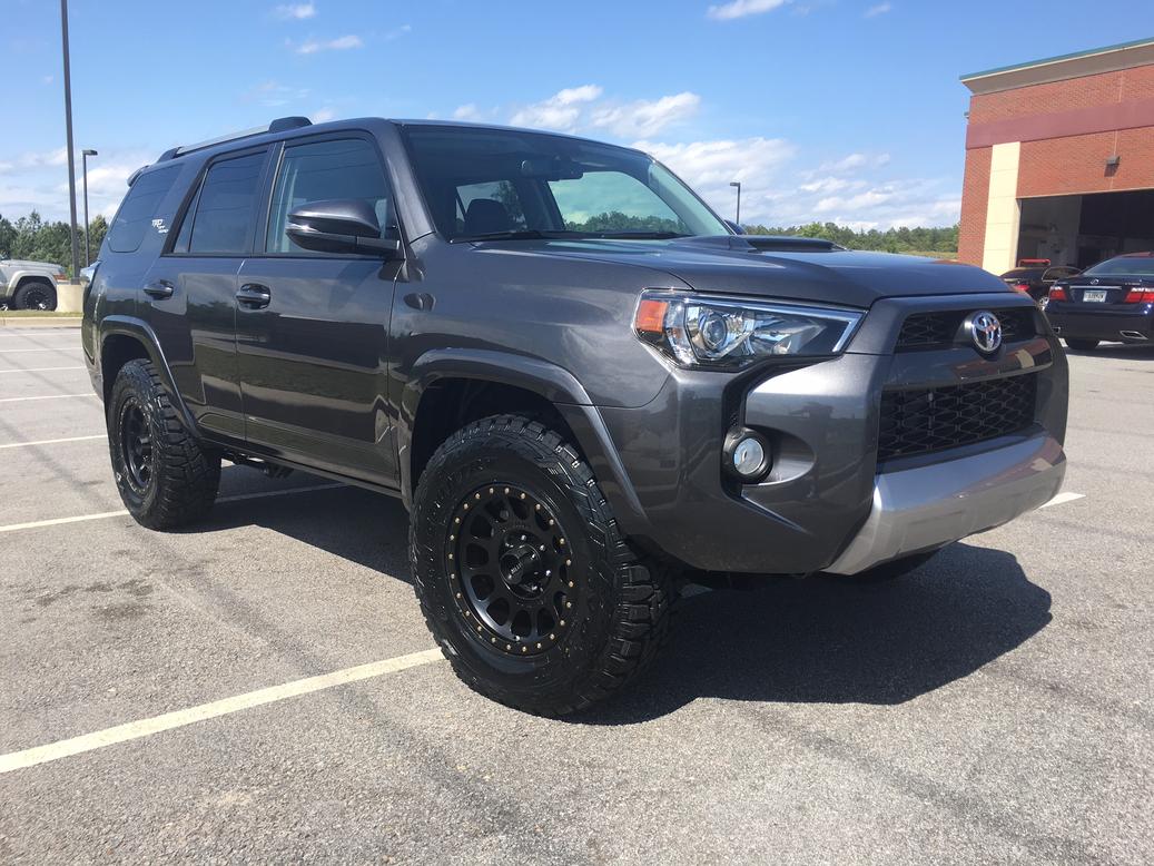

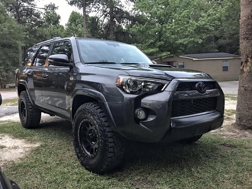

The first thing I did was order wheels and tires.
Throughout the thread I am going to try and be as detailed as possible, as through my search finding posts with tons of details were all the help in the world, while threads without details really left me hanging, especially when looking for things like wheels, tires, etc. I went back and forth a million times with what I wanted for backspacing/offset, and it sucks when you find a pic that's several years old and someone doesn't list any details about it..

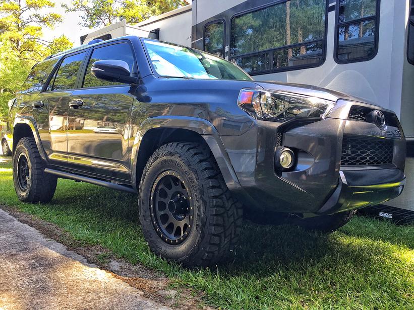

For wheels I went with 17" Method NV Wheels. These wheels have 4.75" backspacing and 0mm offset. When doing the math, I believe these stick out about .6" more than the factory wheels. I really like these wheels, a little indifferent about the faux beadlocks/bolts, but I can paint them if they bother me. So far so good. I knew that I didn't want Fuel's as I had two crack with zero offroading on my previous truck.
For tires I went with 285/70r17 Toyo RT tires. On my previous vehicle, a 2013 F250 Lariat, I had over 55k miles on my 35" Toyo MT tires without a single hiccup. I probably could have got another 5k-10k miles out of them as well. Because the 4runner is smaller and the engine is a dog, I wanted something a bit less mild that still had an aggressive tread pattern. I felt like I made a solid choice in the Toyo's.
Once these arrived and were installed I had to do the fender liner mod and trim a small sliver off the front bumper. I also removed the front mud flaps, but may trim them and reinstall at some point. I now have zero rubbing with any driving on the stock suspension.

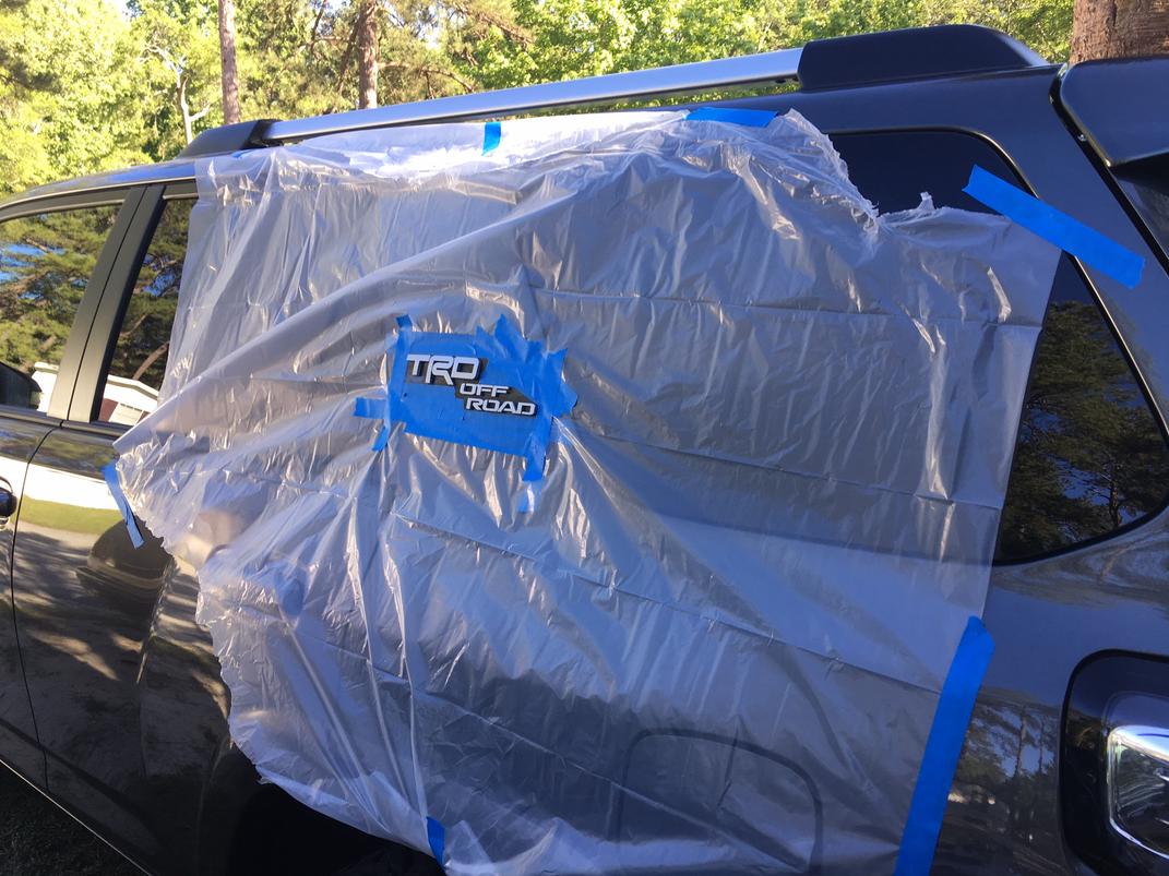

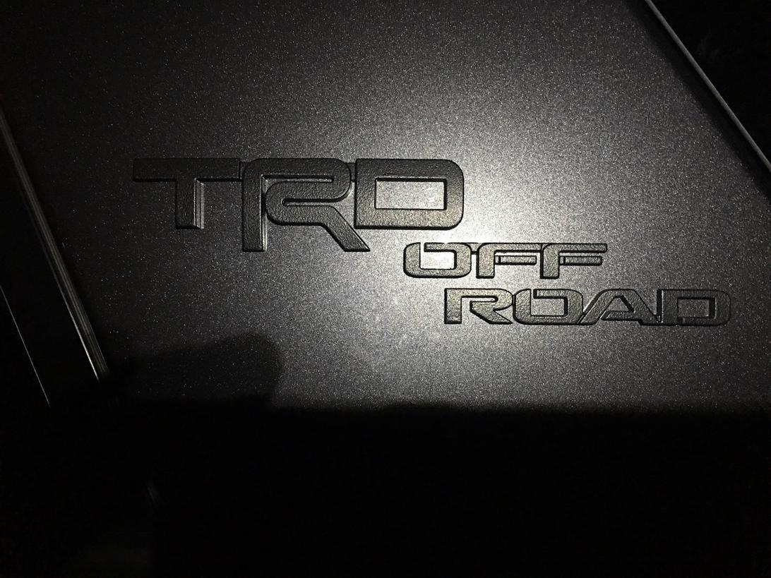

One of the next must-do's I felt was blacking out the emblems and front and rear bumper valences.
I ordered the TRD Pro front and rear bumper valences. The install was a bit of a pain, as it seems it was for most people, but with a good "how to" I found on the forum, we knocked it out in around an hour and a half. For the emblems I ordered the black plastic emblem covers for the front and rear. They don't have them yet for the "TRD Off Road" on the sides, so I plasti dipped those. It was my first time and I did around 5-6 coats spaced about 20-30 mins apart. The only picture I have of them is at night because that's when I finished it. I thought about ordering a black "TRD" emblem from the TRD pro so it's of high quality, but I figure that might be kind of poserish.

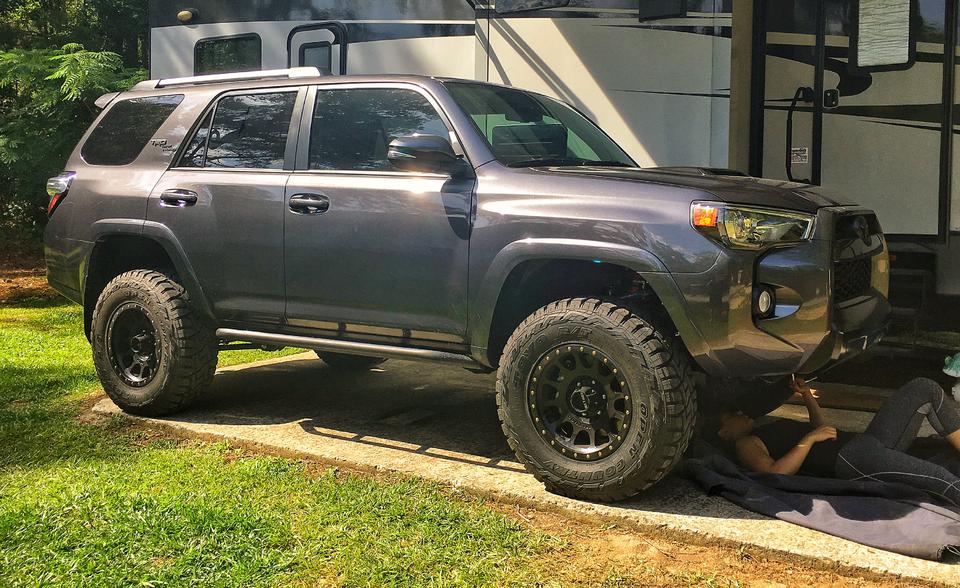

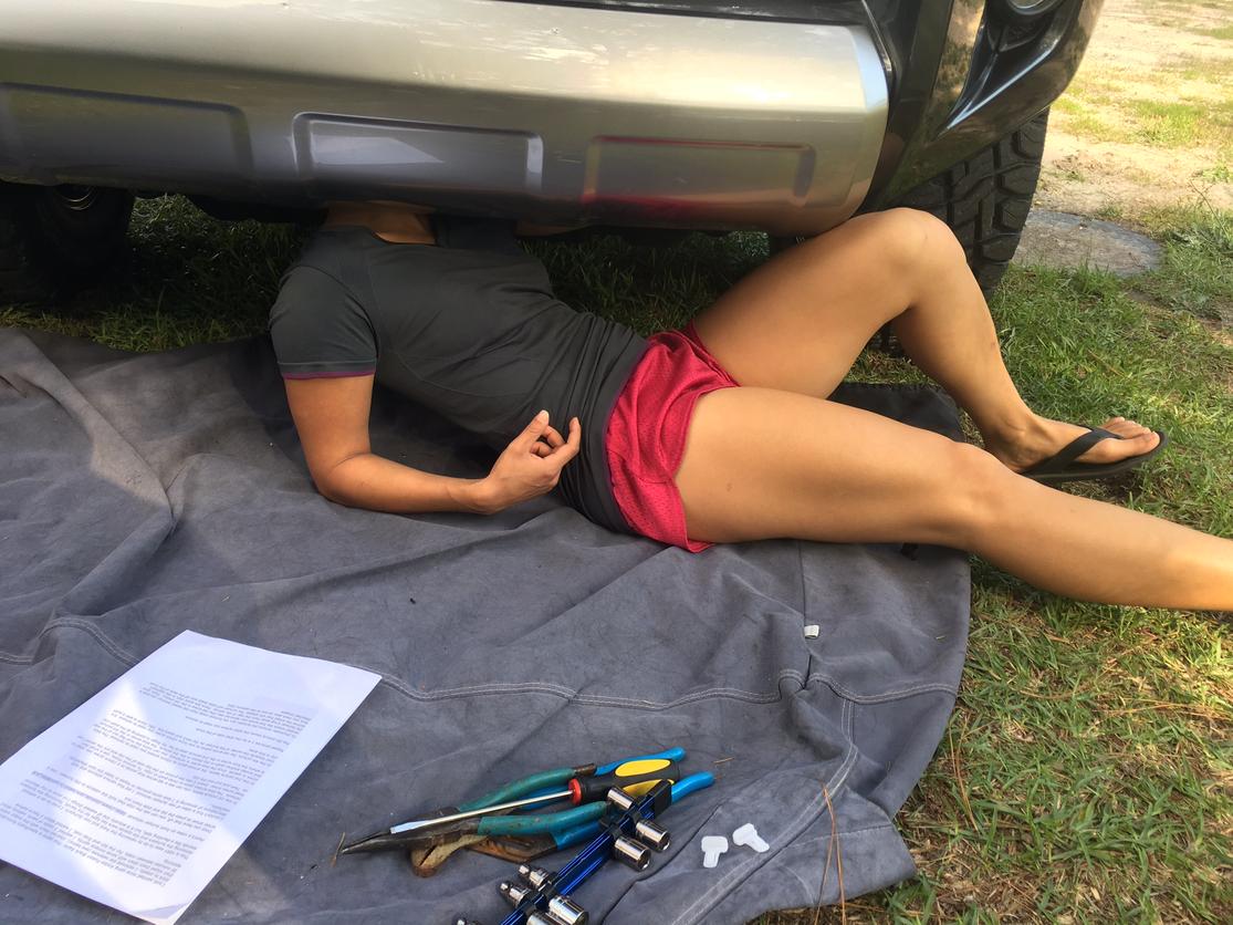

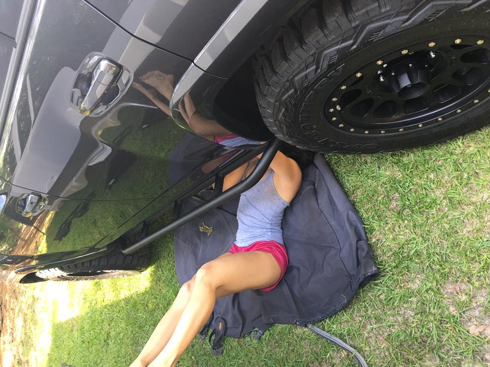

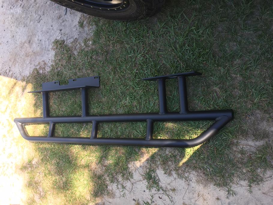

The next mod we did was sliders. I spent countless hours looking over pics of every single slider imaginable. I really am not a fan of door dings, and knew these would help give a little protection. My last truck had N-Fabs, but the coating on those sucked so I vowed not to get them again.
So that led me to the million slider options and the million great threads discussing them. My patience isn't the best and even though I loved Shrockworks step sliders, their notorious 8-12 week wait just wasn't going to cut it for me. I called around to some of the other various common slider companies and 6-8ish weeks was seeming like a pretty common theme. I also did not really care for the kickout in the rear. I absolutely understand the practicality of it, I just don't care for the look, and honestly I doubt I'll be wheeling extreme enough that it will make a huge difference to me. We'll see.

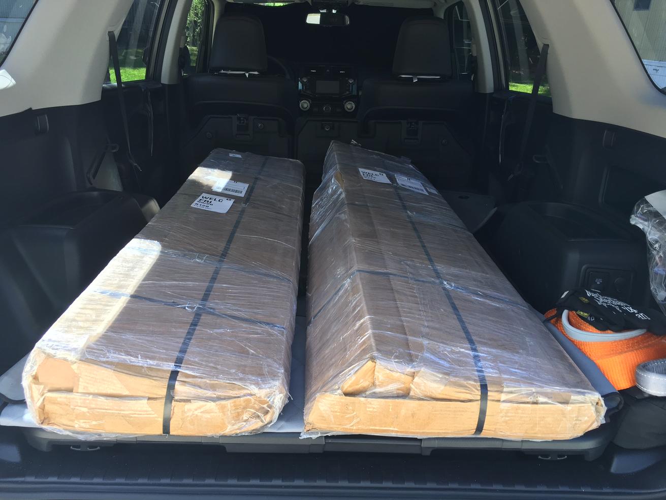

All that aside, I decided to go with BudBuilt sliders. I called them up and they said about a two week lead time to build and powdercoat the ones I wanted. Awesome! I put in an order on 5/8, and they arrived 5/19! It does help that they are just a state away, so shipping was fast and cheap.
When these arrived, the quality of them was great. The packaging was unreal and coating looked to be very well done. The welds were plenty durable, but not the most beautiful looking, but I'm sure they'll hold up. I have a degree in welding technology and am a Certified Weld Inspector, so my standards are a bit high, but still no complaints and I'd order them 10x over.
Install was fairly straight forward, unscrew half the gas tank skid and a clip holding a brake line on the drivers side and we were good - just the brake line clip on the passengers side. Drivers side had a few more threaded holes, and thus took a few more bolts. Both sides are very secure and they look great. Total install time was less than 2 hours.

Everything looks great so far!!! I'm excited to see what you do next! Do you have a list of "future mods"?
Also...are we all witnesses to a crime or is she helping out under there?
:hiding:
:hiding:
Lol, she is helping out under there. I'm at work at the moment and just got a text from her that said, "I'm excited to do the suspension this weekend, I hope it goes smooth." So.. I think she enjoys helping!

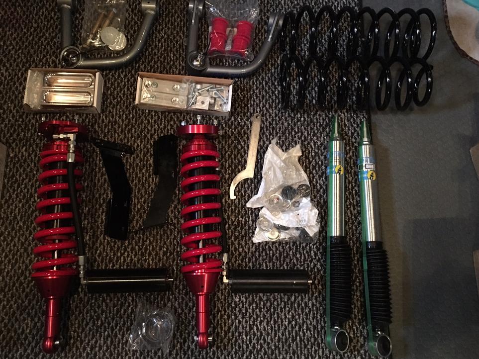

That being said, the next mod is the suspension that we are hopefully installing this weekend. As you can see form the last pic, we live full time in a 42' Toy Hauler as we travel all over for work. So no garage to do the installs, but you can get quite a bit done in the grass. For the suspension I plan to pull it up on our concrete patio so we have a good level service.
Here's a pic of the suspension going on this weekend, I'll do a post more about it after we do the install.

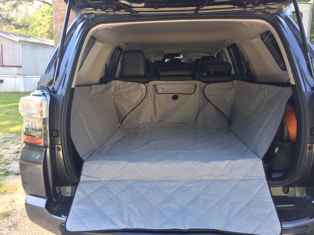

Leads me back to my 4Runner.. We picked up this protector for the rear off Amazon for $50 until we get some shelves built, he seems to like it, however it seems like it gets really hot in the back, so not quite sure what to do there.

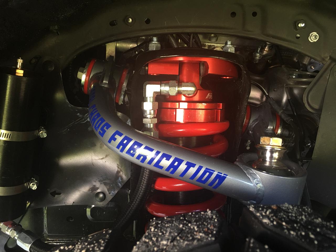

My wife and I spent the better part of this weekend getting the full lift/UCA's installed. We ran into a few hiccups but other than waiting on a new abs wire, everything is driving beautifully and good to go. 22.75" in front and about 24.25" in the rear. Big thanks to 2016_4_runner_SR5 for helping me through a few challenging spots as I'm not the most mechanically inclined. Had it aligned today after putting some miles on it and that Turned out great.
Suspension is:
2.5 toytec front coilover with reservoir
Total Chaos UCA's
Bilstein rear with Toytec spring.
Drives and feels great. I'll get more pics soon but been a busy weekend.
That sucks about the ABS wire. Btw, did your abs light on the dash light up? asking b/c mine never did, however my abs has not engaged since I did my lift.
Btw, awesome rig you've got there. Must be nice to have a wife that will help you out rather than break your balls every time there is a set back or mock you for looking at "truck porn".
Suspension is:
Total Chaos UCA's
Looks great you two! I'm excited to see more pics! Nothing better than a productive weekend. Well done
My dash board is lit up like a Christmas light. Like 3-4 lights on, all which seem common for a broken abs wire. My wife is definitely great. She was out there with me all weekend and probably did half of it, constantly asking questions and wanting to do certain parts. She could probably be a little harder on me with all the $ spent on mods but I can't complain cause too hard would be even worse. One day I'll make a post about our recent 3000 mile motorcycle trip through Baja we did together this spring.
