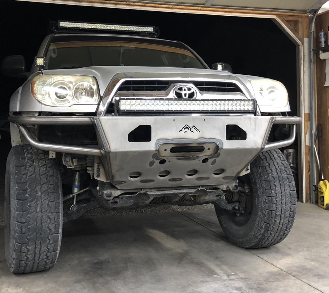

Got mine all welded up this last weekend. I love how it turned out. Only issue I have, and I knew this going in, is the gap between the wings and the fender due to my body lift.

I have a question for you regarding the install of your winch in your TNF bumper, more particular the metal A/C line. It looks like I need to bend the metal line up about an inch and a half and back several inches. Just wondering how you went about it. Did you just bend it to clear or did you have to move or modify the brackets too? I don’t have any problem with bending it I just want it to look clean and of course not break.
Any help is appreciated.
Also on a side note I did end up ordering the TNF recovery points with the frame tie-ins.
So initially I just bent the AC line back. This seemed to work, until I rubbed a hole in my AC line back where it crosses the bumper back towards the radiator...
Right way to do it is to disconnect the center bracket (the one the instructions have you cut) and bend the AC mounting brackets until the AC lines fit behind it. Then, if there is anywhere your AC lines are close to the bumper, get some rubber hose and jacket the line so vibrations don't wear through the metal.
Just wish I could find a reasonably priced rear bumper...
Thanks. I did drill out the spot welds and removed the center bracket entirely. I also bent the line and sleeved it with rubber where it passes behind the bottom left when I installed the bumper and after reading about the issue you had. Sounds like I’ll have to just carefully bend the entire line back from the pressure port on the right across to the left.
