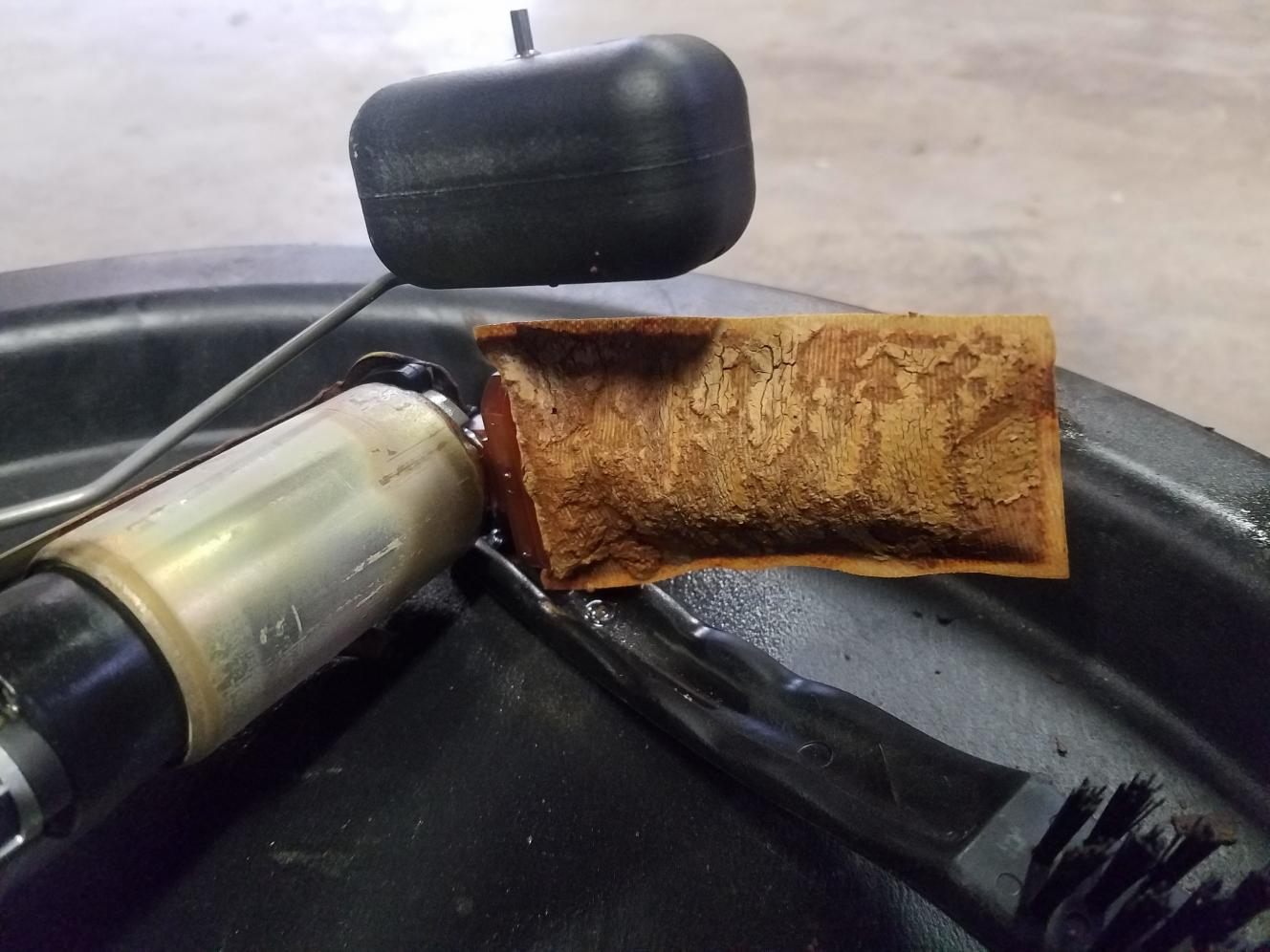

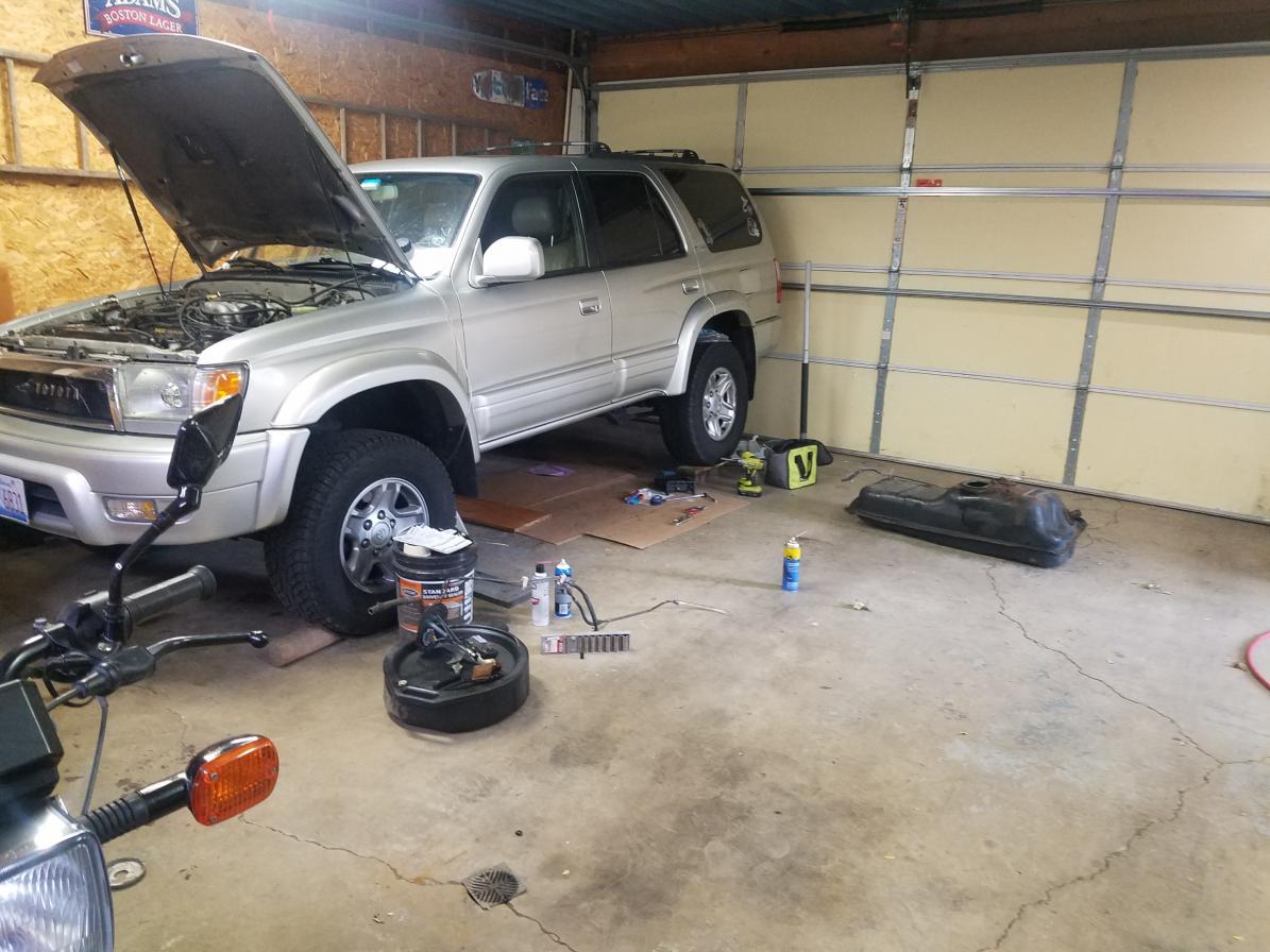

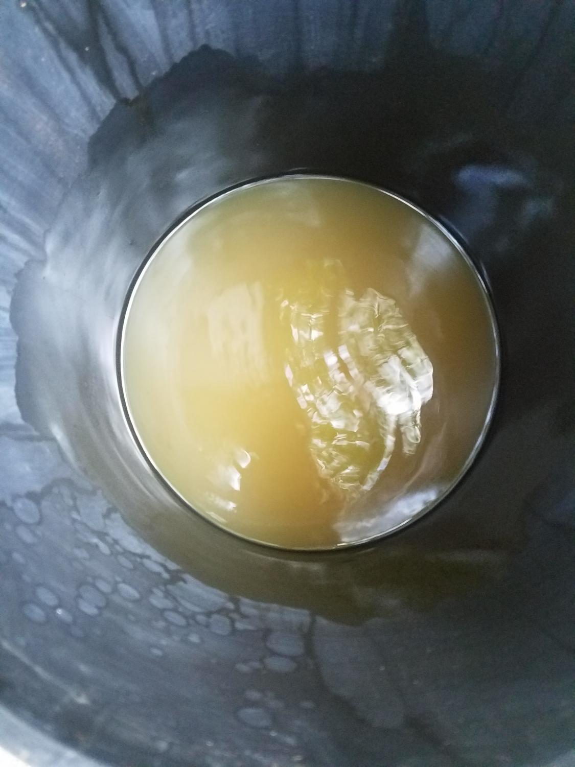

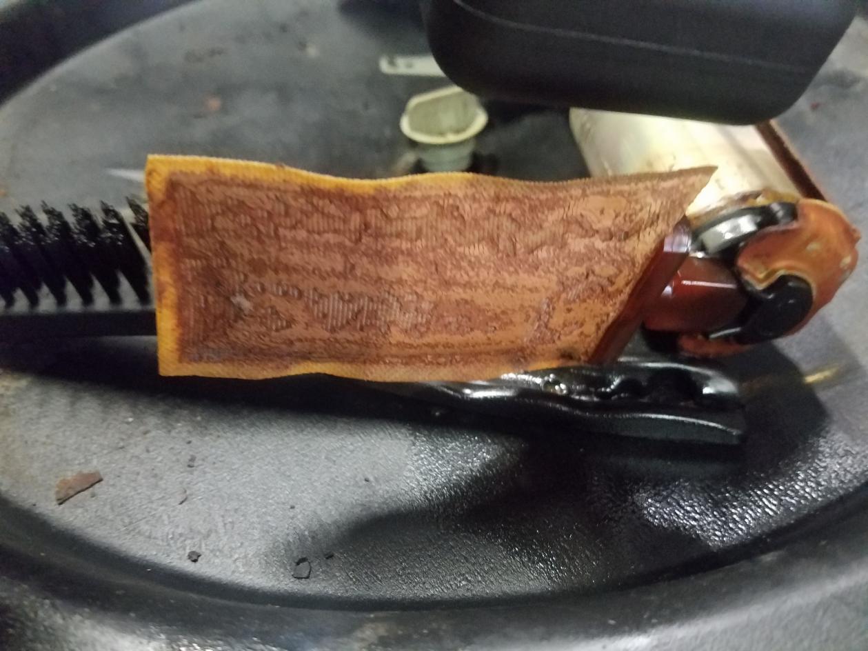

Think I found my lack of fuel/throttle response issue...Only way to have figured this out was to drop the tank and investigate! Got a new fuel pump, and screen on order along with a new fuel filter. Couldn't believe how nasty the mix of fuel and gunk I got out of the tank was! Thanks for all the replies everyone. Cheers!
