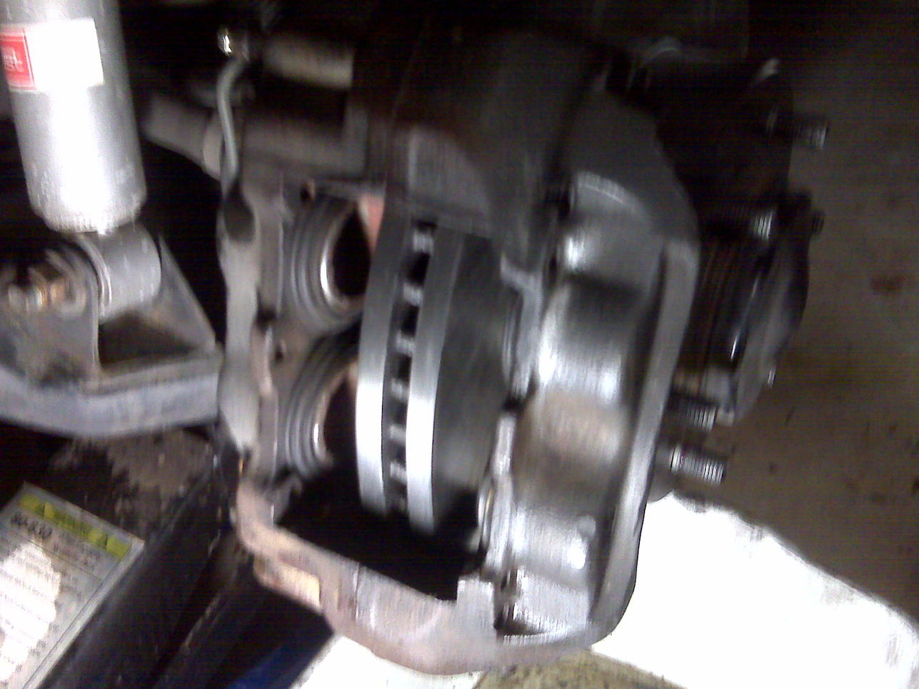

So today I installed the 199mm Tundra brakes. Not too bad for those contemplating this over the 231mm brakes. I went with the 199mm because I didn't want to do any cutting or come across any unexpected issues like stuff not fitting or rubbing, etc. The only regret is that my hands were way too dirty to work my camera to take too many pictures. I did manage the one after I had the caliper on. One word of caution on these....make sure you get that caliper seal placed properly. It will leak like crazy once you get some pressure on it! I guess that's true all the time though...
So now my questions!
On the test drive, the truck shakes like crazy when applying the brakes. The faster you go, the worse the shake. Could that just be a warped rotor or what? Any other possibilities? In a moment of stupidity I didn't get the rotors turned before I started...and I decided to do it on a Sunday so that there was no possibility of help if I hit a big issue.
So I figure I'll take it to a shop tomorrow and have them turn the rotors. I'll post if that does fix it or not. Thanks in advance for any experience!

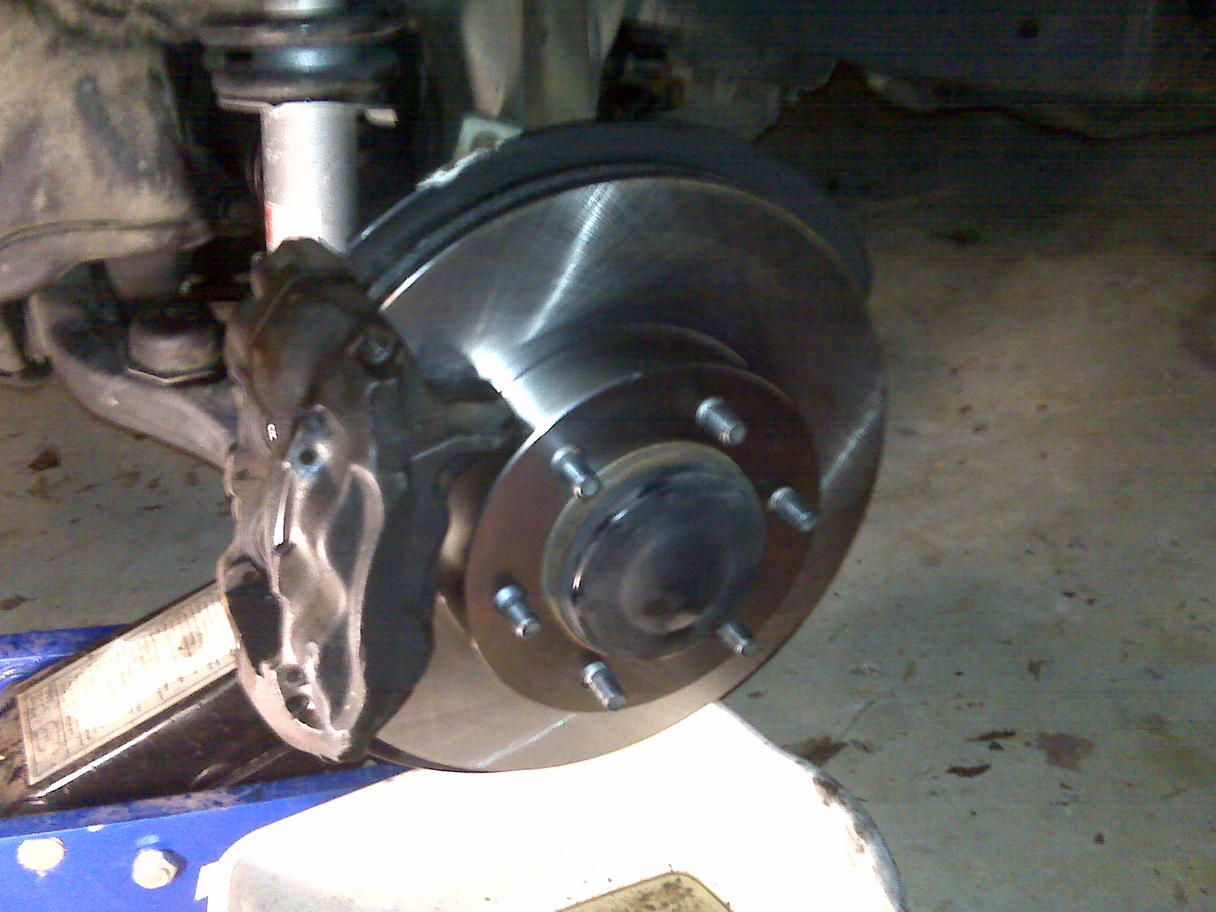

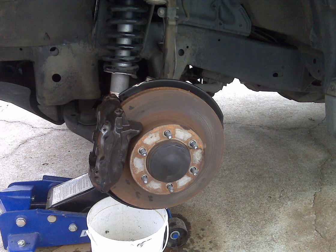

I put on the new rotors and WOW! Now it's doing what it is supposed to do...stop like a....stop like a...like something that stops really good.
Final word on 199mm brakes...worth it. Do it.
Thanks for all the help guys! Now a couple of crappy cell phone pics of my shiny new rotors!:banana:

Glad everything worked out for you! I think I am going to install them as well the next time I do my brakes.
I recommend it, as long as you don't pay too much for the calipers. I also put Wagner brake pads on it. Now I need to clean those rims and see if it generates as much dust as those autozone pads! Those pads made my rims dirty just sitting still! Today was my first full day of driving with it all working right, and I am very happy. You can feel it braking with even the lightest touch on the pedal. I even had to do a quick stop today and it really impressed me.
