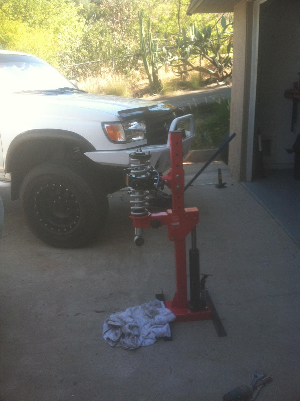

I actually just got done adjusting my 5100's up one perch (since my last post earlier,lol) to put it on the the second and i am super STOKED ! to say the least .it raised the truck to almost level with maybe a 1/2" of rake so now it's hardly noticeable,and it looks great ! also installed my diff drop . i bought a inexpensive hydraulic spring compressor trying to keep safety in mind ,thinking that a heavier rate spring might be a little much for the threaded clasp kind.well it was a toss up ,the hydraulic was a bit sketchy to use as well.seems that the bottom coil isolator doesn't want to sit flat on the compressor perch due to the factory angle of the bilstein bottom isolator, not letting the shock body sit straight up and down .blah blah blah .its still a little sketchy but in a different (rip your face off,not your arm)sort of way ,IMO.but requires less tools and is quicker .i had to put that GIANT POS together before i could start so it took me a bit .all in all now i am satisfied ,for the time being. sometimes have to question some info i read in order not to get pointed in the wrong direction. after all you can find someone that says what you want to hear if you look hard enough,but if you read between the lines of opinions its not hard to figure out a tech credible tips or just regurgitated info .Thanks again for your help !
