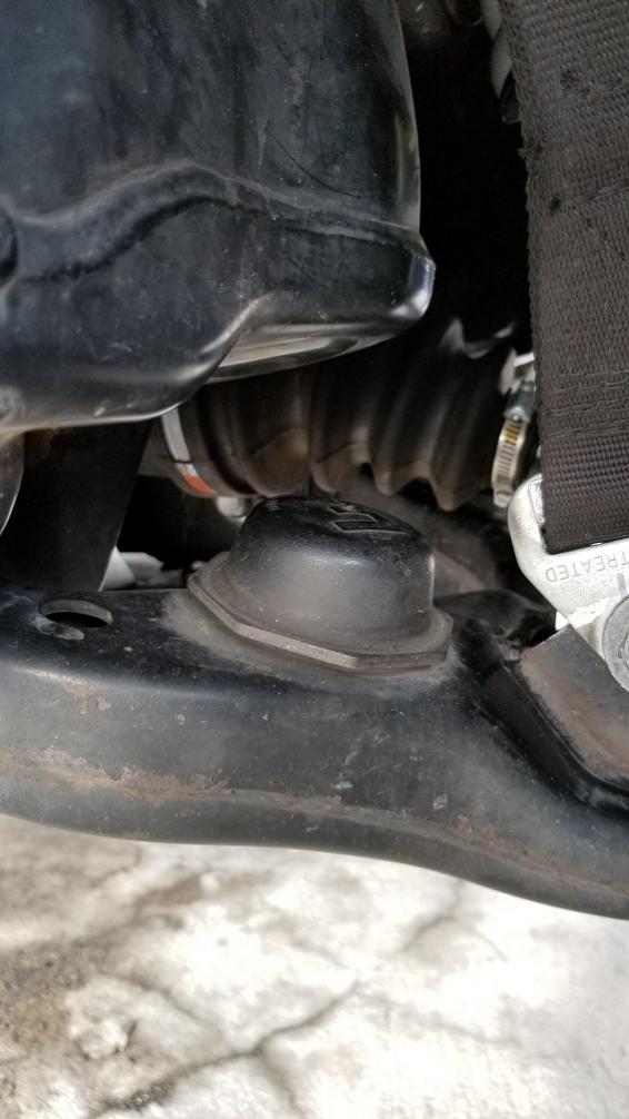

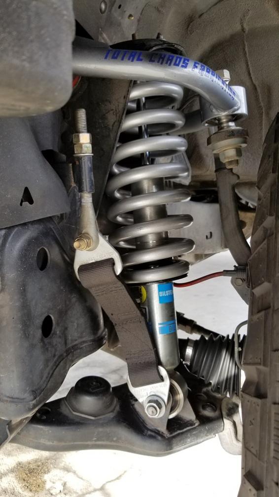

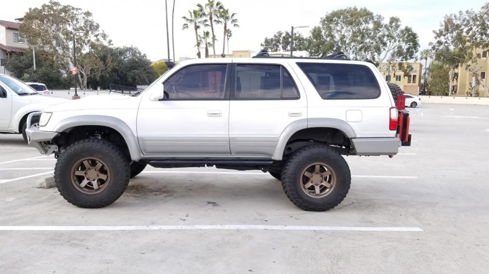

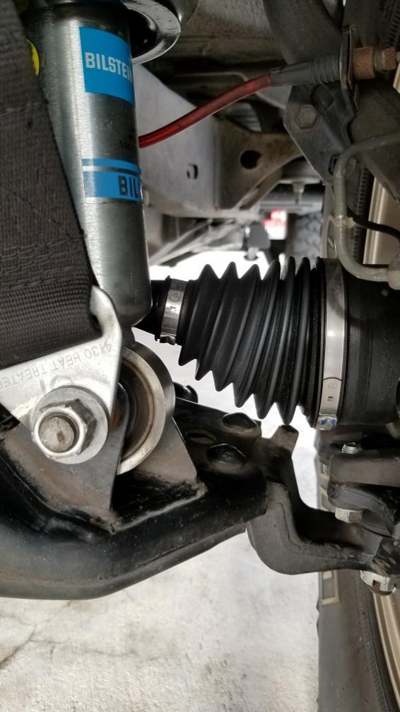

Ok guys and gals, I just installed the Tundra Eibach coils (part # E30-82-066-04-20) with my Tundra Bilstein 5100s. Not to be confused with 4runner / Tacoma Eibach coils, which is the combo everyone seems to be using. I installed them on the second perch and the ride quality is amazing. Smooth and comfortable. Total lift from hub to limited fenders is 23.5”. This is after settling which was very slight btw. My previous setup was the Tundra TRD factory coils on the 3rd perch along with a ¼” top plate spacer. This gave me around the same amount of lift but the ride was extremely harsh.
Needless to say, I am very happy with this setup and my only regret is not doing it sooner. I spoke to Eibach and they said this coil is not progressive but linear and the coil is rated at 645 lbs. The angles all look good and the flutes on my cv boots don't touch, this is of course after doing the boot slide mod.
Keep in mind I have a front bumper with winch, rear bumper with tire carrier, skids, and sliders. If you are stock, these numbers would definitely change. You could probably get away with the same amount of lift on the first perch.
I hope this helps anyone that wants to go this route.

Thanks, the struts were part of a complete lift kit from Sonoran Steel (Kit 1.2), the kit included factory TRD Tundra coils which on the 3rd perch was too much preload for my liking to obtain the height I wanted. With the Tundra Eibachs I was able to obtain the same amount of lift on the 2nd perch (less preload) which equates to a softer ride.
You can get away with not getting UCAs but if you do it helps correct the caster on your alignment. It also alleviates the extreme angle on your upper ball joint.
The limiting strap helps alleviate stress on the the strut at full droop and also prevents the cv joint from binding at full droop. I have it set right before full droop.

Well, that seemed to work out well. I think that I would try the 1st perch if I threw these on. Once I start loading the back, even the 861s will squat down a bit. It's hard to see from the pics with your limited flares where you are sitting. I know you said that you are about 23.5" up front. What are you in the rear? Has the front settled down anymore?
