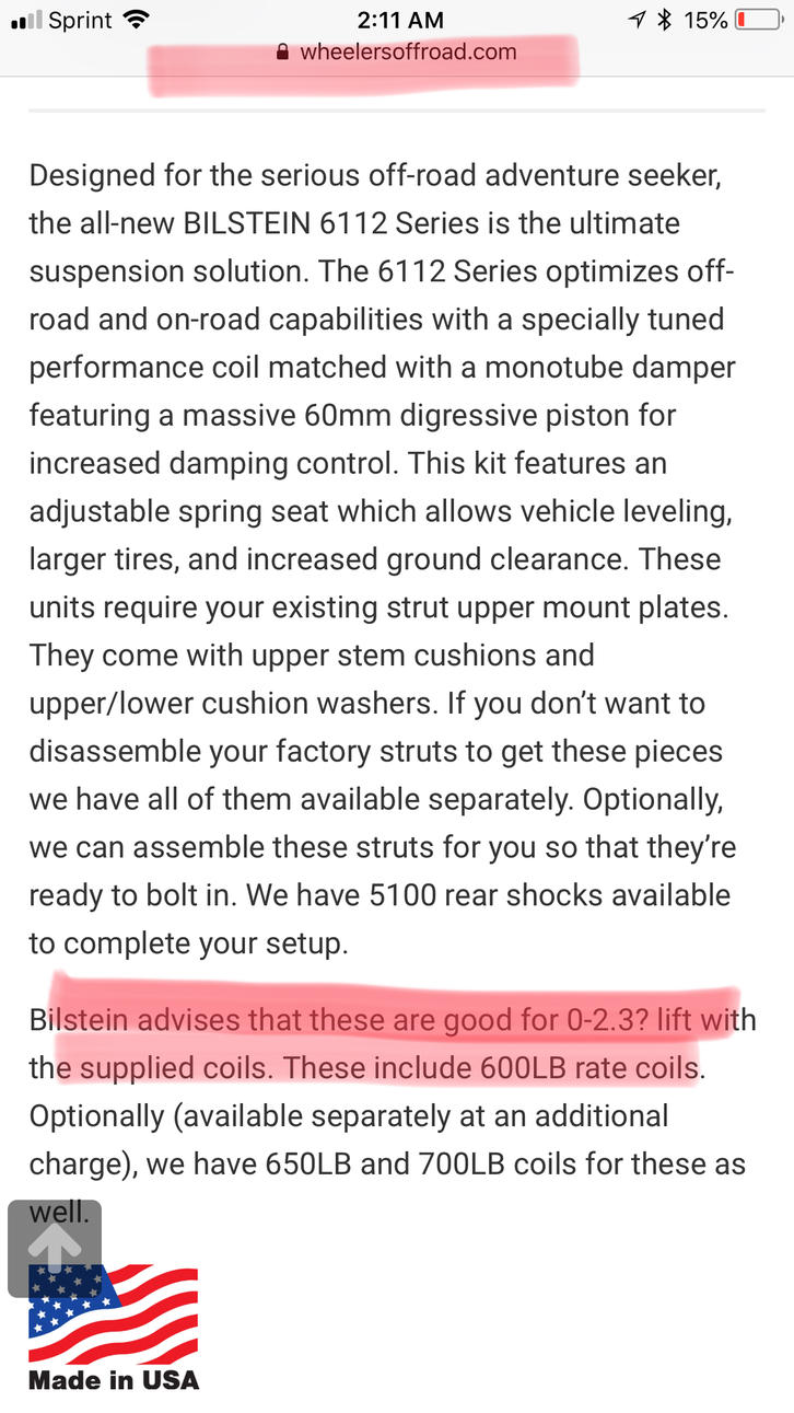

Your post pushed me toward 6112’s but 4runner setup just wanna say thanks and also I thought the spring rate on the 4runner setup was at 600lb? Wheelers Offroad lists them as 600lb springs?https://wheelersoffroad.com/i-30632541-6112-height-adjustable-front-shock-and-coil-pair-for-1996-2002-4runner-47-258624.html?ref=category:1388356

It would be awesome if we could get the tundra shock with 600 lb springs. From that description on wheelers website it seems like that might be an option. I haven't done any calling around just yet, but I think that might be my next front end setup since I'm needing a bit stiffer valving and a bit more spring rate than my current setup. Especially when I finally add a winch to my setup.
