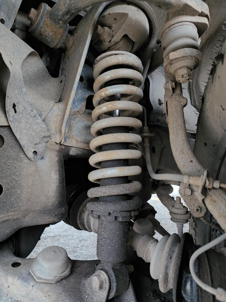

I'm trying to figure out if 6112s can adjust to the same height as my old bilsteins, total lift height right now is unknown. Currently have SPC uppers, no BL, steel front bumper and winch, 891s and steel bumper/carrier out back.
In theory that's around 3" according to what 891s are rated for?
The thing is I bought it with 305s that didn't rub (1.5" wheel spacers), currently on 285s and just want to use my old wheels and tires!
Anybody know if the 6112 are a match for these ancient billys?
Setting on level garage floor my 6112's from bottom mounting bolt center to tophat mount measure 18.750" 2nd perch groove,
tried 3rd was higher than rear 890's. estimating 3rd perch setting had 19.250" give or take. Limited flair to hub center 22.5".
Have AOR plate bumper synthetic rope 9500 winch, 125# hanging off rear.
Are you also running 285/75/16s? I'm saving the 305 MTRs for some offroad focused trips. Clearance in the front has been perfect with the wheel spacers and OEM 16x7 trd wheels.
I measured 22.5 front and 23.5 rear to my limited flares, but I admit it didn't feel all that "precise". Very similar setup to your truck. Steel front bumper and winch/synthetic, steel rear bumper and full size on the carrier in the back with 891 coils. So it sounds like I need tundra 6112s, possibly with 600lb springs though, cheers.
Edit: too bad the tundra ones are all sold out, FML
