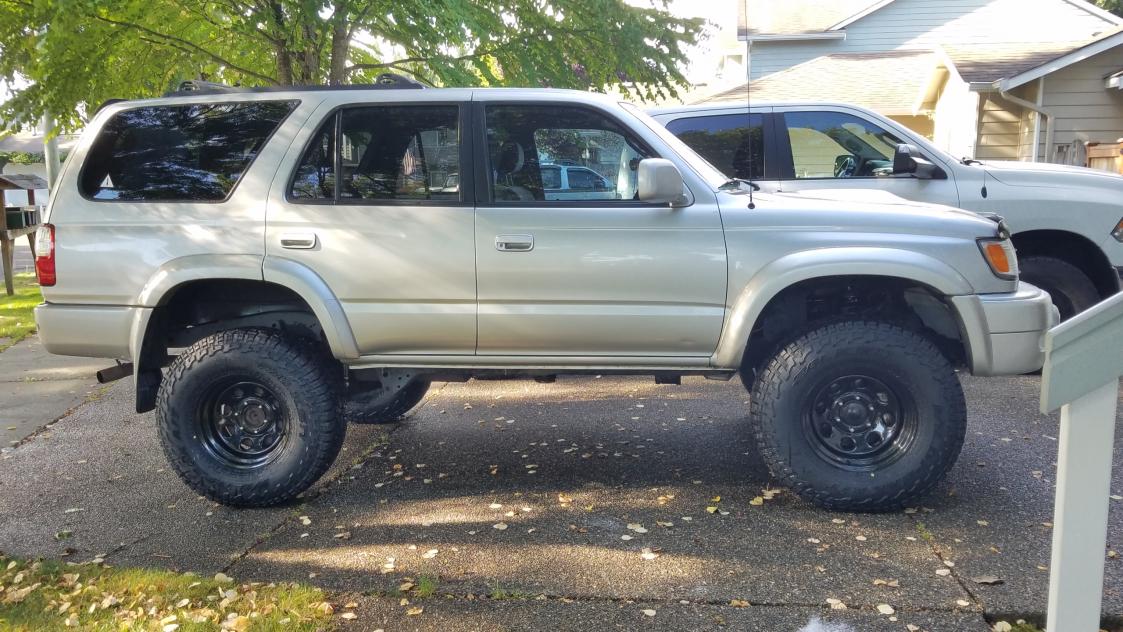

SS1.2 3"-4" lift kit, Front 2nd 3rd perch DS, 8 wrap LC rear.
Stock bumper, Ride was firm on good surface wavy surface, RR tracks not so good roads needed extra weight front and rear.
With Dobson doubt you have as much rake, don't know their specs.
If Dobson has less lift than 4" 8 wrap, the 1st & 2nd perch up front is where I'd start from my experience.
Pic is ride height after 3 yr 75k mi so it's settled in, putting winch on, finally.

Yes, 2nd PS 3rd DS compensate for driver side lean.

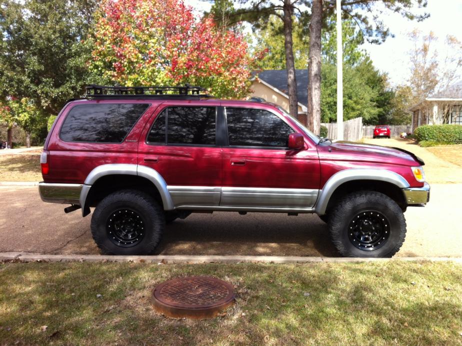

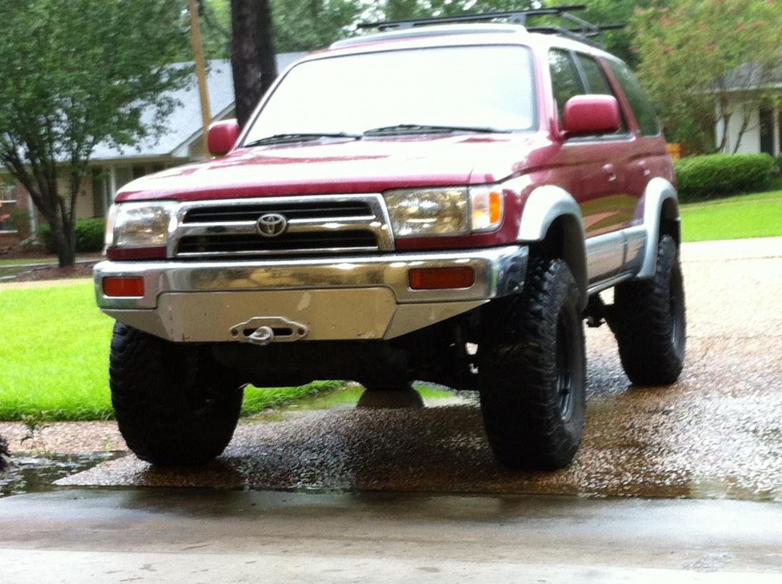

Bilstein.com, shows assembly on instruction page. The web instructions don't mention the L/R perch height difference. 2009 Had Steve at Sornoran assemble my first set for me for 3" lift he used 2nd & 3rd perch. First pic is 2-3 perch, second is 3-4 perch, compensate for winch and plate.
Perch 2&3 is 2.5-75" lift LCA adjustment was maxed out. 3&4 full 3" lift needed SPC UCA's to get alignment right.

You mentioned Tube bumper 60# depending on what you have. 01 fat lip bumper and associated parts I removed weighed 93# AOR plate 112#, skinny lip didn't weigh probably 40#. You won't notice 20# difference, 30# you will less weight is a plus.

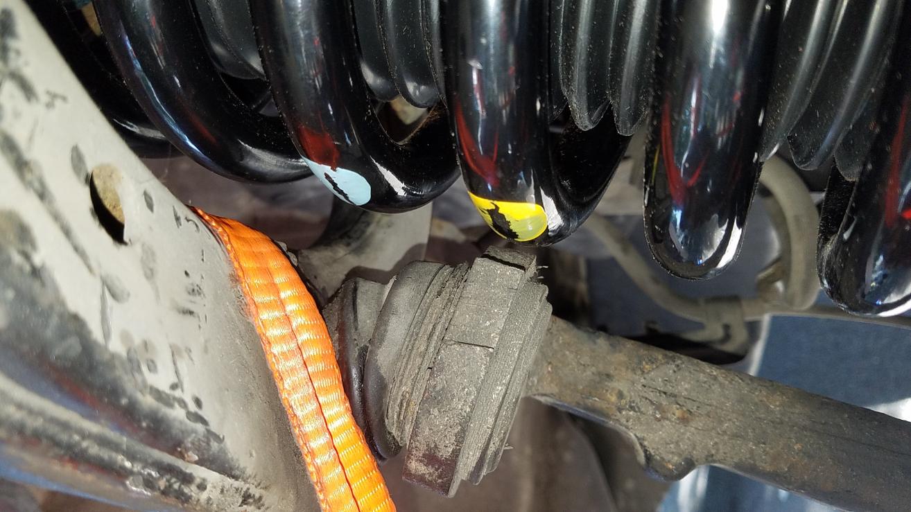

Well this certainly wouldve been nice to know - that the coils interfere with the UBJ knuckle.

3rd perch was definitely the answer for pairing with Dobinsons! Hell of a time getting them in there and had to grind away some of that knuckle for extra clearance, but she rides beautifully now!

You bet your ass I didn't! Just took a peak and my driver's side is fairly close, which would explain why it wasn't so severe on that side and worse on the passenger, but when I was out there working it still looked like if they compressed even a decent bit they would clang
Mind you this was just while installing everything - now that it's all said and done it sits a few inches away, easily. Really it was just to make life easier while trying to tickle the struts into place
