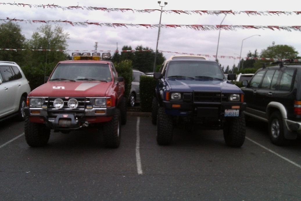

so a few questions, why do you want to run a 15x11 wheel that is such an oddball size, and if you are going to only be running a 12.5 tire, that will look funny on a 11 rim(thing stretched drift car tires). i am running 15x8s on my 85 pick up with a 33x12.5x15 tire. a couple of guys i know are running a 15x10 wheel and their tires almost have the stretched look, but its not bad cause they are running a 35" tire. but a 33 on a 10"+ wheel will be prone to losing the bead when aired down. also consider that most newer vehicles are coming with at least 16" and more and more are coming with 17s from the factory. the larger wheels are becoming more popular and thus tires are becoming cheaper for those size and more readily available. 15" tires can still be found, but not like they once where and only in select sizes. -i personally think the 15s will soon be weeded out except for a few select sizes ie 30, 31, 33, 35, 37s but only in a few styles, just the trend i see happening. if you are really set on running a 15" wheel then get a wheel spacer, and or find one with an offset that will push the wheel further out -the down side of this is the tire will not longer pivot on the hub/axis, but now swing in an arc causeing more stress and strain on your power steering system and possibly making it harder to steer off road in some situation. for what its worth you can find almost any size tire in a 17" that you could in a 15"(as far as off road tires are concerned) and more, as well as a greater variance in load rating. just my .02
below is a pic of my red 85 with the 33x12.50x15 on an 8" rim, and the blue truck is a friends 84 with 35x12.50x15 on a 10" rim just to give you a perspective on how rim width will affect how the tires look

Sound logic Sir. My current 285/75R16's convert to 32.8x11.2 so if I get 35x12.50R16's and throw em on my stock wheels (16x7) that's only adding 1/2" on both sides. Will that work? 12.50" on 7" sounds a little crazy. Maybe not?
There's nothing good on Craigslist right now for 16's or 17's but I'd like to go with a different wheel with more backspacing so I can ditch the 1.25" Spidertrax spacers up front. As you said, the further you space the wheel out more stress is applied to everything even bearings and ball joints take more abuse.
Just went out and measured the darn 15's again and the inner bead is actually 10" not 11".:roadkill:
16s are the wild card cause they are only a metric size, so if you want a 35" tire on a 16" wheel you will have to convert and it works out to be like a 315x70/75x16... but you still have to be careful what 16s you run with the tundra brakes, as some wont clear.
