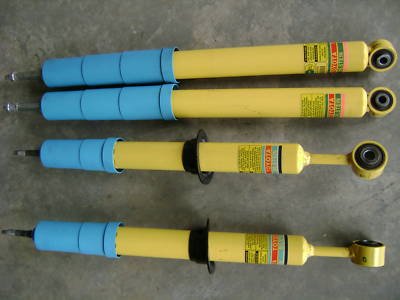

Hi. Does anyone have any more info or input on this? I'm going for the 3" OME ToyTech lift and while I'm at it, I'm going to be upgrading the shocks too. Does anyone know if the 08-10 Tundra TRD Bilstein shocks will work? They are Bilstein Part #'s 48510-OC030 Front, 48530-OC030 Rear.

if you are going to be getting the OME coils, the best thing to do would be get OME shocks. The valving and design is matched for the coils.

Thanks steezemcqueen. I'm trying to do this on the cheaps and i have a chance to get all 4 Tundra TRD Bilstein shocks for $85 and they only have 6k miles on 'em. Do you think they use the same bolt pattern? Will they fit on my 4Runner with larger coils? Any more info would be greatly appreciated. Thanks again.
crap. for some reason i thought these were 00-06. the 07 and up will not work.
steezemcqueen, thanks again for all your great advise and info. Much appreciated. I asked you the same question on another thread; Why wouldn't it work? Especially with some LC coils? Wouldn't the shocks give me more travel?

It's not really a question of if it will "work" or not, it's if it will be a good fit or something along those lines. I'm sure you COULD use it but it's most likely not recommended. Reasons being: The Tundra shocks are probably not long enough to compliment the travel of the LC coils, The valving is totally different because the Tundra is alot lighter in the rear than an SUV such as the LC or 4runner. The front shocks could possibly work, but I've never tried it or heard of anyone trying it. If you are willing to test the waters and give us a definite answer if they "work" or not that'll be awesome though! Good luck!!

Ok so i don't mean to be a downer or anything but i really don't think that the 07 up tundra shocks will work. The reason that the 00-06 tundra shocks work well in the 3rd gen is that they share a lot of the same parts and the front suspension is very similar in design. The 07 and up tundra is a different beast. the coils themselves are much bigger in diameter and the shocks are valved for a much heavier V8 and a truck frame. I am all for saving money but i think you would be better off putting that $80 towards shocks that you know work for your 3rd gen. Being a guinea pig for something is usually not the way to save money.
