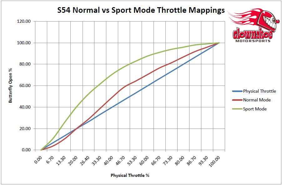

I don't have the product but I do have a motorcycle with different throttle modes and have experience in other cars with drive-by-wire throttles and drive modes which alter the throttle mapping. So I can speak to my experience.
At the end of the day everyone is right, Saker is right that a more aggressive throttle mapping can "trick" your brain into thinking the car has more power than it does. This can without question make the driving experience more enjoyable. My Aprilia is much more fun around town in "Sport" mode vs. "Touring" mode even though maximum power is the same. This is all due to a more aggressive throttle mapping, the ignition timing and fuel maps are the same on both settings.
The Engineer contingent is also right, you are not gaining any passing power, dyno power or outright performance increase. To some this may make the modification worthless but again I go back to the perceived effects. Your brain has been taught over the years that 25% pedal input results in 25% throttle, this is a holdover from the throttle cable days. When you alter that linear correlation and create a situation where 25% pedal may result in 35% throttle then of course the car feels faster. These effects, by nature, can only apply to part throttle driving. With your foot to the floor you are never going to get more that 100% throttle.
Here is an example chart of how these things work that I stole from the interweb.
