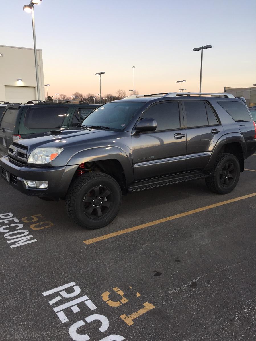

I just did a toytec 3 inch lift and am very satisfied with the results. It was around $1700 with new ucas. I bought the ultimate kit, but they have cheaper ones too that can be had for under 1000. I put a little taller rubber 265/70 on. At your miles you may check all your ball joints and links as they most likely will need to be replaced too.
