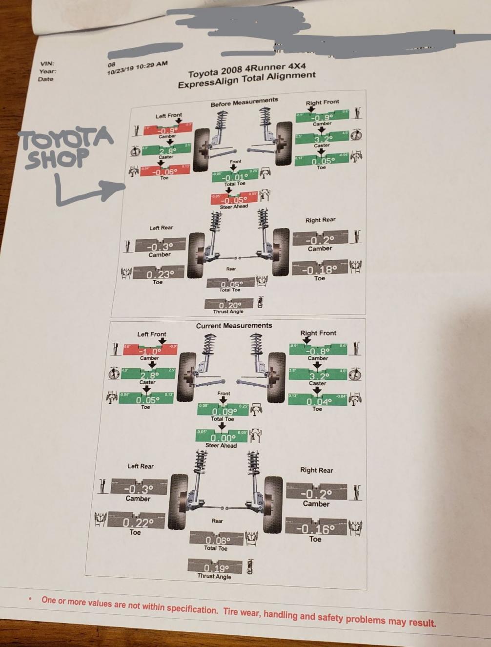

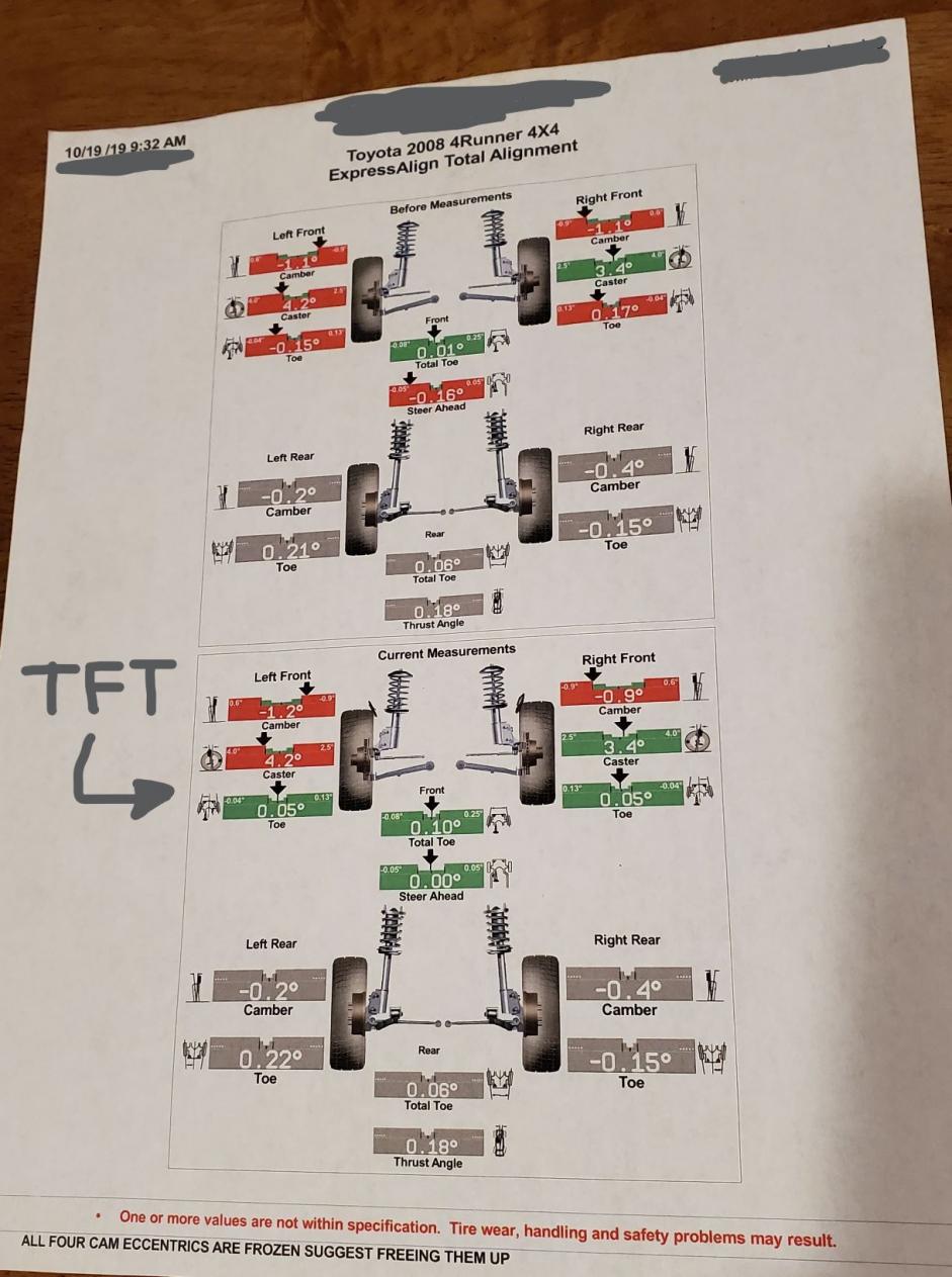

3 days ago, I purchased 4 new Falken Wildpeak AT3 tires for my 2008 4runner at Town Faire Tire. I had them mounted, balanced and had a 4 wheel alignment done (I don't know why they charge for a 4 wheel alignment when they can't adjust the rear...). When I went to pay, the guy at the desk told me that the results would show red as they could not do the camber adjustments due to the cam bolts being seized. They were able to do the rest of the alignment and provided me with the results (see below). He suggested I take it to a mechanic to have them remove the cam bolts and then bring it back and they would redo the alignment again for free. I left there a bit worried as I had just bought brand new tires and the alignment was off. 3 days later, I had an appointment at a local Toyota/Lexus specialist that I recently started going to, for a coolant flush and their 4x4 service (ie.transfer case fluids, chassis lube, etc.). While there, I decided to have them do a 4 wheel alignment to see if they would be able to get the cam bolts off and compare the results with TFT. They ended up telling me the same thing that TFT told me; the cam bolts were seized. The manager told me that even though the cam bolts were seized, he suggested leaving them as is and it won't be a problem because the camber for the left front was just a hair off at -1.0 and this would not affect the tires. After the service at the Toyota/Lexus specialist, when I got home, I compared the results between the two alignments. Based on the output of the reports, it appears that both places used the exact same alignment machine/software. BUT, what really struck me as unusual was how much difference there was between the results from when I left TFT (their "Current Measurements") vs. the results that the Toyota specialty shop got before they did their alignment (their "Before Measurements"). There were some MAJOR discrepencies. For example, TFT had the left front Caster RED at 4.2 and the left front Toe GREEN at 0.05. The Toyota shop had the left front Caster GREEN at 2.8 and the Toe RED at -0.06. What's going on here? I would expect these to be practically the same!

Adding Pictures of Town Fair Tire and Toyota Shop Alignment Results:
