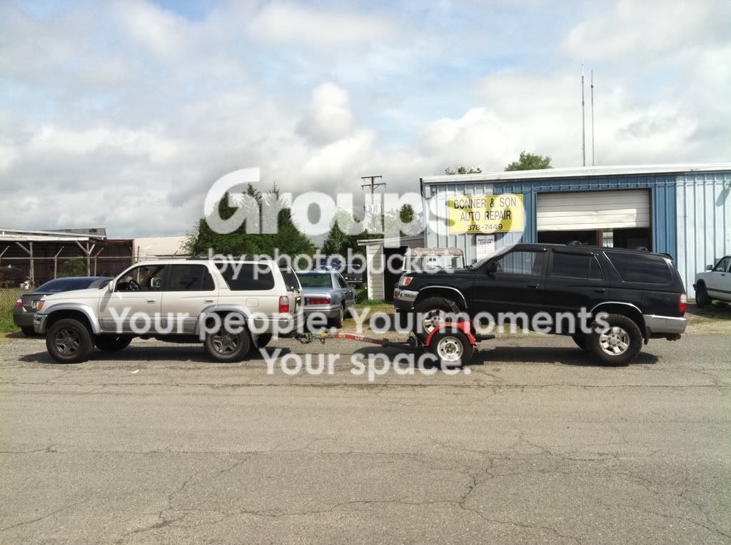

I bought this one from another forum member who had the top radiator hose blow off and got the engine real hot. He sold it to me with a cracked head.
Went down to Richmond, VA to pick it up this past Tuesday. I hooked the battery back up, hit the key, it started right up, idled well and was making plenty of power.
Drug it home on a U-Hual car dolly with one of my other 3rd Gens.

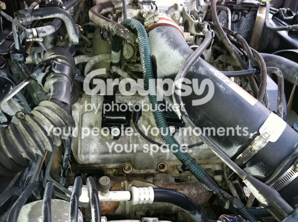

Got it home, re-installed the driveshaft (figured it was safest to drag it without it hooked up.) Backed it off the dolly, slapped a license plate on it and drove it around. It ran pretty good. Clutch master cylinder is weak, hopefully just needs a bleed, might need to be replaced. Drove it around some more, it started getting real hot, real fast. Pulled over, shut it off, and let it sit for about an hour. Fired it back up, drove it home and parked it.

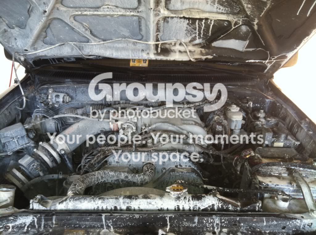

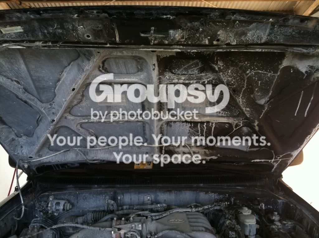

Next day, took it to the self serve car wash, cleaned up the mess from when the radiator hose blew off on the PO.
182265eb.jpg~original
84c58298.jpg~original
Used some Purple Power and a pressure washer.

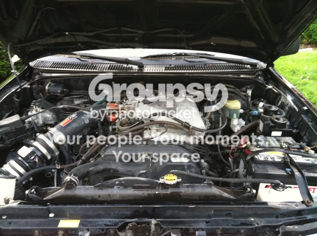

I does have a miss in it but there is a visible exhaust leak too. There's a nut missing where the Y pipe hooks into the cat pipe. It also has a check engine light which I'll have to go get read. But all in all, I think I got a solid little beast to start with here.
I'll say it was the K&N that did Tyrone in.
With those compression #'s, I'd wager to say that the rings are sticking or shot. Maybe try a high mileage oil such as Mobil Super and see what it does.
While HF has merit for some tools, the leak down tester is not one of them. I bought an OTC one from Pep Boys years ago on sale. A 24" wooden dowel works well to fit on top of the piston.
Looks good, even with three new coils.
No doubt it could use sme freshening up. But all in all it runs well and makes power. I really don't think it has a cracked head. I did just hook up a code reader to it, P0306, misfire on #6. Makes sense since it does have a miss. However, I just stopped at Toyota, bought a nut for the exhaust and cranked it on there. I'll have to run it around for a while to get it hot again and see if it runs any better with the exhaust leak torqued down.

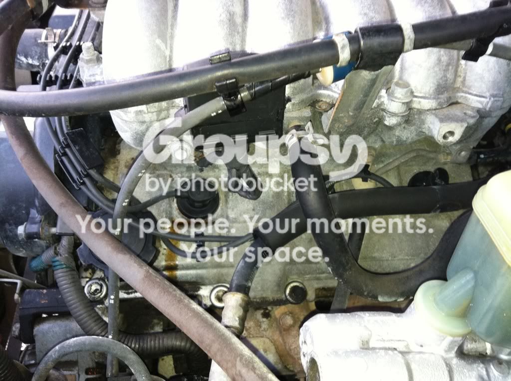

Anyway, OP, it looks like there is some oil seeping out from under the number 2 cylinder spark plug boot. The o-rings in the valve cover that seal against the spark plug tubes, can sometimes leak. If they leak enough to fill the sparkplug tube with oil, a misfire can result.
I'd pull all of the coils and plug boots to check for oil filling the sparkplug tubes. Then replace the o-rings if any is found.
In fact I'd replace all of the spark plugs anyway. Considering that the cooling system was seriously neglected, I wouldn't be surprised if the spark plugs are well past due to be replaced.
Good eyes 02SE. They are leaking and a coupe of the plugs were wet with oil when I pulled them to test the motor. When I get the time I'm going to pull the valve covers and do the gaskets and the spark plug tube gaskets at the same time. But I do think that is exactly the cause of the miss.
