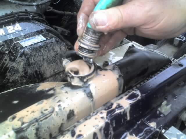

Hmmm. Well the instructions said that if I wanted to bypass the radiator all together I should get a bigger trans cooler. The one I have is rated for 2500 lbs towing and is maybe 7 in by 11 in in size. Is that big enough to properly cool the trans fluid? What is the pink milkshake anyways?
This
Don't look like fun, does it. That ain't even the bad part, the tranny is.Here is the thread
