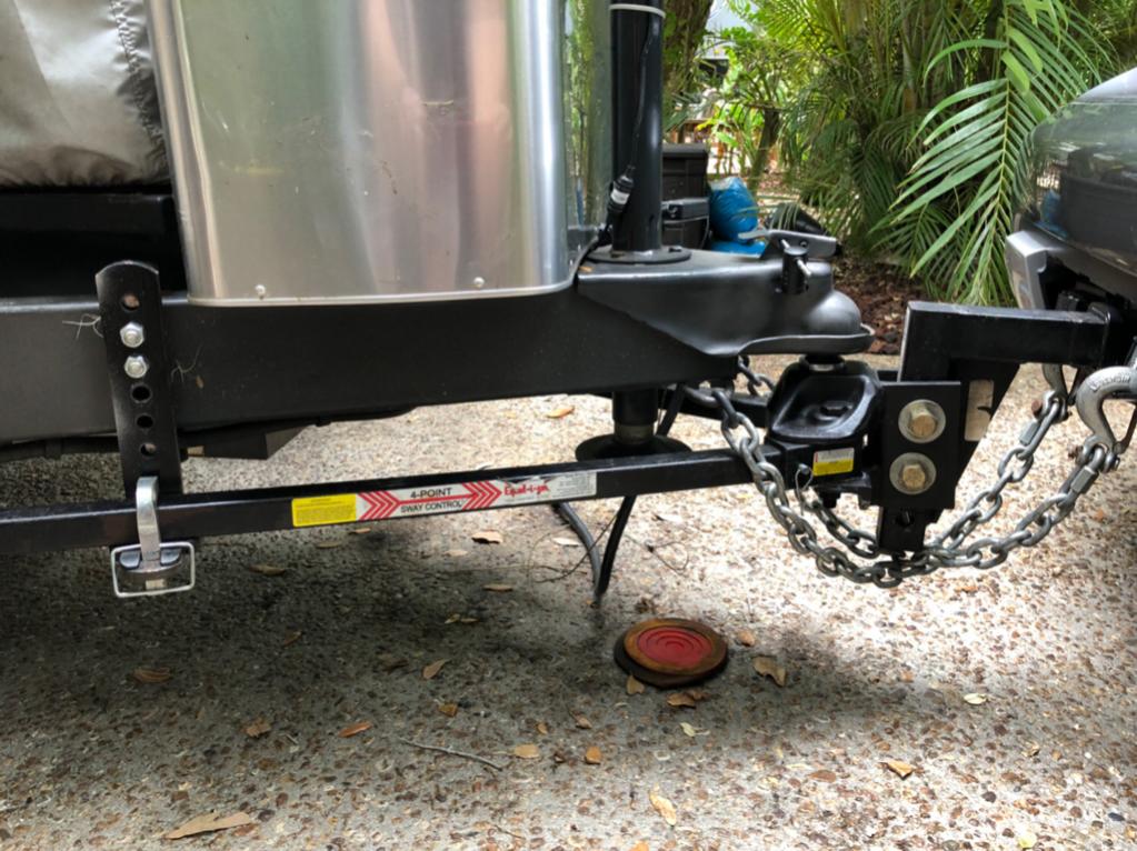

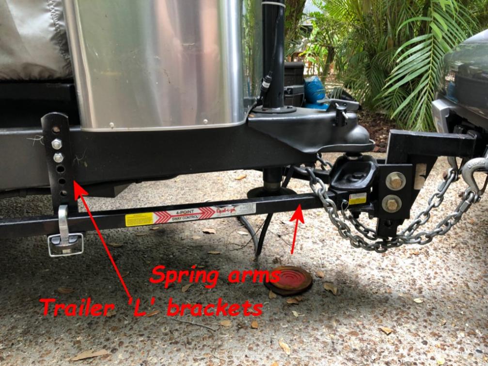

The stock receiver for the tow package is a frame hitch, not WDH. A WDH hitch will have spring arms (steel bars) going from the hitch back to brackets on the trailer.

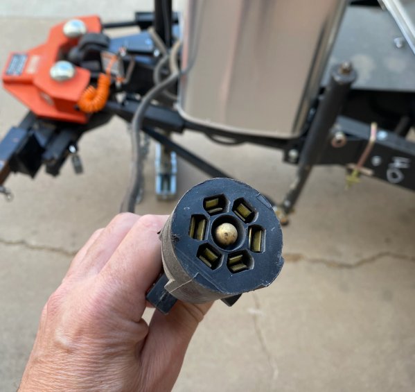

The trailer will have (most likely, especially if it's electric brakes) a round 7-pin umbilical cord that plugs into the 4Runner's connector, under the left side body just in front of the bumper.
