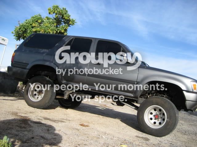

Here's a pic of my runner in its current state.
IMG_1029.jpg~original
Needs a lot of little work mostly body type mechanics, but surprisingly the motor runs well with no burning oil or leaks.
