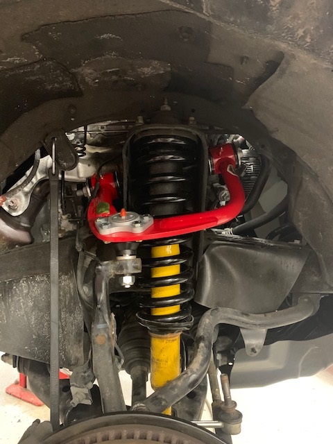

I have the same lift on my truck that you are getting ready to put on. I have the JBA arms and am very happy with them.

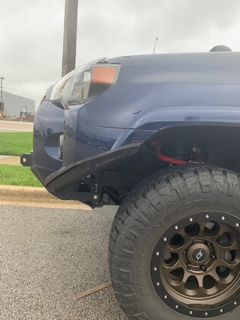

Thanks guys. I remeber seeing pictures of some builds with the tires really close to the UCA. I am planning on going with SCS Ray 10 wheels and 285/70's or 295/70's. I forgot which thread it's in but I saw the pictures a few times of people and I am unsure if that is a issue while offroading.
I'm also running the SCS Ray 10 with a 285/70 tire. No issues
