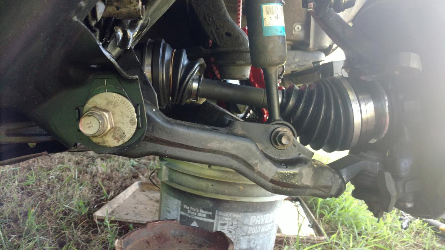

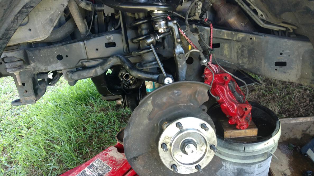

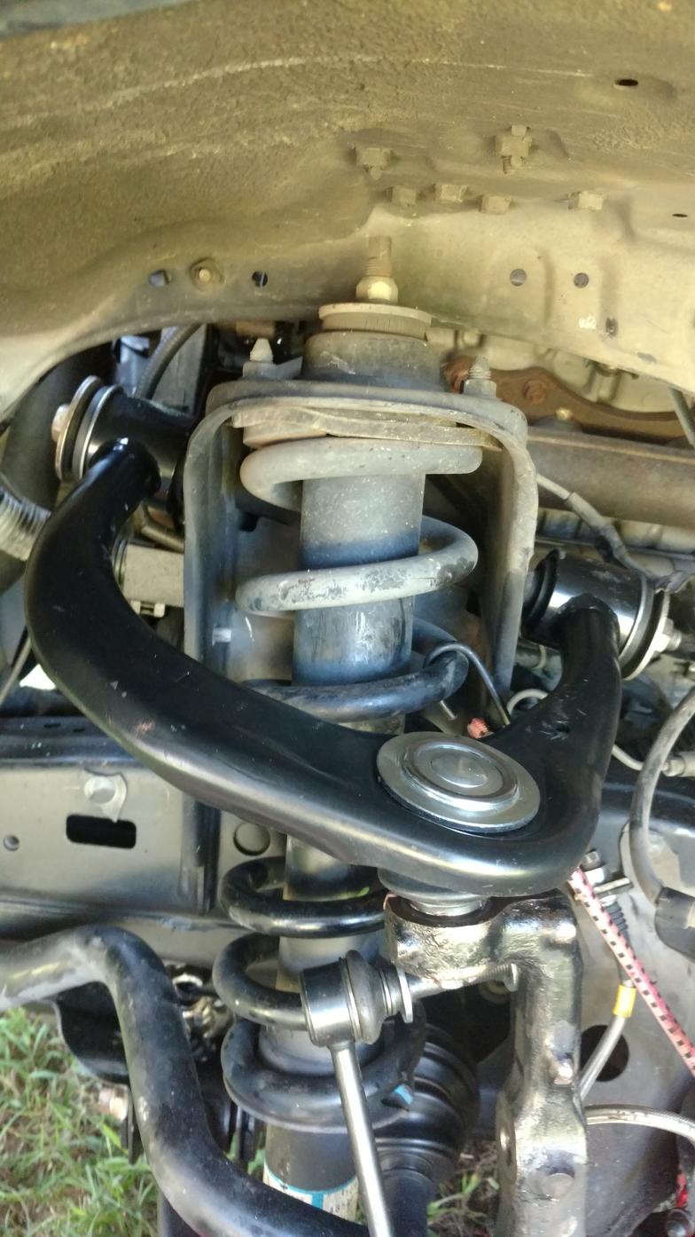

I was in wreck a while back where the front driver side corner and especially that wheel took the brunt of the impact. I had it towed home, and in assessing the damage discovered that a wheel could not be mounted due to negative camber, and the top of the control arm being low enough that the inside sidewall of the tire bumps into it. I didn't think the impact had been hard enough to cause frame damage so figured I'd replace stuff that was worn out or suspect and see where it got me. I also have a replacement steering rack I haven't gotten to, as the wheel got hit hard enough that it ripped a tie rod end out.
Having replaced the UCA, cv axle, hub/bearing assembly, and sway bar link, stuff still isn't lining up. There needs to be more space between the UCA and the hub. Anyone have any suggestions before I throw in the towel?

That said, the shock tower might be bent and you may just not see it. That would be a big culprit of your negative camber. The steering knuckle may also be bent as well causing issues. This is also known to bend/fail during hard wheeling thus the gusset kits some install. I'd look into that as well.

Sounds to me like the steering spindle (the part that sits vertically between the two ball joints and holds the brake rotor and wheel) is bent. That part is what really controls the distance between the UCA and the tire. If only the UCA or frame was bent, your camber would be all out of whack but the wheel to UCA distance wouldn't change.
If the top of the wheel got smacked hard from the outside, I could see the upper part of the spindle bending to give you the results you're seeing. Since that's an odd-shaped part, it's going to be hard to put a straightedge anywhere on it to determine its health, but it should be a mirror image of the one on the passenger side. Try putting a straightedge on the brake rotor or wheel flange extending vertically up, and measure horizontally from there to the UBJ attach point. Compare that measurement to the same thing on the passenger side.

Finally got around to comparing the passenger and driver side spindles by measuring the distance between various points on them. The driver side (wrecked) spindle had distances as different as much 1.5" shorter than the passenger side, so probably safe to say that's my problem. I ordered an oem used one off a non-wrecked parts vehicle.
