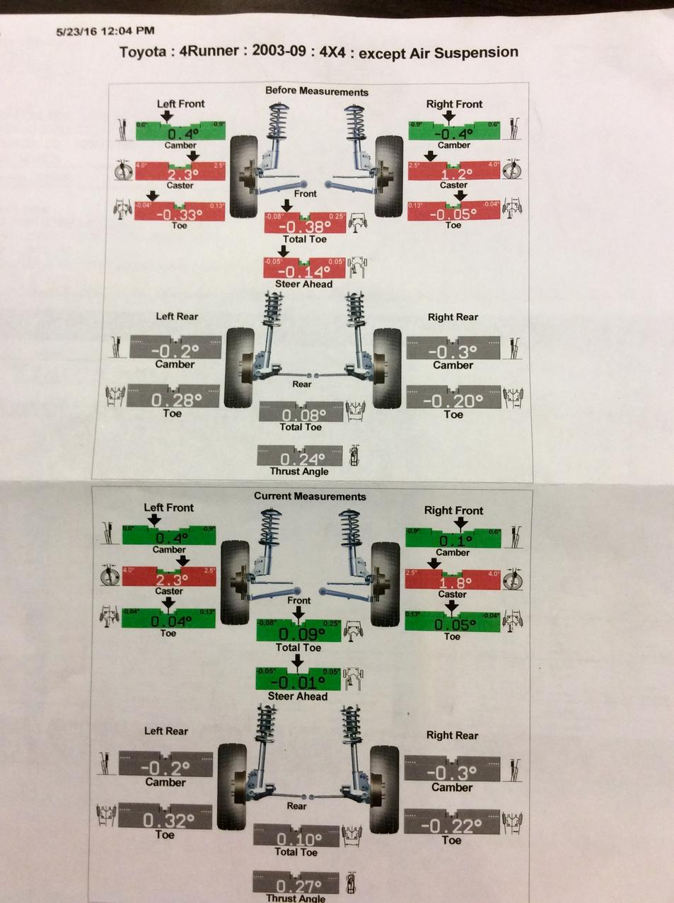

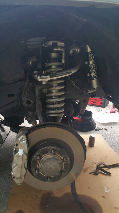

[MENTION=87036]YotaDan[/MENTION] from Wheelers Off-Road was awesome me to work with and Camburg UCA shipped quickly and install took a little under 3 Hours. I didn't get the full 2 Degrees I was hoping for, but the drive is fantastic so far. Heading out for a camping trip tomorrow so I'll share a final report later. Below is the final alignment #'s post Camburg BJ UCA install. Before install the caster was at .5 and this number came from a different alignment shop. Long story short, I'm super stoked and very happy with the upgrade!!! Firestone suggested driving for a while and doing the alignment again after things settled in a bit.

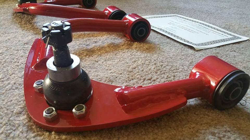

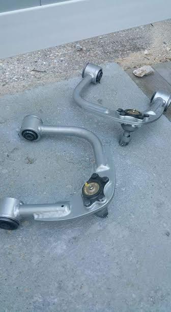

I went with the JBA UCA's and couldnt be happier. aligned right into spec and seem to be a very high quality product. I wasnt a big fan of the red so I painted right over them with Silver caliper paint.
Bolts in nice and easy.. the idea of easy change and greasable ball joint is a very nice feature. I would recommend it.

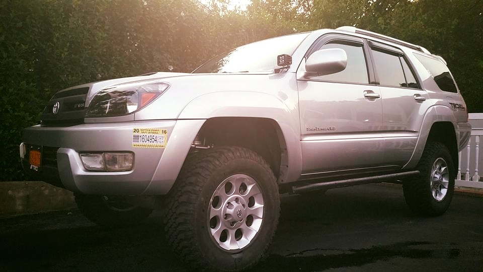

few thousand miles and major temp changes, a few road trips and light offroading so far.. JBA's still looks and feel like the day I put them in.. no complaints. Looking forward to stretching them out in the spring on a offroad trip somewhere.
