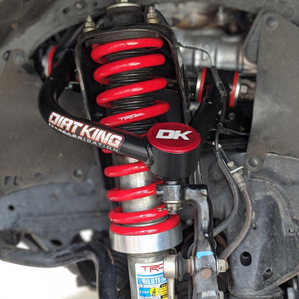

I'm running DK upper arms. Very good quality product. Definitely worth the money. I think you get more quality than what you pay for. It's the little things like how they use aluminum dust caps for their ball joints, and how it's held in place with a rubber O-ring as compared to some other more expensive arms that use double stick tape.
So far I've had no problem with squeeking, but only put about 700miles so far on them. I'm using the DK recommended Prothane Super Grease for the body mount bushings. It's definitely more expensive (about $45 for a 14oz tube) but from what I read, it lasts the longest without having to reapply, and a 14oz tube should last a really long time

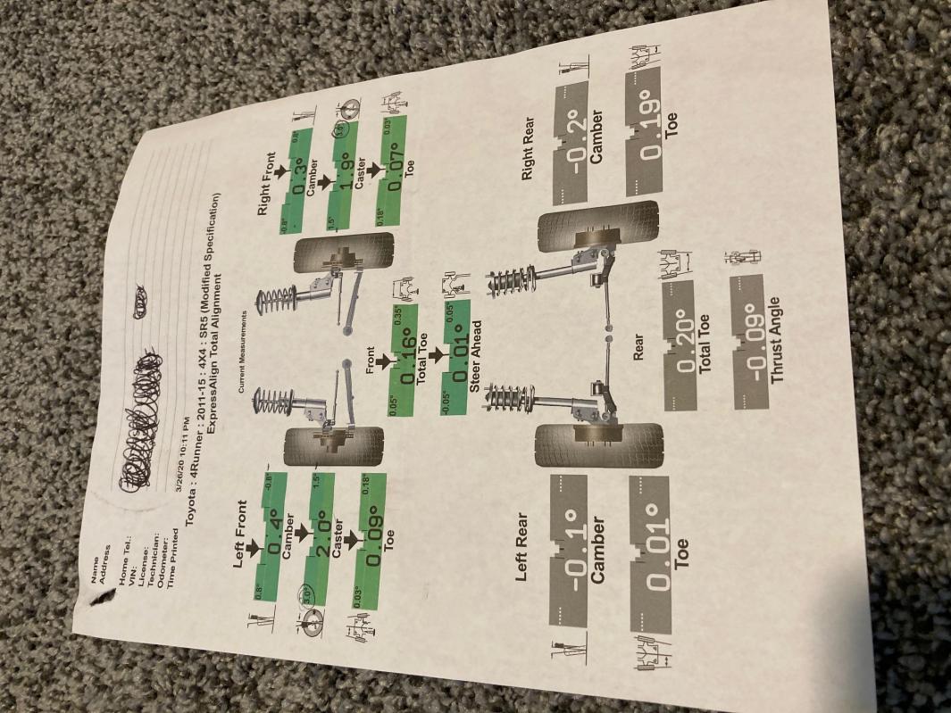

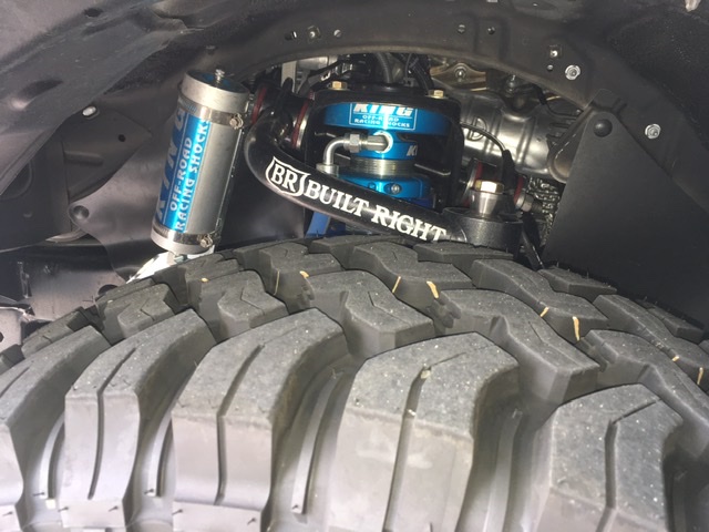

Thanks for the feedback and pic, they definitely look like they belong there. So the DK's will make the alignment tech happy? My last alignment on stock UCA's FWIW.
