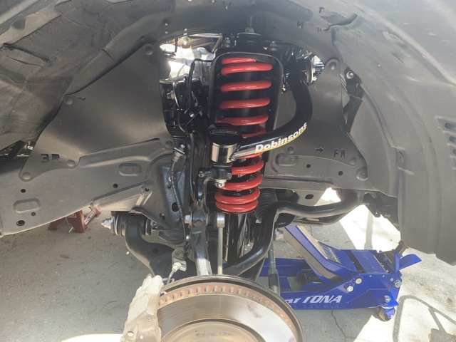

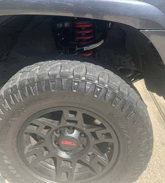

I’m running Dobinsons UCA with Stock TRD PRO rims. Still stock 265/70-17 duratracs for now. Going to run Cooper AT3 or ST MAXX soon. Choice the Dobinsons because they are maint free and are tough. They look great and I wanted an UCA that was same building as my lift.

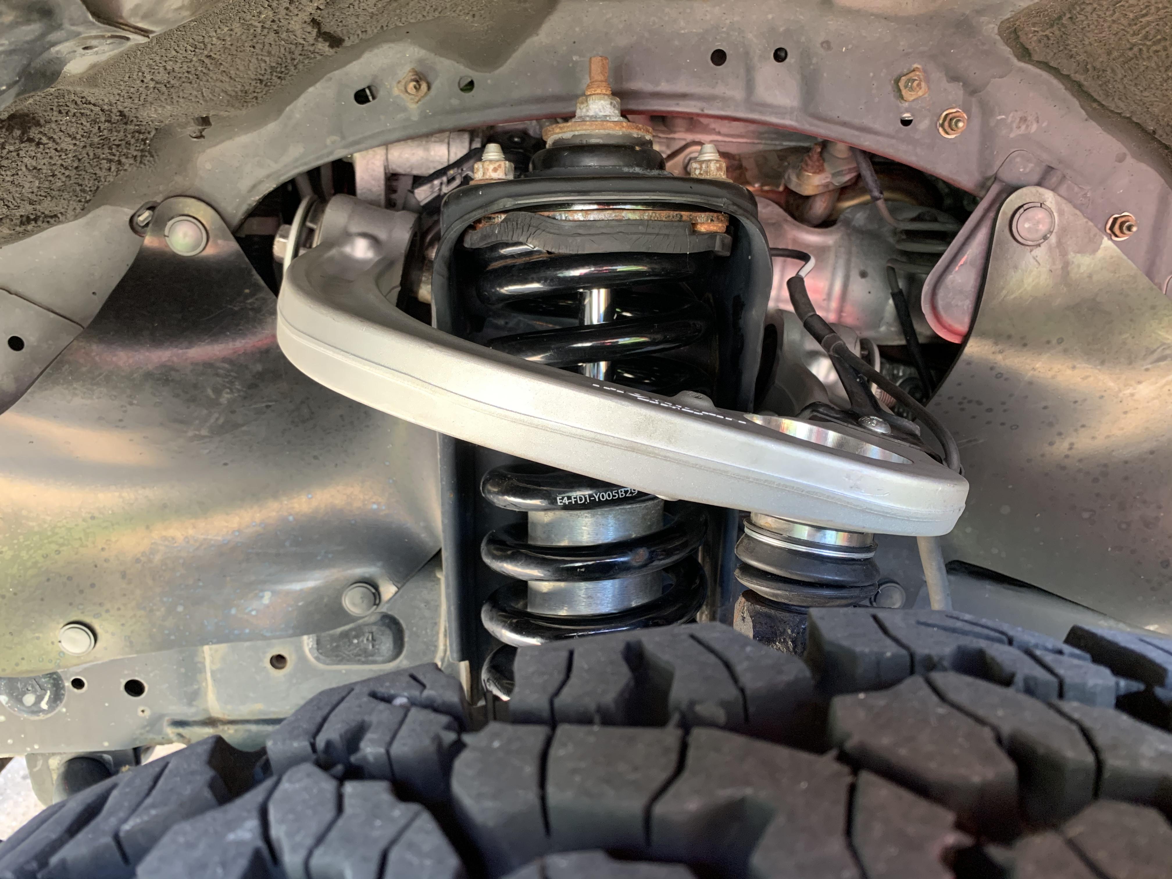

The Ironman pro forge UCA is a great option. Really impressed by them. I ran SPC on my Tacoma, never was impressed with them. I’m running about 2.25” front lift and achieved 4.7 degrees of caster.
I have always like the DK option but these Ironman UCA looks so nice. All one piece forged aluminum is a step above most tubular options in my opinion. Do you know exactly what ball joint they put in these (part number)?
I think the JBA's appeal to a lot of people because the price is good, but they really do need to add some inner and outer clearance where their ball joint mounts. I've seen lots of 4Runner and Tacoma guys have clearance problems between the arm and the bigger/thicker/wider coils from Dobinsons on the struts.
I've seen those Ironman forged UCA's crack right by the ball joint. It must have been a once time thing as I haven't seen anyone else report issues with them.
