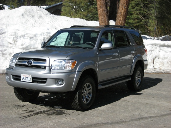

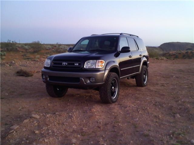

So the thing about the sequoia is the gas mileage sucks, it has the same suspension as the 4runner just spaced wider, and its huge. the 100 series is big too, but not quite as big, it has basically the best oem ifs suspension you can get and an excellent 4 link rear end. The ride is excellent and they are typically lifted about 2" if needed.
Also if you are just dding, get a body lift.
btw the secret to happiness is solid axles.
Actually, as Ed mentioned below the Sequoia shares suspension with the Tundra. As the 3rd gen 4runner is basically the same vehicle as the early Tacoma, so the 1st gen Sequoia and Tundra are basically the same. The Tundra has rear leafs while the Sequoia has coils. But you do basically all the same lifts on the Sequoia as Tundra. Sequoia has 4 link rear suspension as well. Im not concerned with gas mileage as I am planning on doing what Absolom does, use a car for daily commuting driving. Then save the sequoia for weekend trips.
As far as the 100 series, very little difference in size with the 1st gen Sequoia. I know theyre really nice vehicles but Im not crazy about the 100 series style. I love the 80 series though. But the 100 LC of the same years im looking at (05 and 06) are way more expensive than the Sequoia.
If you mean same as in parts interchangeability/compatibility, it shares the some front suspension as Tundras,not 4Runners.
This. Same suspension other than rear leafs on the Tundra, coils and panhard on Sequoia. 05 and later Sequoias got an adjustable air suspension, which is cool until it breaks!

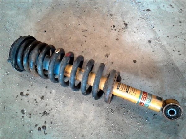

These are on ebay right now, from a 2000 Tacoma. You can clearly see the top section has tighter winds, indicating is a softer coil. I dont know what else that would be if its not progressive. Now if I could just track down where to get a new set of these!
Camelback Toyota for new springs.
Yeah I was on their website a few nights ago looking. I just don't know which coil I'm looking for. None of them specify progressive. And the listing from the set on eBay doesn't give a proper part number. I'm hoping nissanh can help me track down a part # as he's running the coils right now. He claims they sit the same height as 99 coils but ride much nicer
you can tell its progressive if the coil changes diameter. obviously a thicker gauge of wire is stiffer. however a wider coil wrap is actually softer, because the width of the coil is what gives it its leverage. another thing, if the distance between the wraps changes, that makes it progressive as well. if the gaugr of wire changes that as well will make it progressive.
anyways you probably cant tell on camelback's website, but if you can find pictures of the coils you want, you can tell if they are progressive.
