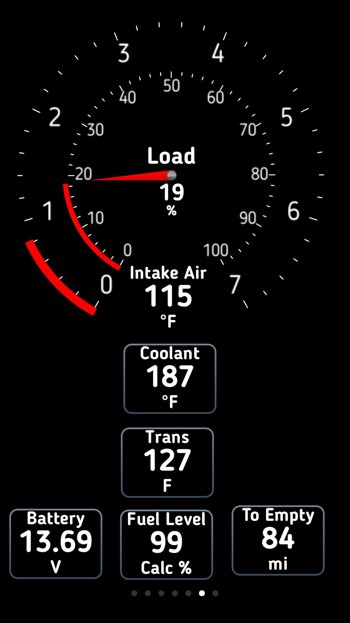

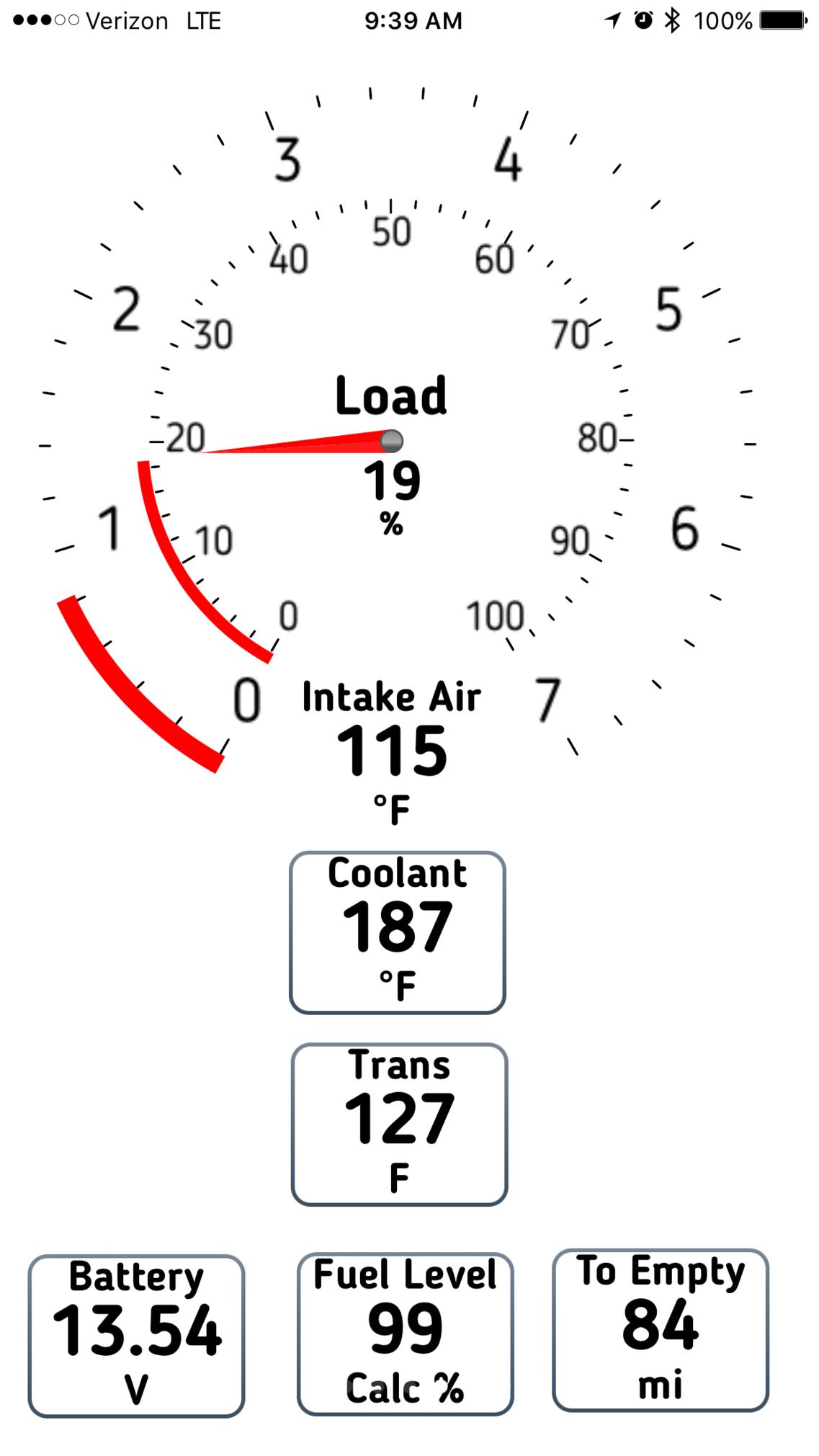

Hey Guys I have great news!
Last week I went ahead and purchased the Ultragauge Blue and downloaded the ultragauge app on my Iphone. I was talking with tech support for about a month before buying the ultragauge blue. They were not much help when it came to getting a PIDs for transmission temp for the 3rd gen 4runner. I know that people with the scangauge are able to get transmission temp using this PID.
Transmission Temperature F
TXD: 686AF101B4
RXF: 044105B40000
RXD: 2808
MTH: 00090005FFD8
NAM: TFT
Well I'm happy to say that the ultragauge app is able to read Xgauge. I was able to create a custom gauge with the data above.
I hope this helps anyone looking at getting the ultragauge set up. I was told buy tech support that what ever I can do on my ultragauge blue I can do the same to the Ultragauge MX. I think the MX is harder to program vs the blue.
I bypassed the radiator and have the B&M 70268 trans cooler.
Thanks
Luke
